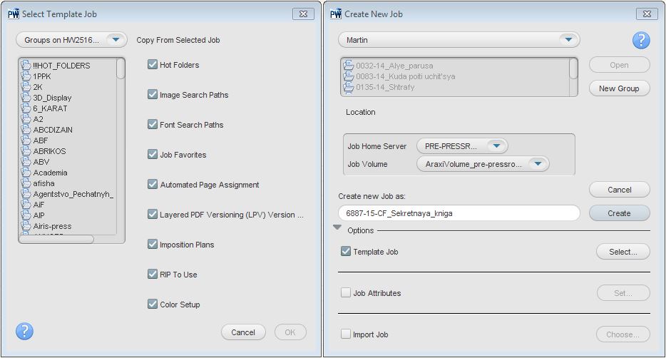

You mean this template selection?

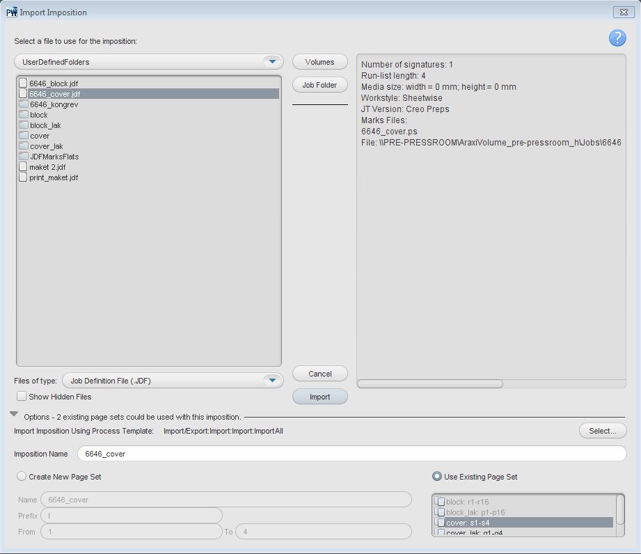

Could you please search in your prinergy 6: is there something like this dialog
