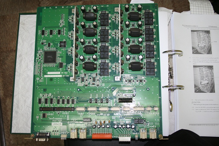

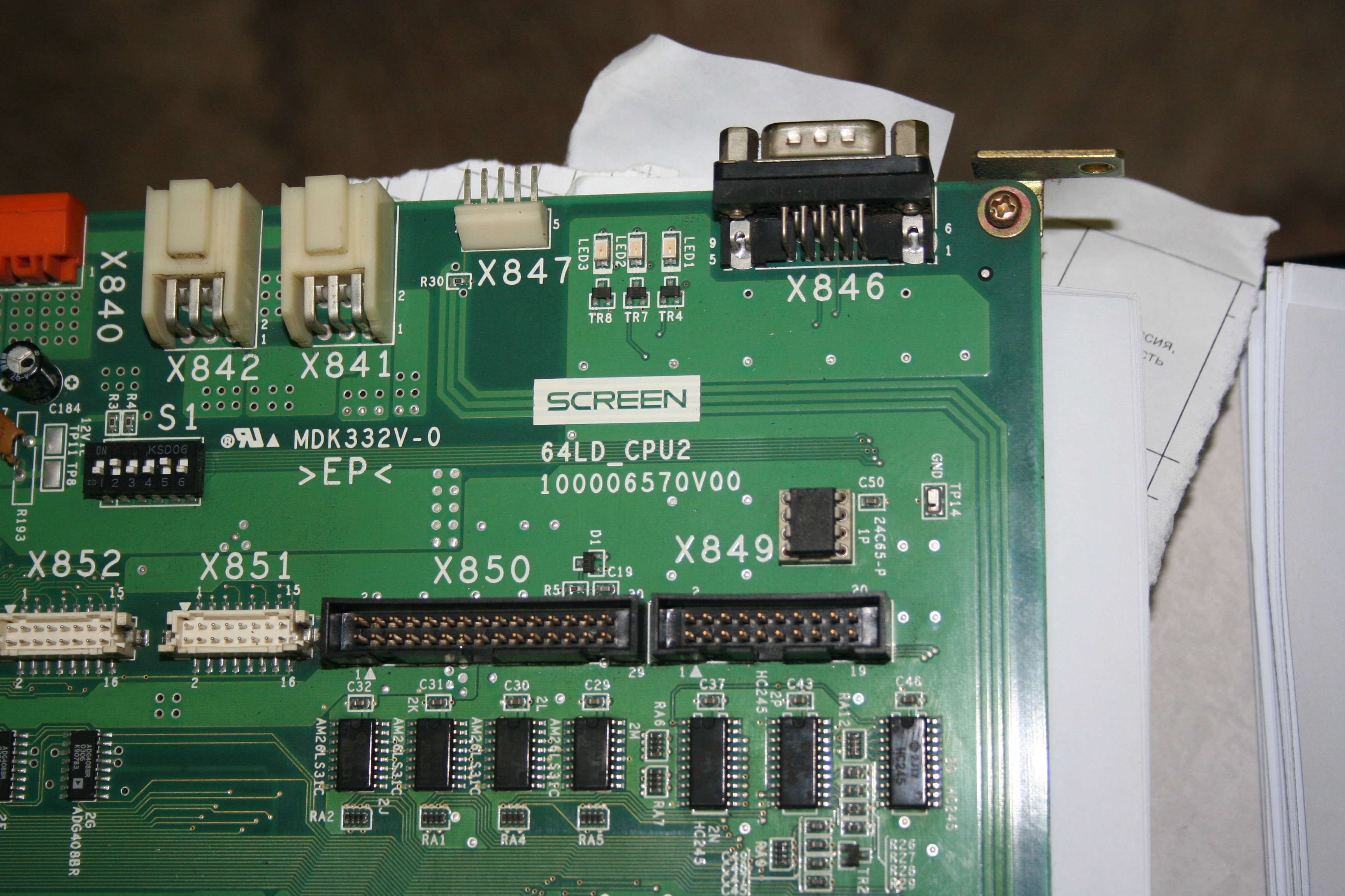

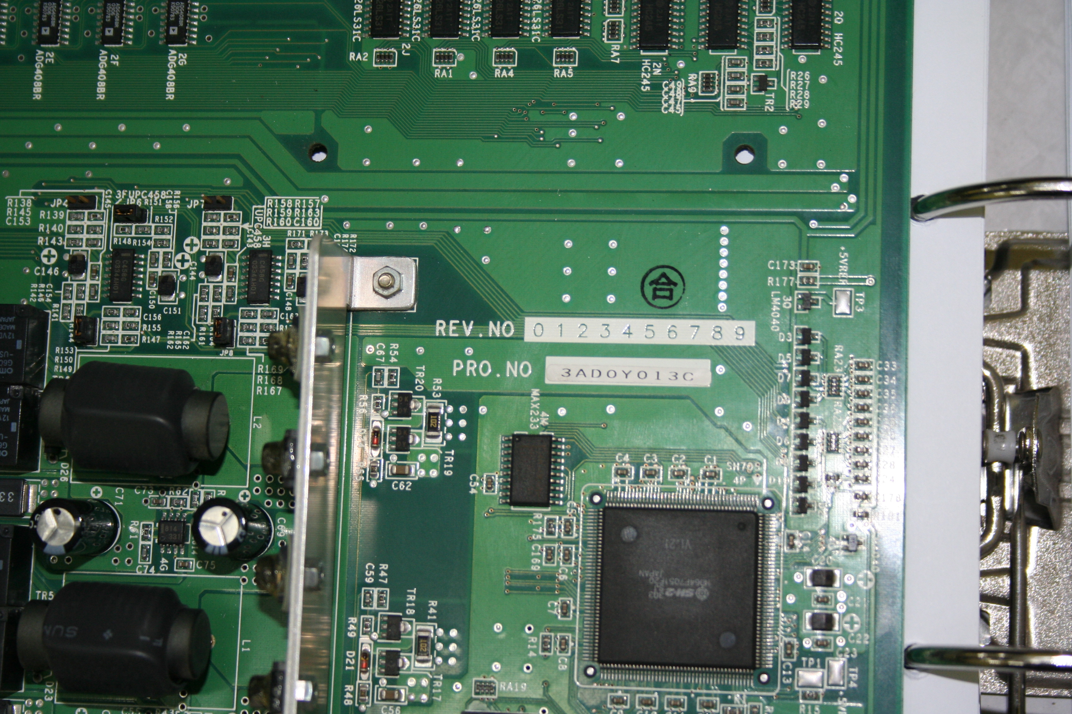

Hello, Tony!
We have Fuji T9000 (PT-R8600) and one electric board doesn't work, it doesn't make any response, no any information from it. All the parameters show "0" (null).
Seems the software is cracked.. We suppose maybe we will need these files to download the software:
1) 64chwrite.exe
2) 64ch_v203.MOT
3) 64ch_v121.MOT
How can we diagnose the board?
Or where we can get these files to download?
Will be very thankful to receive any comments and help on this problem.
P.S: I have attached the board photo
my e-mail is: [email protected]
skype: ha-pooh
