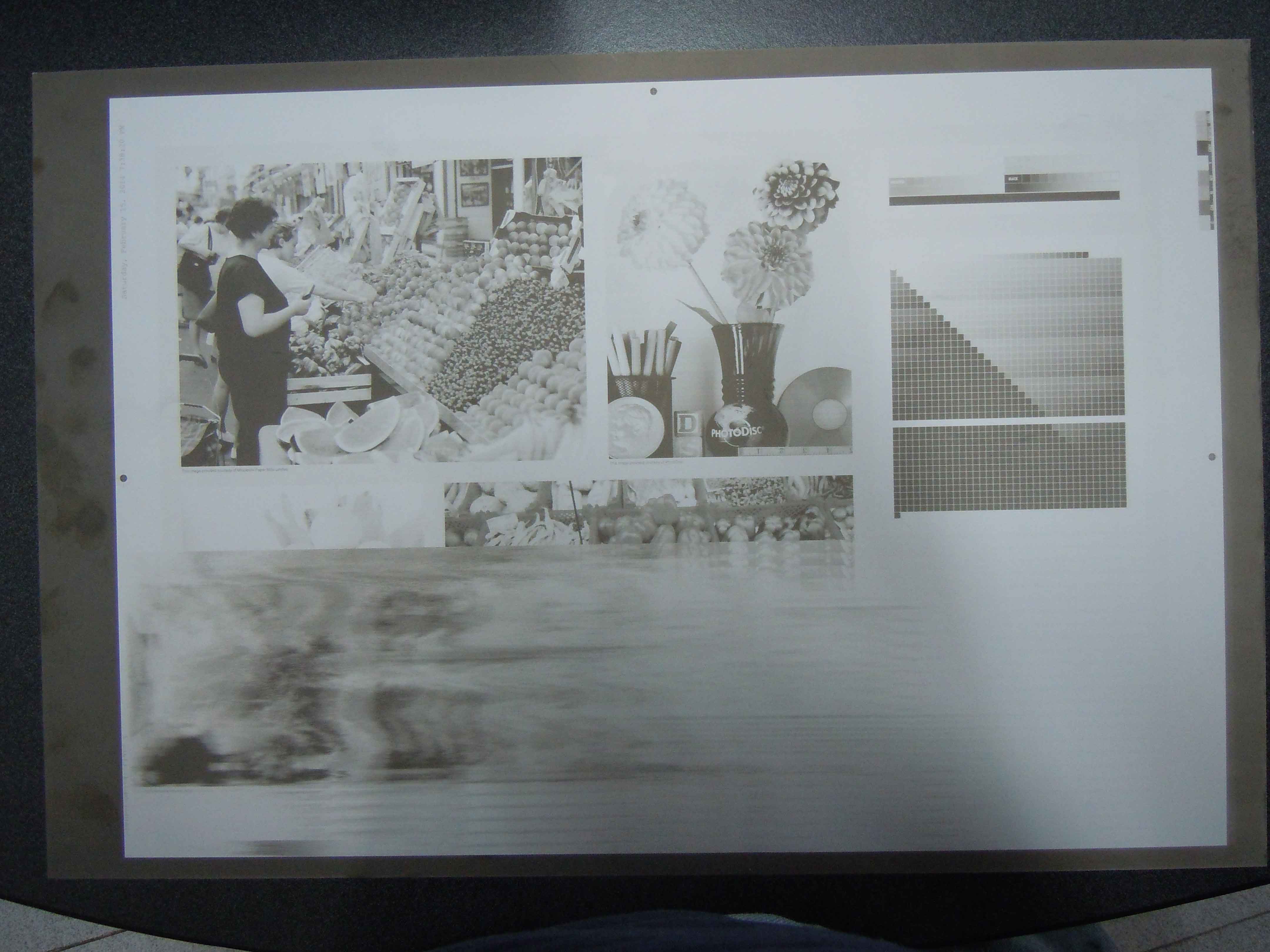

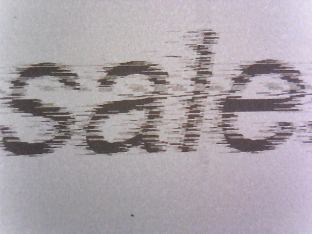

Hi everybody, I have a problem with a Heidelberg Prosetter 52, the dot is distorted and suddenly lose the "synchrony" only in the data area, and the image is blur and the plate of course is unusable. The equipment never send any error message.

Dear Raymond Ramirez; thank you for your response, let me tell you all the picture, in the morning I need to re-initialize at least 10 times, every intent sow the error 3229, "the high-water sensor is still active, after water blow-off", thereafter the CTP pass all the autoboot system until reach DONE, the machine is ready to work. Ok?, however all the plates has the same effect, the dot is like blurred or distorted, and the plate is unusable. On the Heidelberg diagnostic menu show 2 errors, the first one is about the LVDS card, does not pass the test. Is you see the image plate, you can see that only the image dots are distorted, the margin between exposed and unexposed is right. I think, is probable that the problem is on this board or with interface blue box from Xitron, but I do not know how to send a exposure direct from diagnostic menu or from hyperterminal conection. The second error is about the test water detect, neither pass the test. So I am confused, if the original problem on the air unit generate the problem or the LVDS card. The test about optic unit and mirror always pass correct.I appreciate your help. Thanks again.

Dear friends, thanks for your adivices specially to, maxon, Ritchiec, and Raymond Ramirez. Well I want to let you know what was the solution for this problem. The LVDS interface card was damage, but I did al least 50 times the diagnostic from the Hiedelberg software, and always it reported green ligth, that means the card is in good condition. We replaced the board and now the system is working. good day
