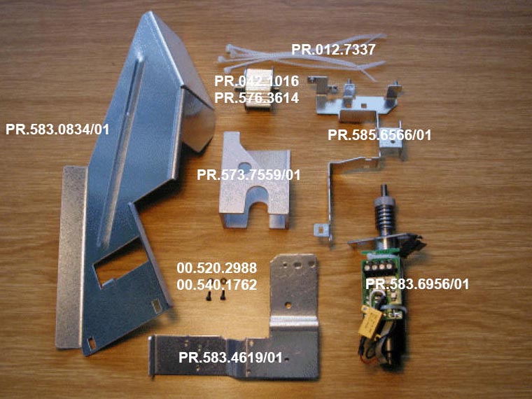

I had this problem 3 times - every year.
We had to replace gripper motor unit.
Maybe in your case you need just to replace optoswitch.

What's the optoswitch?
