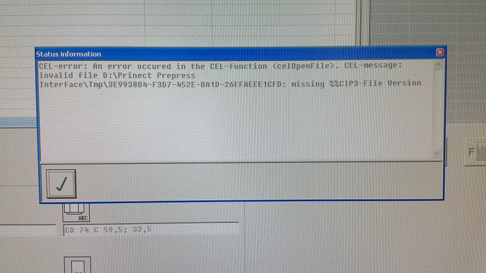

we have a 2006 cd74-8 and prepressinterface, and brisque and inkpro.
We cant get the cip3 file to work. we can generate cip3 and send it to interface but then it stop with error ( see picture).
how do we fix this, we cant get it to work, interface see the file but ther are red stop sign.
we have no knowledge on setup the press in inkpro, maybe there are som wrong there, what i can see the press is set to 4 color but we have a 8 color.
any suggestion????

It seems like PPI needs the version of the CIP3 file submitted... you probably have to configure that in the application that is generating the CIP3 file.
