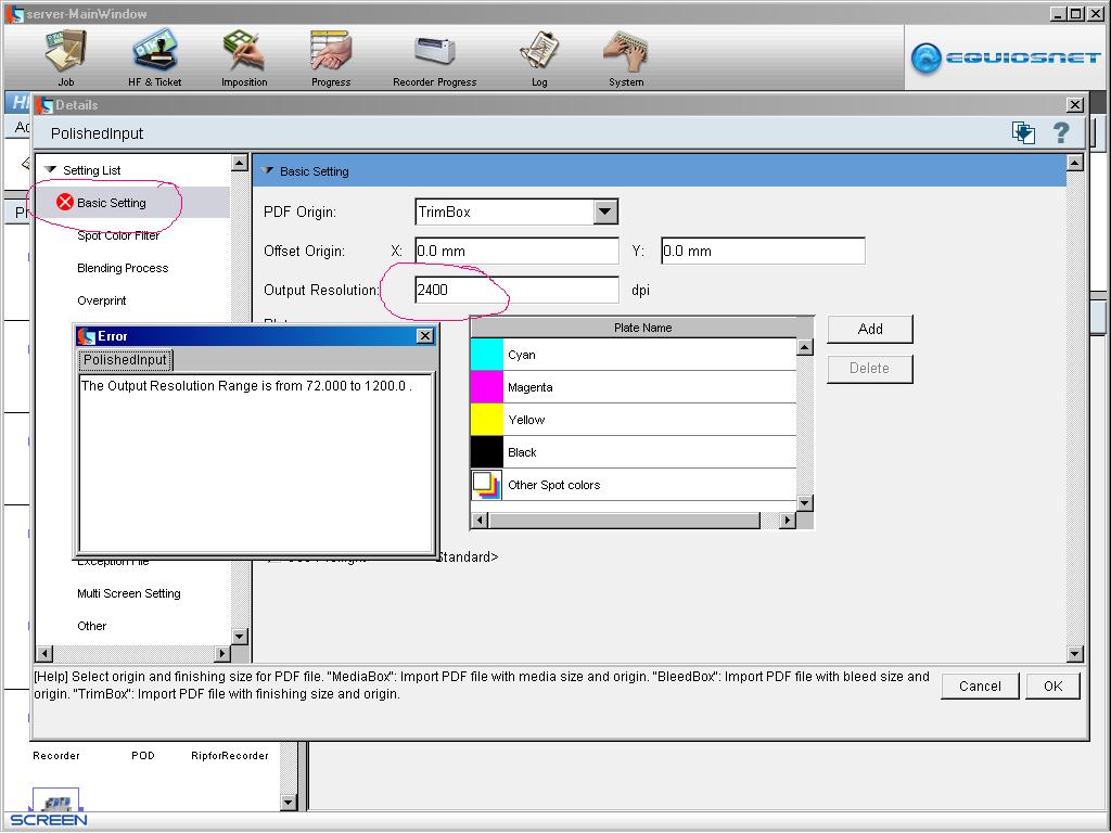

We have Trueflow 6 and we are unable to change the output resolution to 2400. We get an error saying the output resolution can be 72 to 1200 dpi.
Can anyone Help!!!

Sorry I dont think I explained the problem correctly.
We need to set the output resolution to 2400 DPI in the Polished input module but the Trueflow will not allow it to be more than 1200 dpi. I have attached a screen shot - hope that explains.
The Trueflow Manual says:
"Output Resolution Allows you to enter the final output recorder resolution, from 72 dpi to 4,000 dpi
using a number up to 2 decimal places. If you selected a SPM in recorder output,
enter that output resolution. "
Guess that means that something starnge has been set up in the installation to change this. But in any case this is not the output resolution from Trueflow but from the software that made the PDF File and is used to give a weight to things like Hairline where the Hairline was created in software specifying the weight to be n x output resolution, as far as I know.
Hello,
We formatted the computer - reinstalled the software on the computer and the problem got sorted out - not sure what the problem was but it got taken care. The new problem is that we have lost all the calibration curves - can someone explain briefly the procedure of making the curve how they have to be applied.
