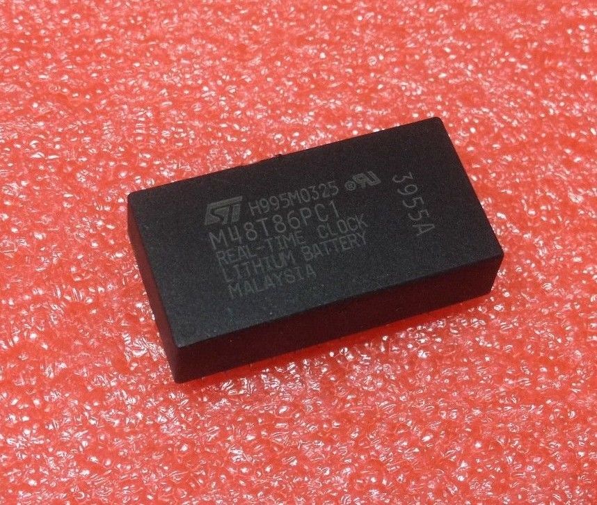

We have a problem with our UV-Setter 57 and hope you can help us: the RTC that goes in the Head-PC has lost it's charge and is not working anymore. It's model is M48T86PC1 and it looks like this:
We already found and bought this piece, but now we need the data that goes in it's EEPROM – it's a ".BIN" file extension, especific for the UV-Setter 57. We already tried with a file from a different model machine but it didn't work, and we can not find anyone else with an UV-Setter model 57 to copy it's EEPROM and send us the file.

Dear Felipe,
There is no need for that operation.
Please connect a keyboard to the Head PC computer (remove some covers first) and then turn on the lamp.
You will need a plate, some sun glasses, a magnifying glass and patience.
As soon as your Head PC has power it will try to boot up, i.e. will make a short beep, test memory, and then try to boot from HDD. The latest will not working because due to resetting the BIOS, the Head PC has forgot to boot from LAN.
In order to reestablish the working state of your CTP you have to change back the booting order to LAN first, and then all problems are solved :)

We didn't find the replacement chips so we cut with a saw the chip and connect an external 3V Lithium battery with two wires respecting the polarity. Then we seal everything with a resin and put back the old chip.
