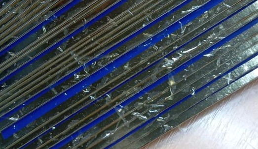

Has anyone encountered the problem of UV varnish adhesion on hot foil?
What happened:
1. Printing was done on cellulose cardboard with oxidizing paints with a water primer.
2. Then hot stamping with gold foil was done
3. Then UV varnishing was done
The defect appeared almost immediately.
No material substitutions were made for this order
The order is repeated, in previous editions the defect appeared from strong mechanical impact, but this time the varnish peels off from the slightest deformation and scratching. It peels off like a cracked film.
What could have gone wrong?

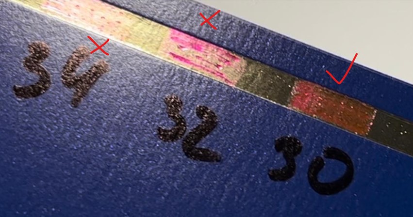

But when I checked the quality of the surface tension of the material (foil), the markers showed the presence of 30 Dyne.
As far as I understand, there should be at least 38 Dyne?
Tomorrow I will test this hypothesis.

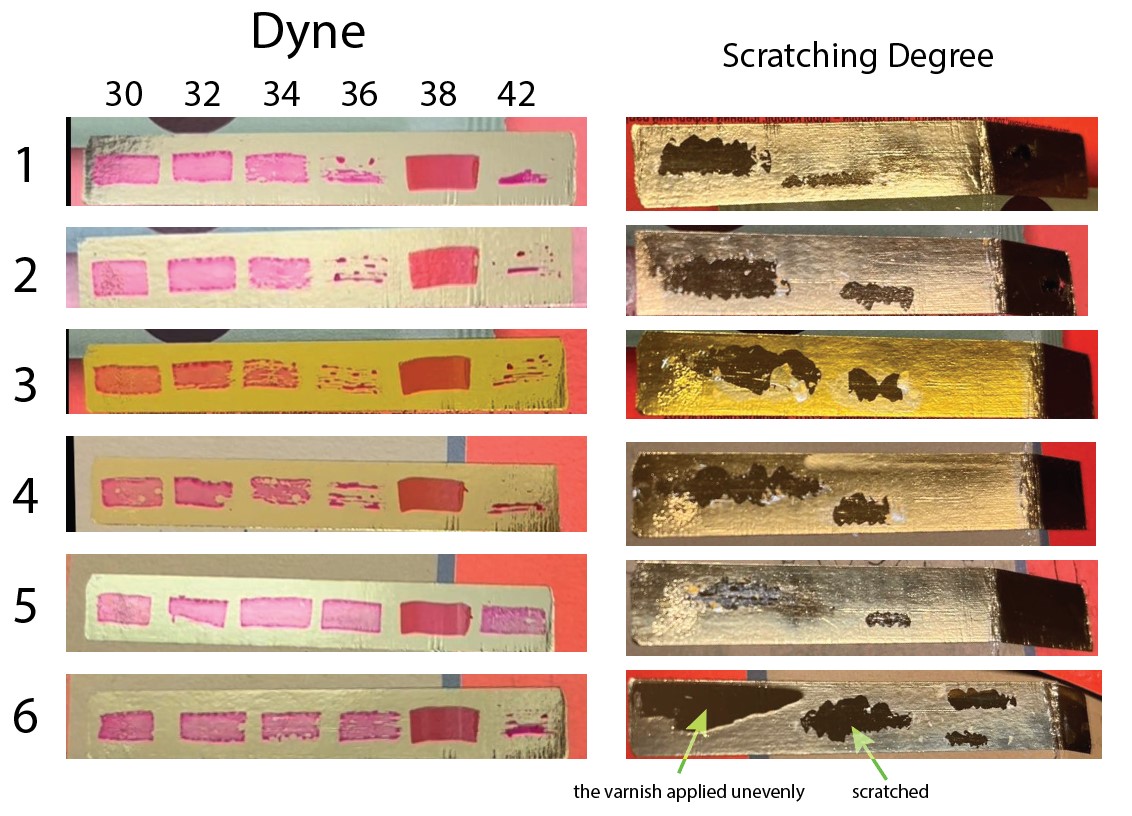

I will put several other brands of foil under equal conditions and see if any other foil gives more than 30 Dyne.
