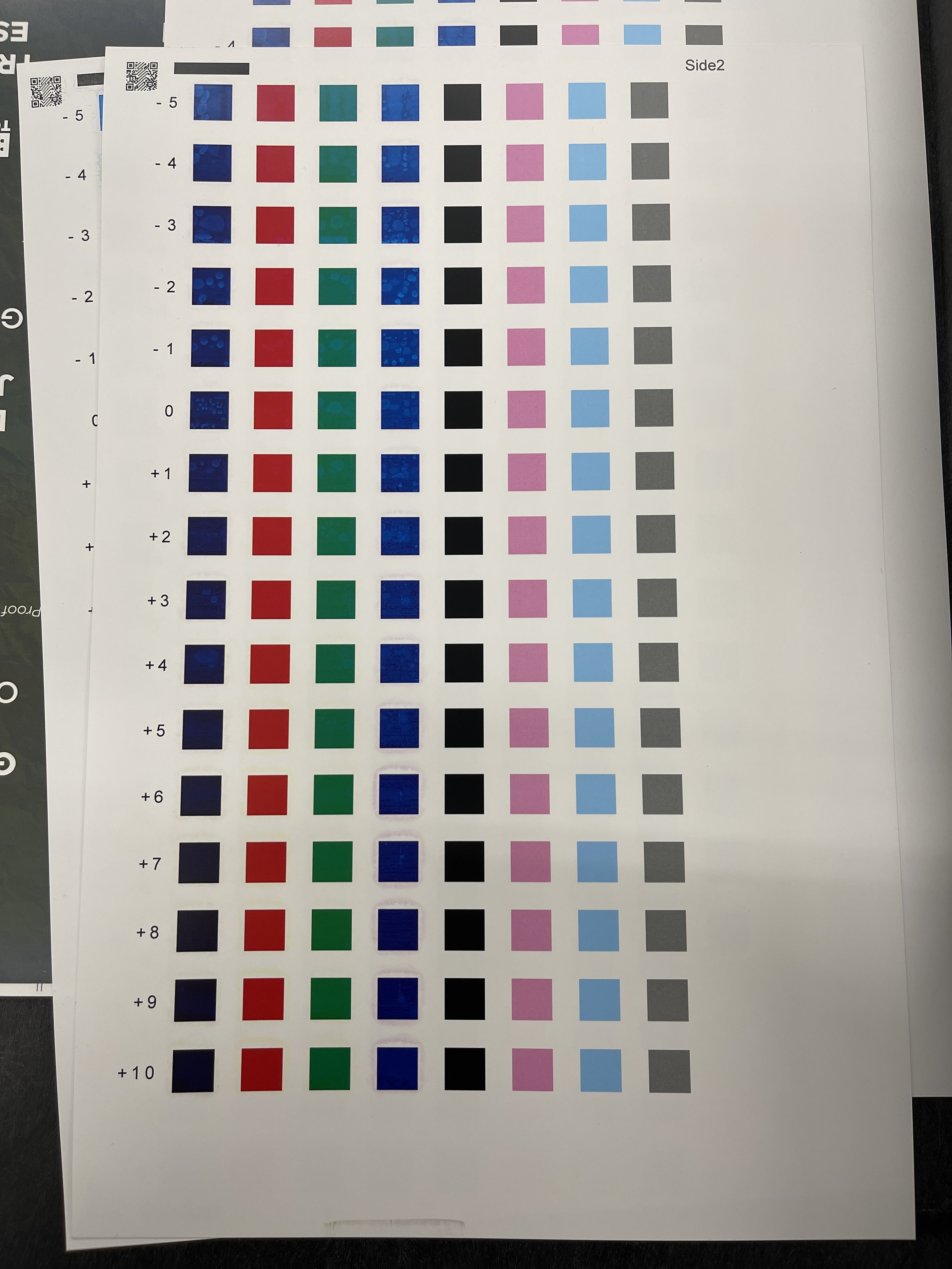

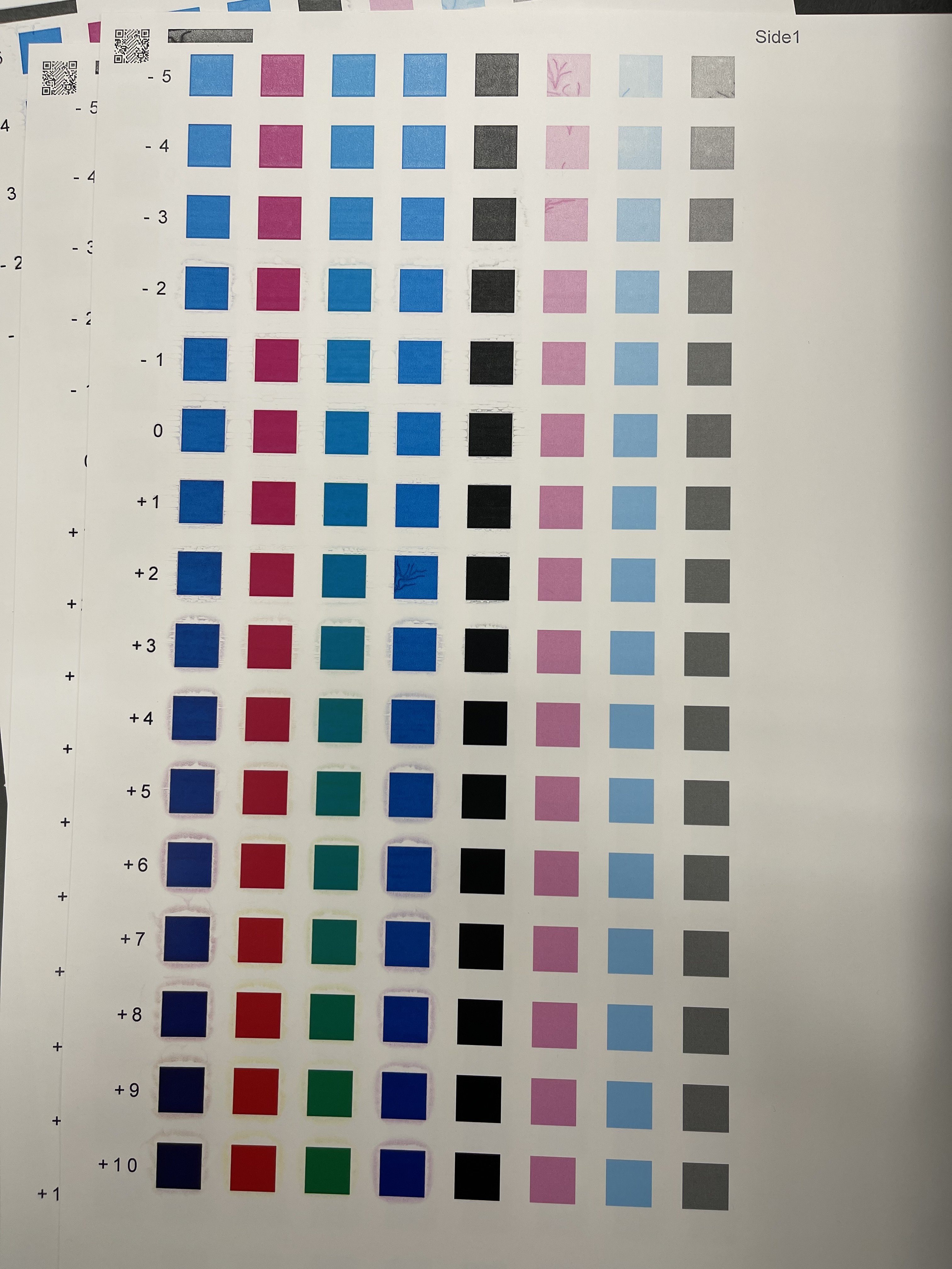

Hello everyone, have you ever seen this issue on your Versant 280?
We have a job that I’m trying to run and I’m getting no where with adjusting the transfer settings. . But we’re still getting quality issues. The same issues are occurring on both of Versant 280's. The stock is 14mil (pt) poliprint. The GSM on the package shows “410”. As you can see, we’re also getting a weird haloing. I’ve even tried simply running it single sided at 351-400 GSM

Print out a image transfer adjustment sheet and choose the side 1 and 2 settings that look the best. Use coated 257-300 gsm setting and go from there. It'll probably be different on every machine and also change seasonally how well it runs.
