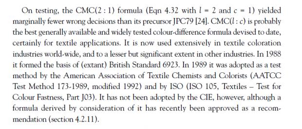

I read that cmc l:c was designed to use with D65 and for textile industry.
