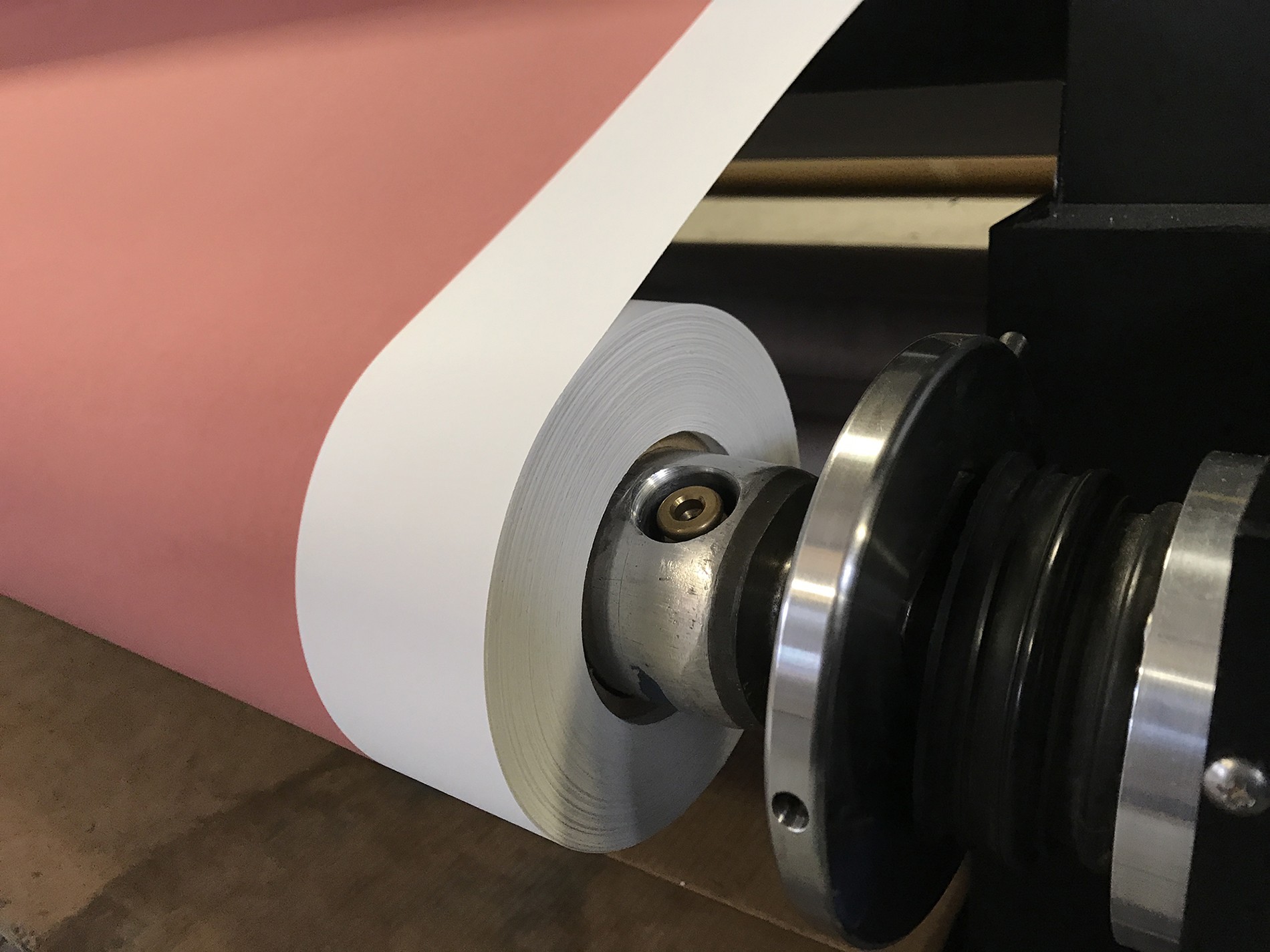

Pic 1 is about 300 feet of PMS 485C for E3 last year. (Check out that load...obviously I was proud enough to take a picture...hahaha)

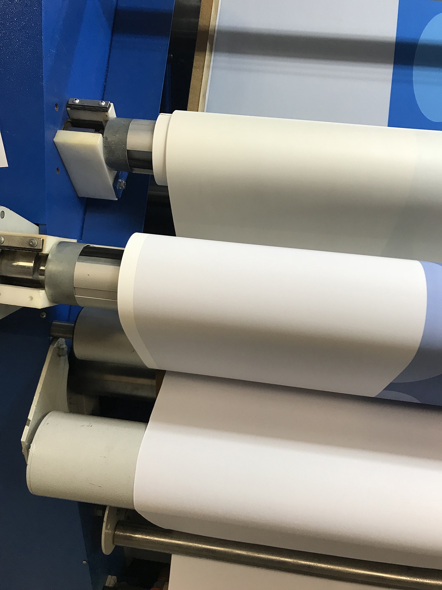

Pic 2 shows the paper to fabric process.
