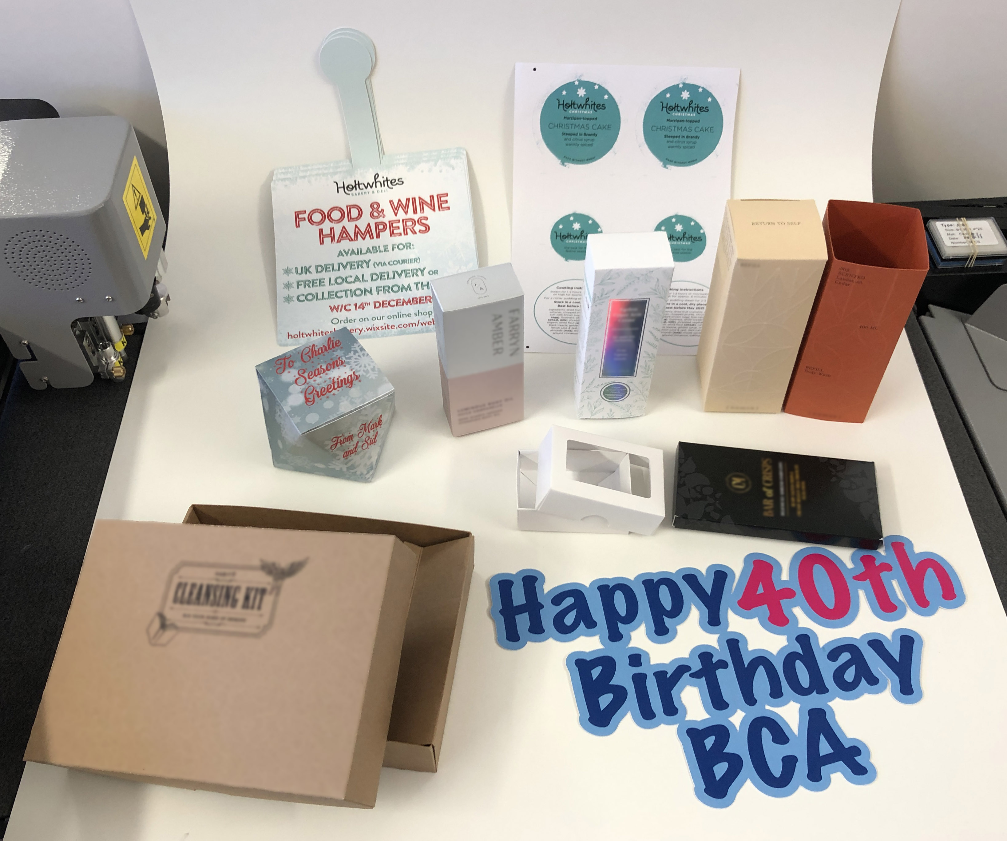

We use our Duplo PFiBlade for short run foiled, laminated carton packaging as well as point of sale, shelf wobblers, kiss cut shaped stickers, etc.
We've found Duplo very helpful in their after sales and they're always coming up with new ideas on improving the machine. We currently testing out an embossing feature!!!

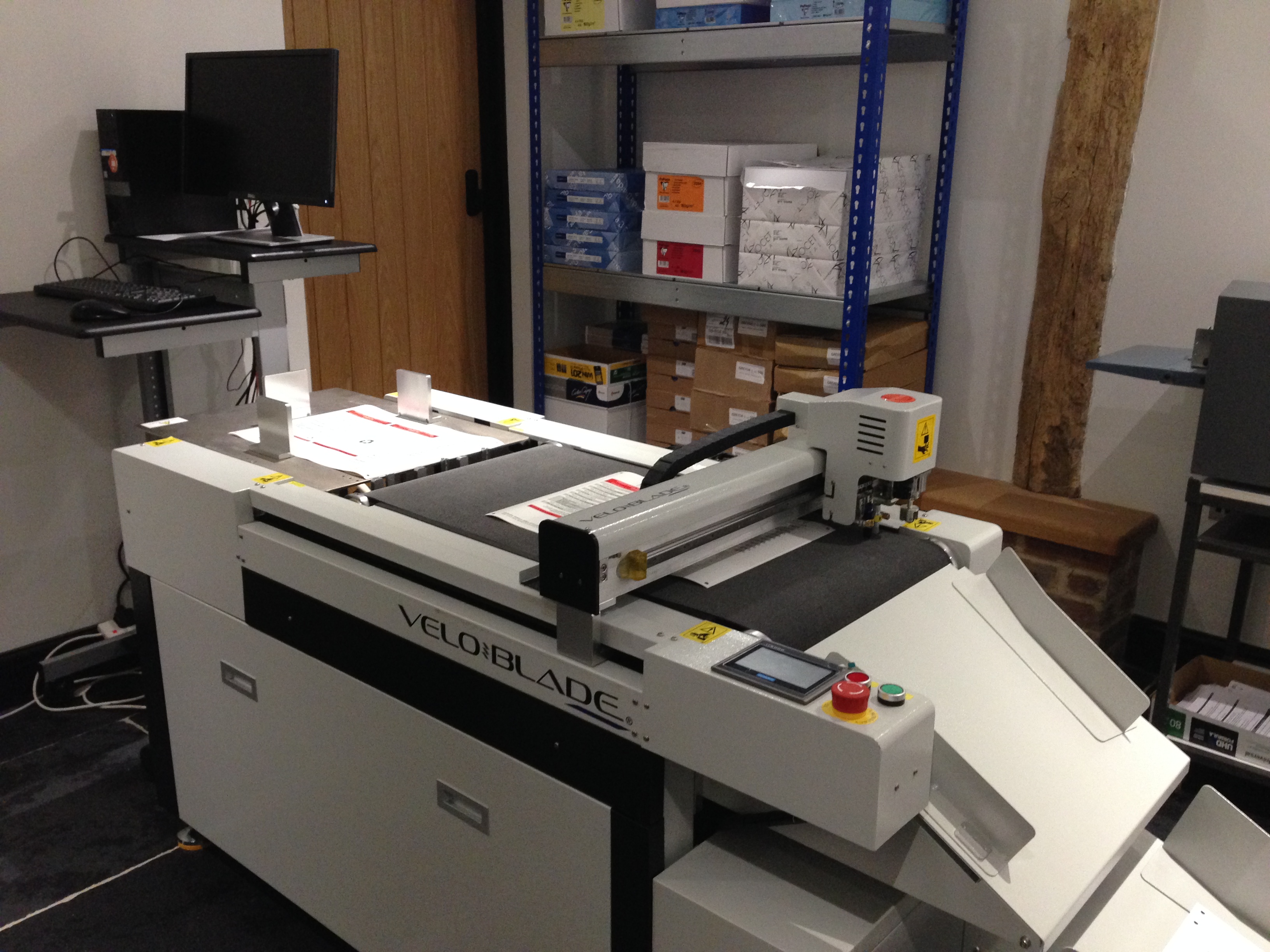

We don't use the VeloBlade every day, indeed some weeks it is not used at all. However when we do use it, it can be working for 8+ hours, with short breaks.
Our justification for it was based on several factors, in no particular order:
  • the ability to produce short runs of samples for piloting and user acceptance testing and then make changes to them without incurring finishing house costs (massively enhancing customer service offering)
  • the ability to produce full runs in-house, primarily to remove relying on external suppliers (less stress, quicker turnaround, better customer service, increased margins)
  • having a particular regular order for die cutting on an always time sensitive job, where a combination of an external supplier cut quality, reliability to adhere to tight deadlines and courier ineptitude made us decide around this time last year, "we don't care what this costs, we're going to invest whatever is required to bring the full process inhouse!"...
  • The VeloBlade represented a significant investment for us, so realistically I can't see us subbing out anything which we print inhouse for die or kiss cutting.
  • How reliable is the delivery section of your Duplo/Vivid (i.e. how often do you need to clear the tray because of a pile-up?
  • Die cutting and kiss cutting need to be treated differently on exit and there is an art to positioning the catch tray, depending on the type of cut and the substrate.
    • For kiss cut SRA3 sheets with a gloss laminate top - which we've produced many thousands of - the VeloBlade will happily work for several hours and give you a nice cleanly stacked catch tray of several hundred sheets.
    • The only proviso to this is, because there is no automatic monitoring of knife life, it is prudent to do a test peel every 50 to 100 sheets or so (depending on the length of cutting happening per sheet), to ensure your kiss cut is sufficiently deep. If you don't do this, I guarantee you will get caught out and of course, it is not visually apparent whether a kiss cut is deep enough. I hope in time Vivid will develop a software solution to fix this issue, as it's on a par with those early laser printers that would gradually run out of toner without stopping (I guess not everyone on here will be old enough to know what I'm talking about...)
    • For die cutting, sure, the output is untidy, but it doesn't actually matter. Put a blank sheet on the catch tray and when you periodically empty it, the weed falls away and it's easy to gather the die cut pieces.
    • The finished shape and size of the cut pieces will determine the best position for the catch tray. Very occasionally you may get a weed related jam, which backs up and stops the machine. For the die cut jobs we do, the machine is so quick, I tend to remain in the area of the machine and regularly empty it.
  • Or are you working with bars to keep the cut-out pieces in place?
  • Only the magnetic guides that come with the machine, which for kiss cut jobs do a splendid job.
In summary, the VeloBlade has transformed our finishing line and we are well pleased with the investment. As I've made no secret of on other posts, we like Vivid very much as a company - they have a great ethos and get what matters right, understanding the market and staying close to their customers. We bought the VeloBlade because we already had the Matrix & OmniFlow, and were very happy with the products and the support.
We've had the VeloBlade about six months now and to give a balanced view, there are just two real frustrations, which we're confident Vivid will in time fix (should be easy as they are both software related).
  • The software on the original Veloblade 64 and 68. From what I've seen in the showroom, the larger Volta and Nexus models have really nice software, whereas the "JingWei CAD/CAM" software that comes bundled with the smaller VeloBlade 64 and 68 contain alarmingly high levels of Chinesium! We would love to be upgraded to an English version.
  • The vast majority of Veloblade 64 cutting tables are used by SRA3+ outfits, such as our own. Yet there is a need to manually locate the initial registration position at the start of each job (and when the Chinese software hangs).
Hope the above is useful for you.
