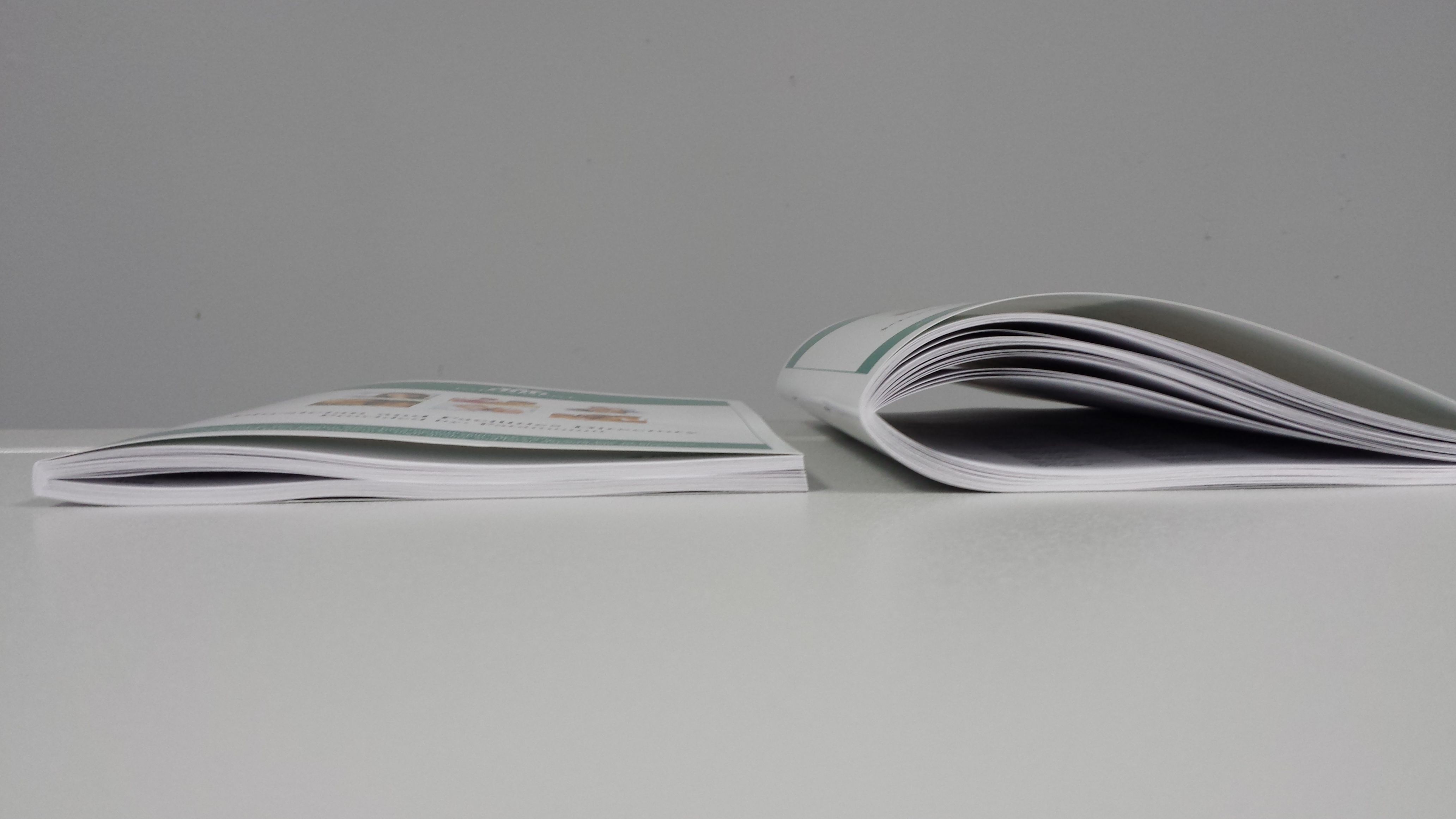

Our Morgana/Plockmatic does an awsome job with square fold. I think it was 32 sigs with 100 lb gloss cover. Same book just turned square fold off.
