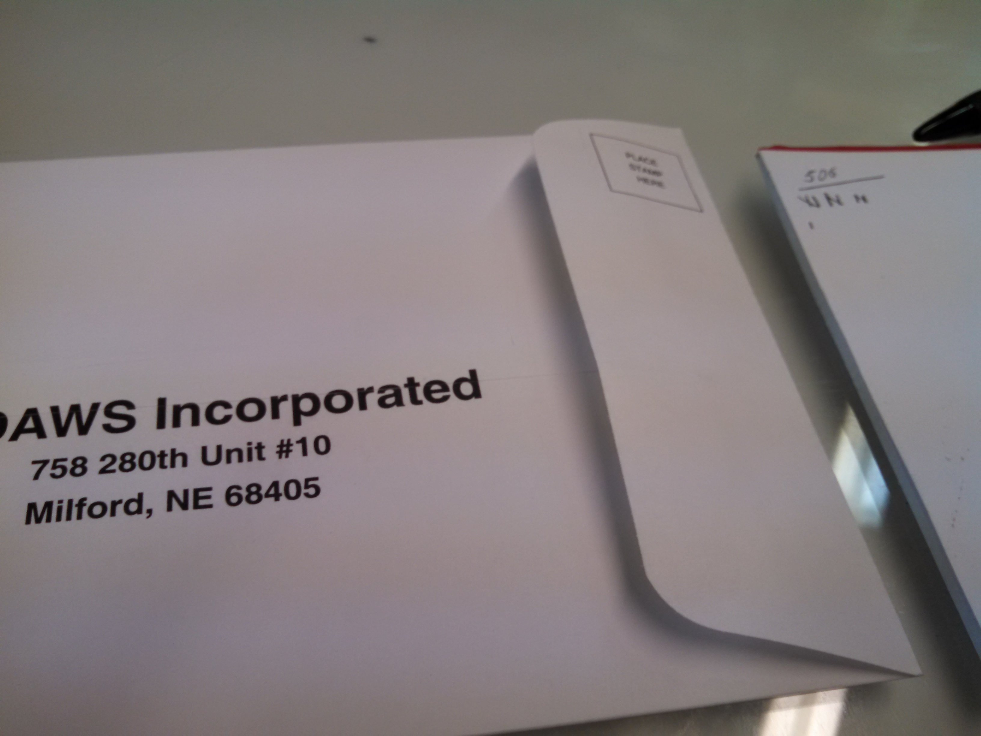

I will take a picture of what I am printing. and post it later tonight. This job is killing me. jam after jam. Running 10k then front side. so 20k run.
IMG_20150113_150732_131.jpg here is what I am running
Wow. You might want to tell your customer that they're printing that on the wrong side of the envelope. :-)
With a run that size you're best option is to do as Erik suggested and run them landscape. If you're not able to for some reason.....then open the darn things and get it over with. It sounds like you're saying they have to be printed on the other side anyway so it won't cost you any impressions....just time to open and close.
Just for the record....I'm not sure the post office is going to like those......
Yep! Another fun project! Mailer side landscape and front side I'd still run portrait (normal) just because it will run better. For a confidence builder you can throw in a stack and just run some blank ones through to see how they feed, before re-plating the job- but I'm confident they'll work for you. Post Office shouldn't whine as it looks like everything is clear of their scanner and the flaps get glued down nice and flat. I feel your grief, but it will all be over soon! :)
