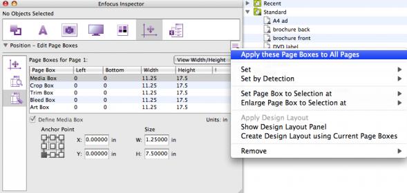

As I don't have Pitstop 10 (yet), I can't answer your question specifically.
However, do you by chance use Agfa's Apogee workflow? If so, they give you an Acrobat plugin called Docubox Manager that easily allows you to change page box specs.
You can set them here as well as the Design Layout Panel.

Thanks Joe, thats exactly what we need! I never would have thought they moved the trimbox settings to the Position menu of the Inspector... Guess I wasnt looking hard enough.
Is there a way to apply the trimbox to just even or odd pages, like in Pitstop 8?
Unfortunately I don't think so. You can either do it on the current page or on all pages as shown in the attached image using Inspector.

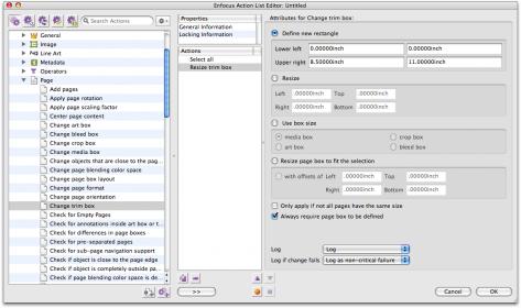

You could possibly do it by creating an action list for the odds and another for the evens and then apply the actions to the odds and then the evens as shown in the 2nd attachment.
