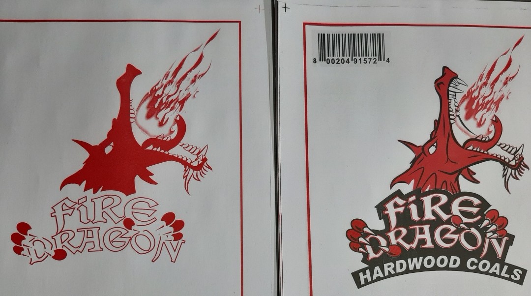

Hi, I'm a newbie here. Interesting reading. Hope everyone is safe from the virus. I'm working on our old ab dick 360, it will be 49 years old this year bought new. This is a print I did yesterday on it of 1000 sheets. It was just two colours and ran using laser plates. I was curious to see what it could do. Registration took some adjustment with making sure paper was cut square and impression was just enough and I ran at the lowest speed. I would like to hear your feedback, dont be too harsh, I'm learning this press and offset printing with avg 4 months experience actually operating the press.
You're doing well to get any decent registration using laser plates. While you can get away with it on a logo like this where the absence of trapping can appear to be a design feature and the black overprints where possible, you won't succeed on more critical fit jobs.
Most printers would have laid the black down first as a key before printing the red.
Thanks for your advice on the colour sequence. I did this to help out a friend. I usually print line work and mostly black jobs. I'll note that for the future. Thanks again and be safe.
