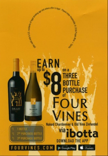

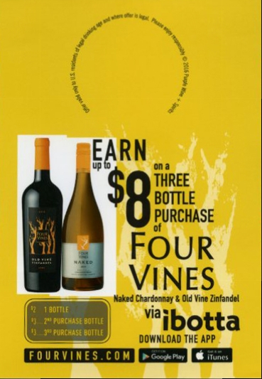

This is something that has been happening infrequently and we have always found work arounds . . Yesterday I got a .ai file with some transparency used on an Illustrator element and then there were two photos (wine bottles) with a transparent background placed into the file. When I ran the Illustrator file (placed into InDesign for output) we got the image with the white boxes, I then removed the wine bottles from the illy file and place them into the InDesign file - same result. In the end I ripped it in Photoshop to 2540 res (that being the resolution of the Prosetter) and the boxes went away . . .
We are using a Heidelberg Meta Dimensions rip and Signa Station
I am so confused - does anybody have a clue whats going on?????

Zoran . . . pm me your email and I will send you a zipped file with links fonts etc . . . also it looks fine in the pdf its on the ripped file that goes to the platesetter that it shows up and sometimes on the proofing printer

Well . .. something I didn't mention was that there were two illy documents from the same "artist" and with different but yet the same elements . . page one ripped fine and page two had the transparency and screwed up . . . and yes we had an Indigo for years and they never fixed it in the time that we had it . . . We are running an up to date Meta Dimensions Rip (we bought the software support pkg but not the hardware support) will give the GWG test a try but still puzzling to me. Just checked and there was a spot color . . it was the 109 yellow background . . will change it to process and see what happens - will keep you posted.

looks like its the opposite of transparency, if you flatten out of InDesign, and the background is spot, you sometimes get 0% cmyk channels set to overprint the spot or vice versa, unfortunately when you convert the spot to cmyk you then can't overprint cmyk with cmyk. If you ask InDesign to to convert the spot the problem should go away.

Heard from the plate dept . . . seems like changing the changing the spot PMS109 to a process build solved the problem . . . . and got another one in from the same artist . . . even after sending her a "suggestion list" of things to do differently . . . it came in even more screwwed up . . . . oh well . . .just ring up some more prepress time . . . Like David says keep them profits up!!!
