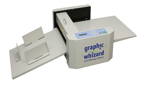

RonHuang

I would invest in the manual tabletop creaser for now. Your volumes are low, and in the future if you did end up with some creasing automation - you will still find that manual creaser coming in handy.
Regarding automation, we currently have a Graphic Whizard PT 331 SCC. The creasing/perfing, slitting, and trimming is all automated, but the feeding is manual. It's really a great little machine. The PT 330 that @RonHuang linked above looks to be the same thing, just the creaser-only. There are a lot of automation options for creasing. When the time comes, see if it's worth buying only an automated creaser, or if it would make more sense to pick up a slitter, cutter, creaser (SCC) that can simplify more jobs in your shop.

RonHuang

Hi guys,
Getting our new production printers very soon and I was thinking it would be good to get a creaser for occasional printing of greetings cards and for creasing book covers.
Local supplier has this machine which is inexpensive and it will crease up to 400gsm.
Volumes will be very low and infrequent. Will this machine be sufficient? Is there anything I should know about creasers?
Thanks!
Hi BCR, Albyco is a Belgium dealer so i guess you are from Belgium where Graphic whizard has no dealer. However, their supplier has a dealer located UK supply similar product as following:
And the product crajos mentioned above PT331SCC are as following:
You can take a look.
