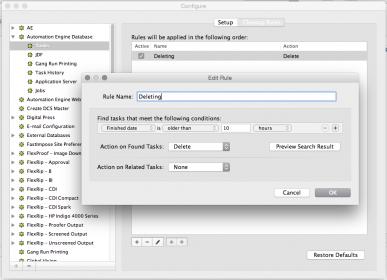

If you have the Jobs module, you could always use the following smart names [Job Temp URL]/[Task ID] in the output in field in the tasks making the temp files. These folders are automatically deleted when the task cleanup rules run. They are also invisible to the Pilot.

Option 3: As Marko mentioned you should be using the [Job Temp URL]/[Task ID] in your tickets to put your filed in the temp folder. If you are doing this then use the cleanup rules to remove your tasks after a specific time. This only works when if you files are in a [task id] folder because that is the unique ID linked to the task that ran. You can also manually remove by selecting them and deleting the task.

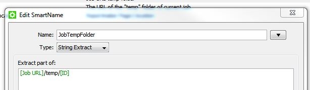

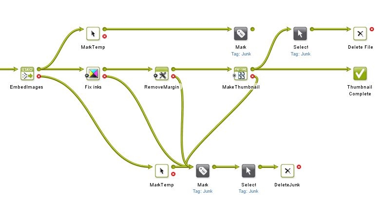

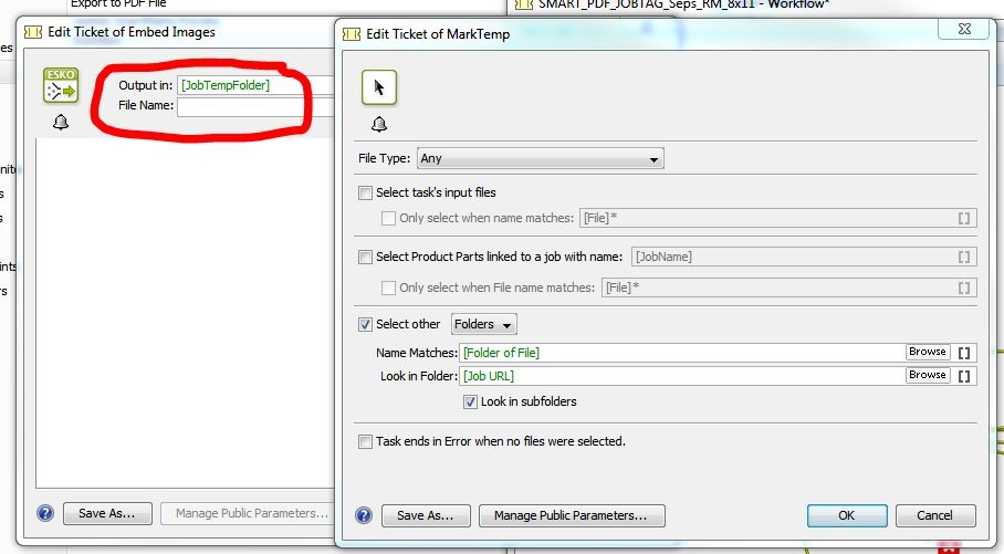

Scripts and autodelete don't always work. I have followed Esko's best practices and created a jobtempfolder smartname and put it everywhere I want to clean out and then immediately select the folder then mark it as "Junk." When the ticket is errors or completes it deletes the "Junk" tagged folders and files. Hope this helps.
