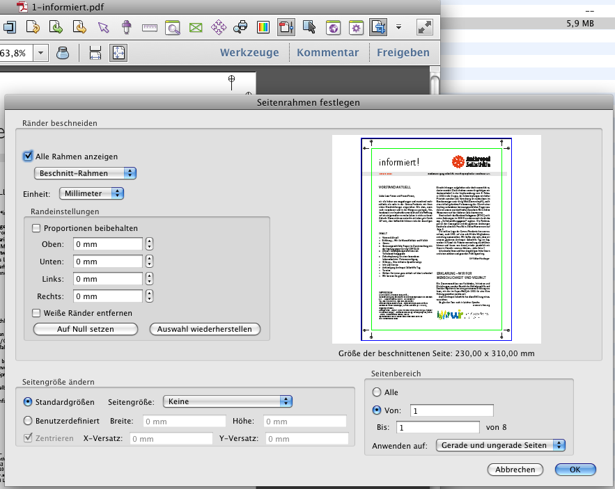

You do not need PitStop or Callas Toolbox, you will get the information about boxes rather quickly with the Crop-Tool in AcrobatPro too
(look at the screenshot attached, the tool last right in the Menue on top, just choose the box you want to know top left in the dialogue and then look below the preview...)

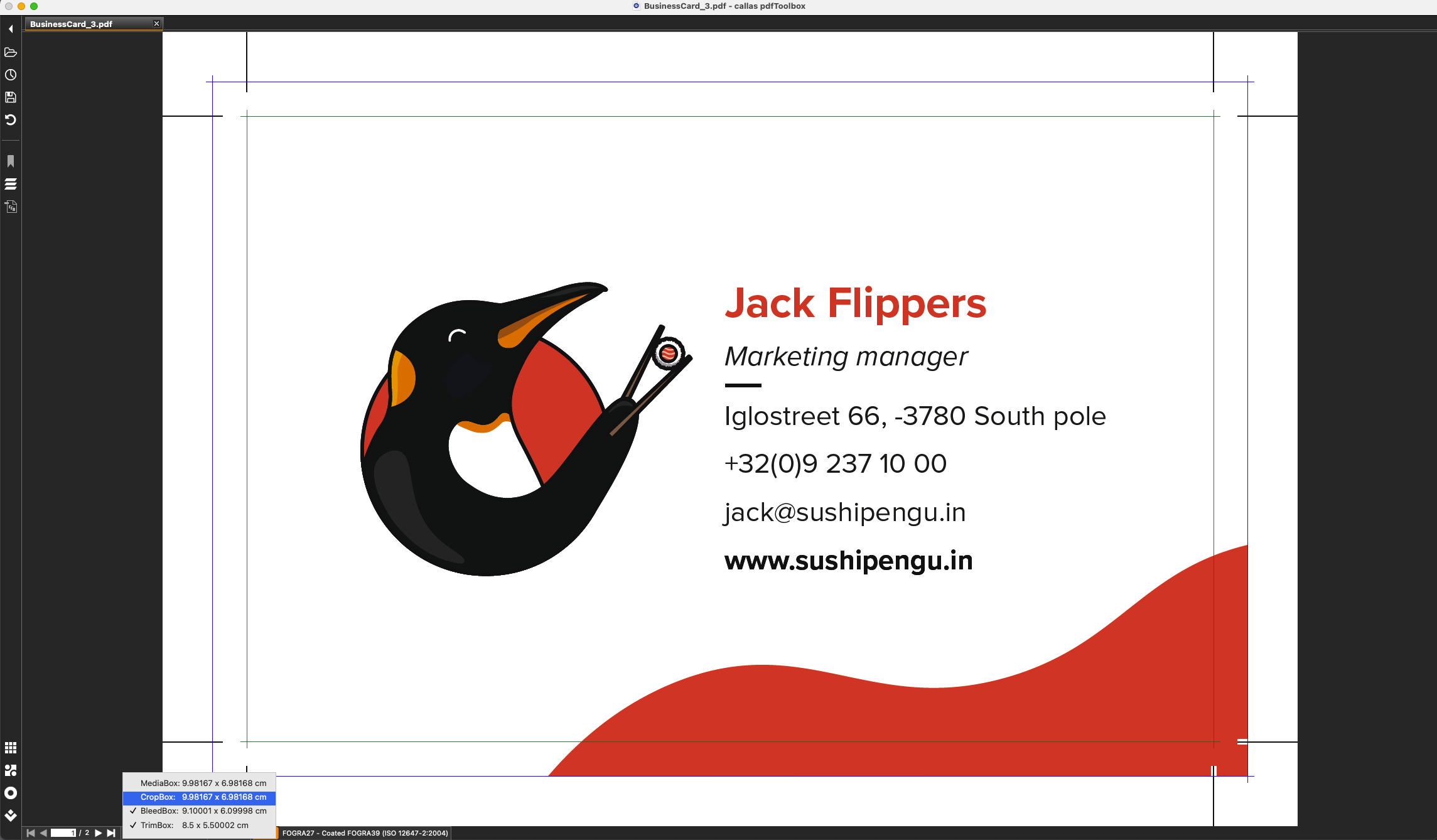

Gianni, all boxes can be turned on and off in the dimension drop-down in the lower left-hand corner, you could also create a fixup that puts the lines on a PDF for you, and then another fixup that would then take them off, or put them on a layer, lots of options! get in contact if you would like further help
