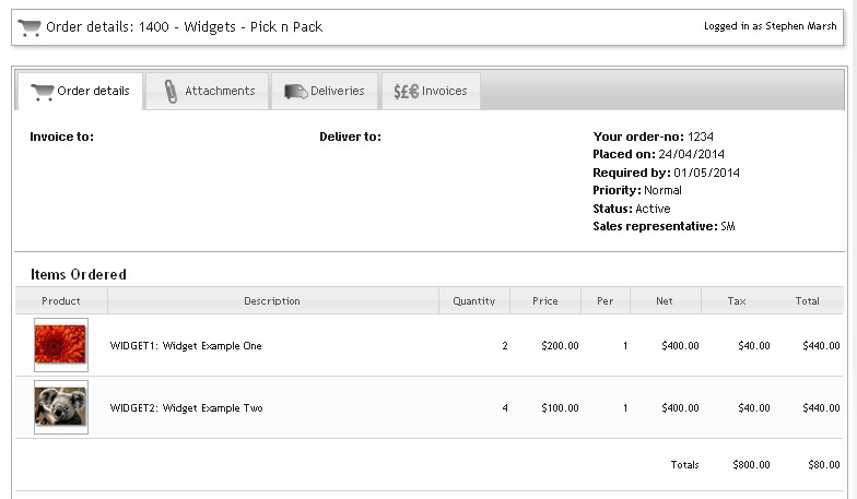

I can’t comment on the Esko side of things. To me, this sounds like a task for an MIS/ERP system. I produced the attached PDF “pick n pack list” which includes text product code and barcode from the Accura MIS, using the stock control module. Image previews can also be added to the stocked products and viewed from the online-system using a web browser (image attached of the view of the order online, the order line item thumbnails open up as an enlarged image preview when clicked).

The workflow that I mentioned using Accura handled taking in the original order and producing a job ticket/bag, producing a pick list for packing, issuing the stock to the order (taking it out of on hand stock levels), producing delivery notes/parcel labels, invoicing and also providing a real-time view of the order items and stock levels - additionally offering a web based method that could be used by a “thin client” with an internet connection and web browser to visually check that the order items match the part being picked (in addition to using human and machine readable stock codes).
