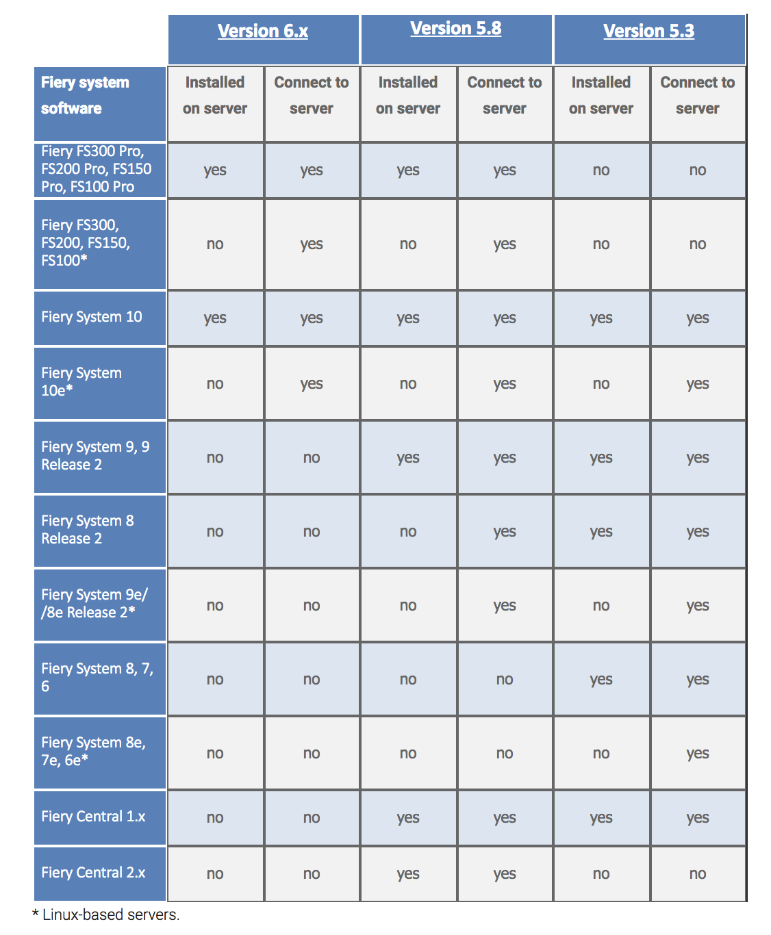

From the EFI Fiery website. CWS ver 6 only works with newer Fiery operating systems.
Here is the link for more info: https://www.efi.com/products/fiery-...fiery-command-workstation/supported-printers/
Here is the matrix for the different Fiery operating systems(pic)
You cannot upgrade older Fiery's to newer Fiery operating systems. Example: a version 8.0 to a FS300, won't work. Some controllers were Windows based with Fiery OS on top of it. Fiery migrated to Linux based embedded controllers to improve performance, again you could not upgrade these. The Fiery OS is engineered based on amount of RAM and CPU rating. Even with more RAM in a older Fiery the CPU would not be able to perform due to CPU.
Best solution for older Fiery's as previously mentioned is to run two version of Command Workstaiton, ver 5.3 for the older units and Version 6.x for the newer. The matrix shows which Fiery's are supported with the new Comand Workstation ver 6.x.
Hope this all makes sense and helps you out.

Actually I totally understood your questions and my answers still apply:
1) No. The internal Fiery OS on your 560 is too old, just like our 7775 to allow CWS6 to run.
2) No. This will void your lease contract almost guaranteed. CPU upgrades are not easy in the first place on an existing system, so I would never attempt it on a proprietary system like Fiery that forbids you from modifying the hardware in any way. I do build computers from scratch regularly for what it's worth. I doubt even if you wanted to pay EFI $10k+ and they agreed to perform the upgrade that it would make enough of a difference since you'd be talking about a 15-25% CPU capability increase maximum.This was the edit part from my post. Reading it again it was indeed confusing.

However, thanks for the rest of the reply. As others have said. It’s not going to be possible to upgrade the software on the c560 which sucks but hey.
The cpu upgrade on the other machine is also not going to happen. It was just a curiosity rather than anything and while I certainly don’t agree that a cpu upgrade is difficult (I used to build computers for a living) and the service manual for the Fiery we are getting shows that the cpu cooler and cpu are removeable, it’s just not worth the risk of having my service agreement pulled if Konica ever found out.
