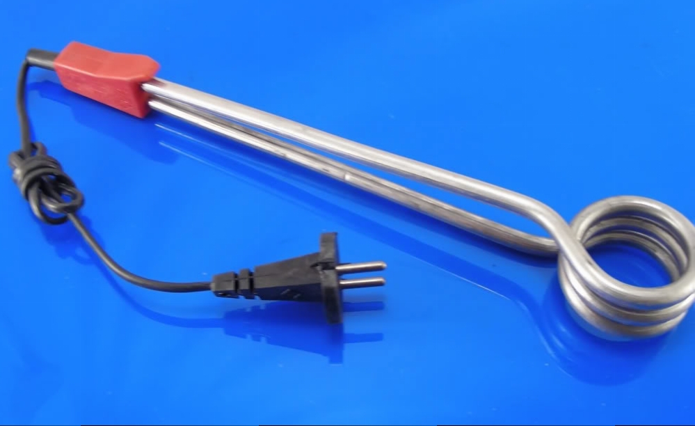

I have seen some increase in Gloss levels as a result of heating the UV coating to make it flow easier. We used just a small electric element heater, dont heat it too much though as it might start to 'cure'
Is that a "coffee cup heater" cant tell for sure nothing to compare it to. We have taken to wrapping our 5 gallon buckets in an electric blanket and turning it on about an hour before we start to run. I'm sure that there is a heater out there for 5 gallon jugs . . . and then there would be something like this:
Grainger.com and search for barrel heaters . . .
That's a very good point Cornish - the environment isn't controlled so the tanks would often be pretty cold! Will try that too.

The comments made by Cornish are quite valid, however regarding heating the coating, as with the immersion heater described, even a band heater can cause premature gelling on the sides of the container. you would be best served with the addition of a small mixer to move the hotter outer coating and producing a more uniform temperature within the pail. I would keep the overall temperature around 110 deg F.
