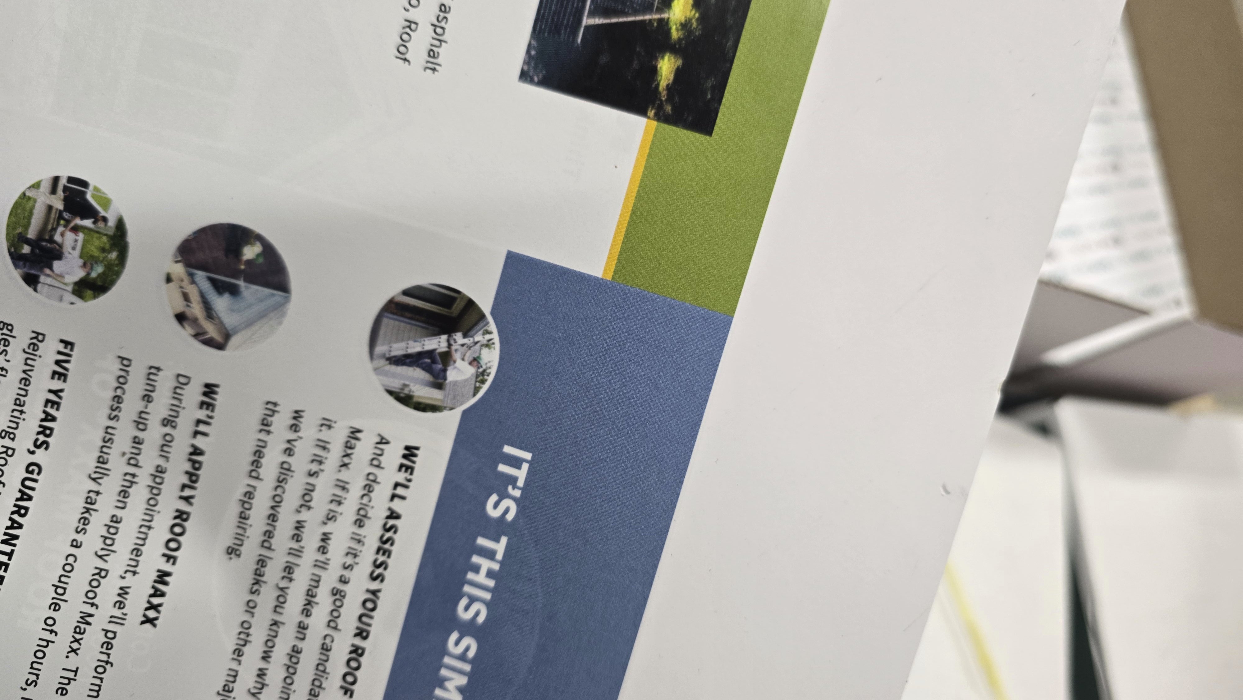

I own a family print shop,I run a small family print shop. I’m not formally trained, but I’ve operated digital presses for six years and I know how a sheet should look and how to calibrate for consistency. I also know how to calibrate and keep consistency. Based on what Canon sold me and what their literature promises, my V1000 is not performing as expected.

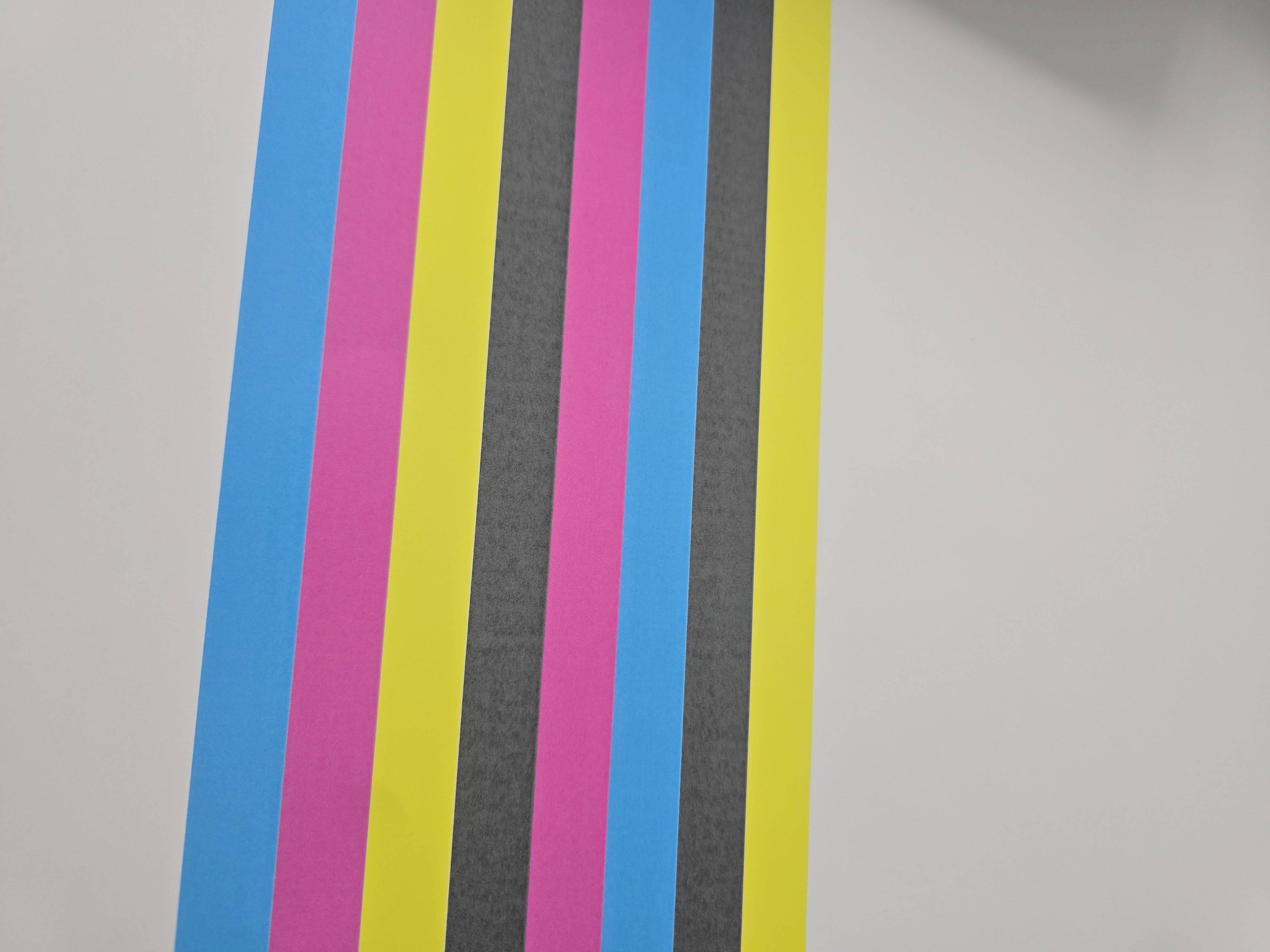

Issues i am experiencing-

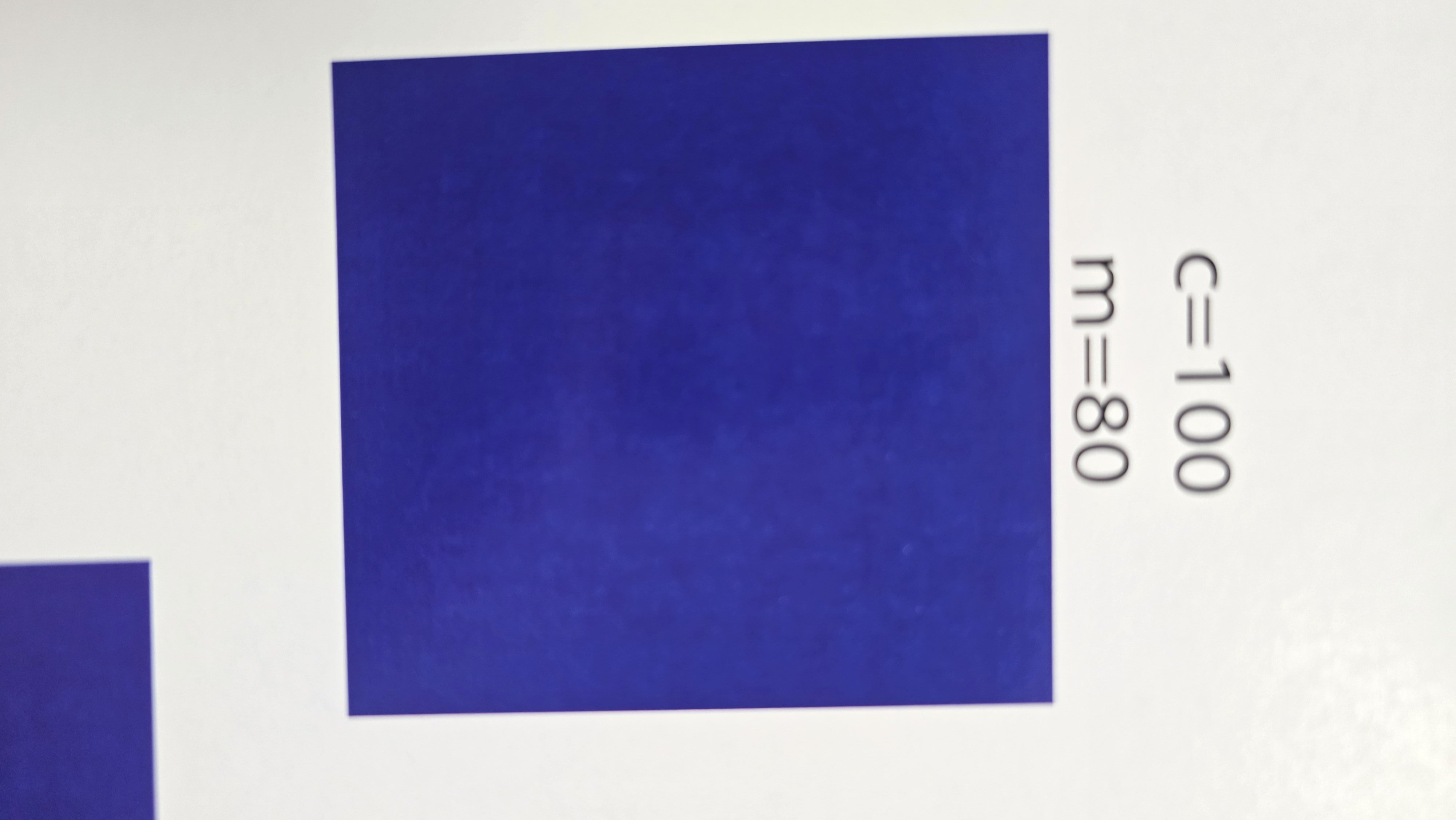

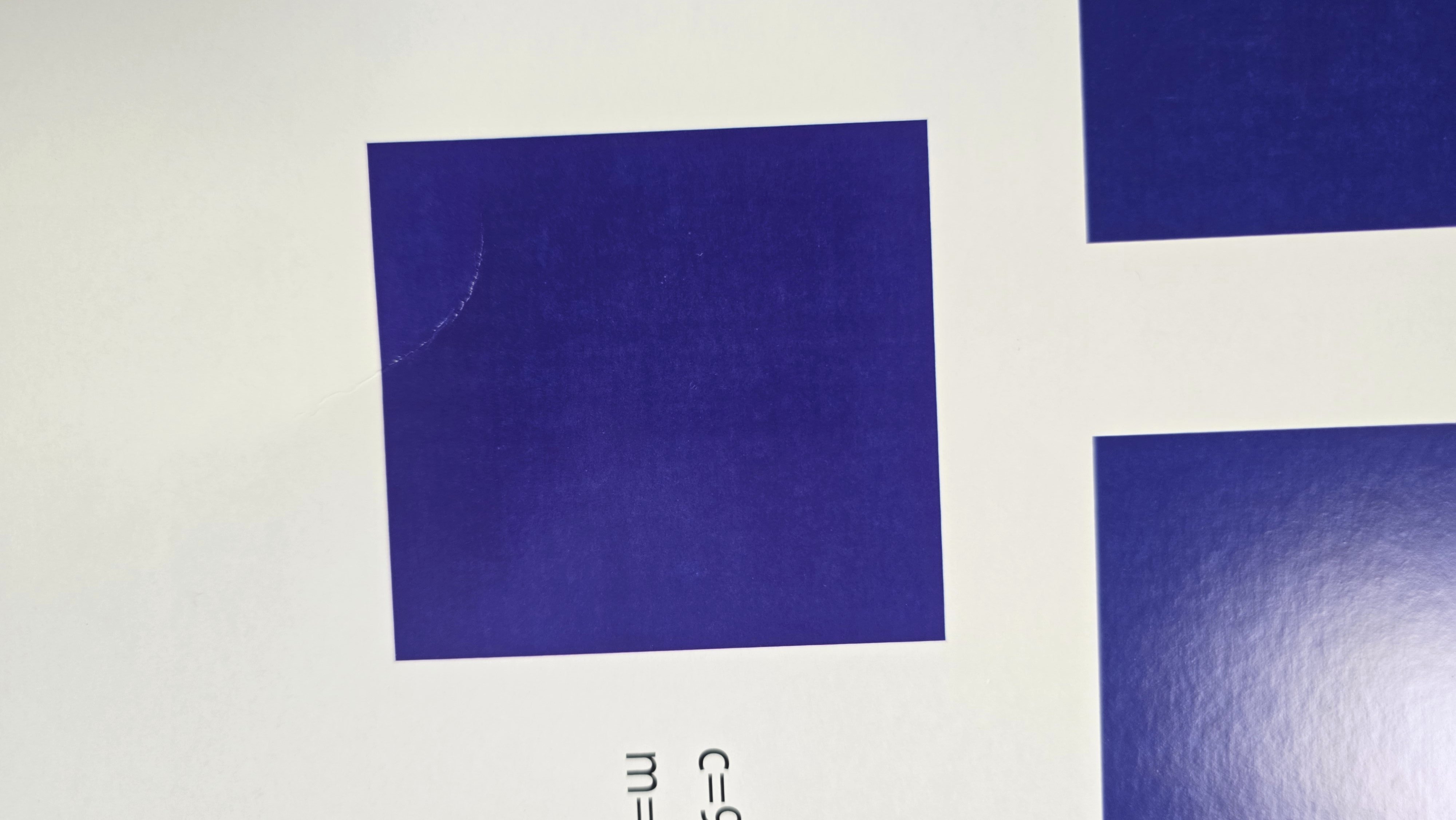

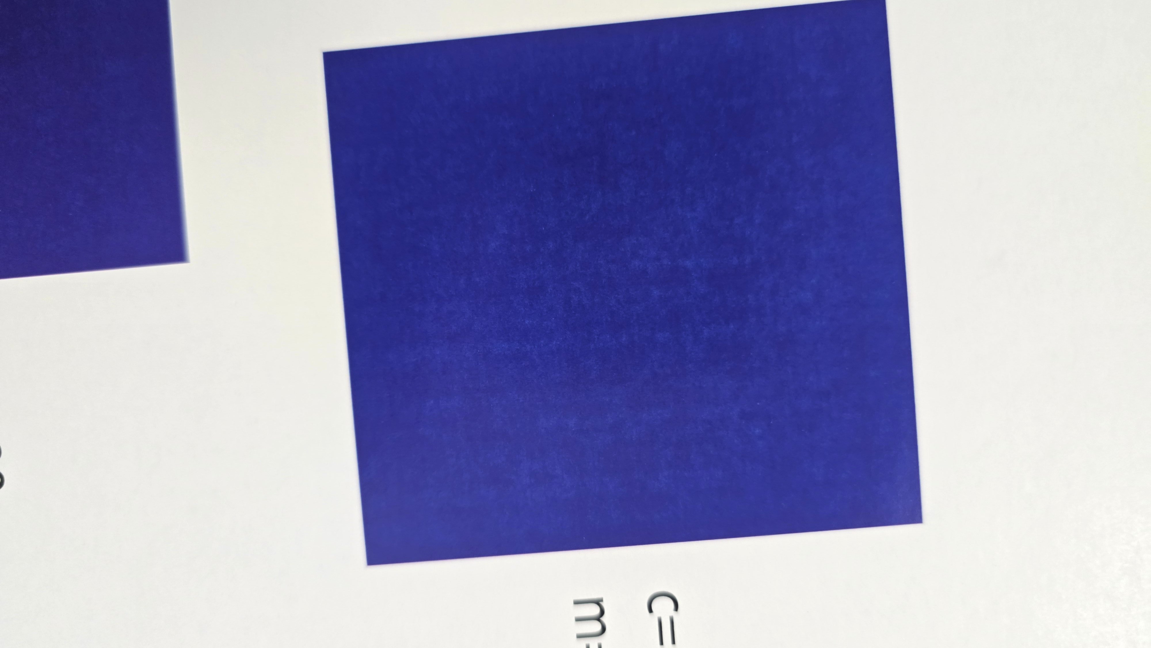

•CMYK blues drift violet. C100 M80, C100 M90, C100 M100 all skew purple.
• Skin tones print yellow.

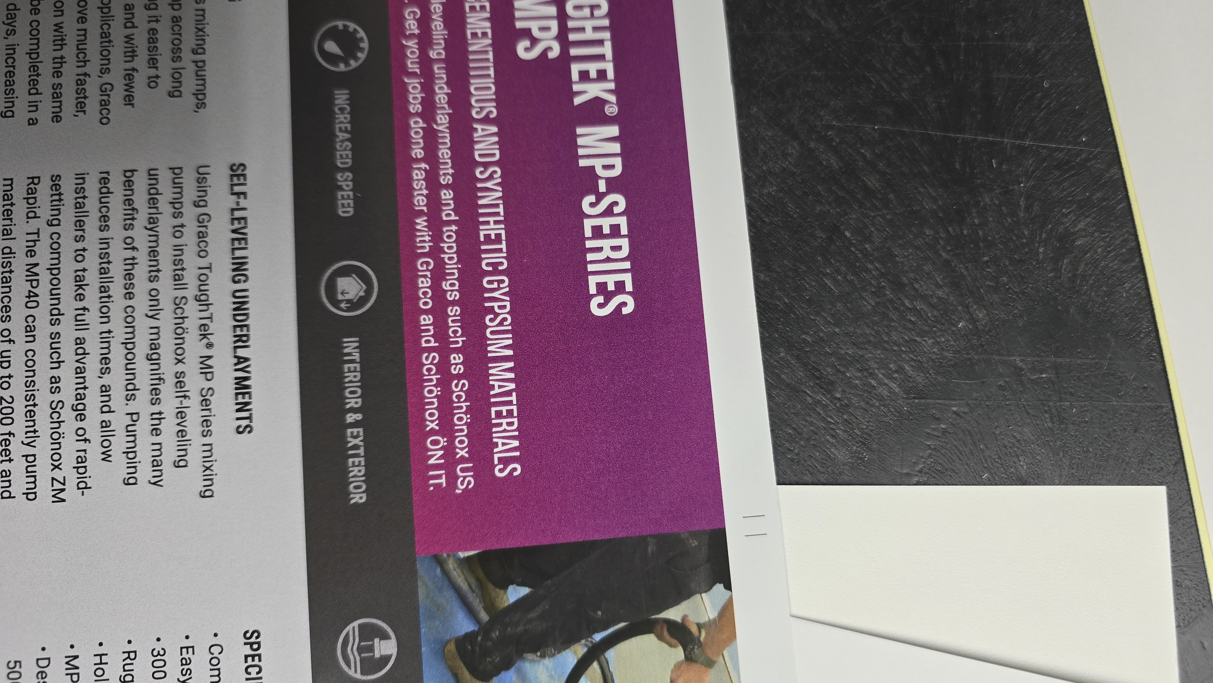

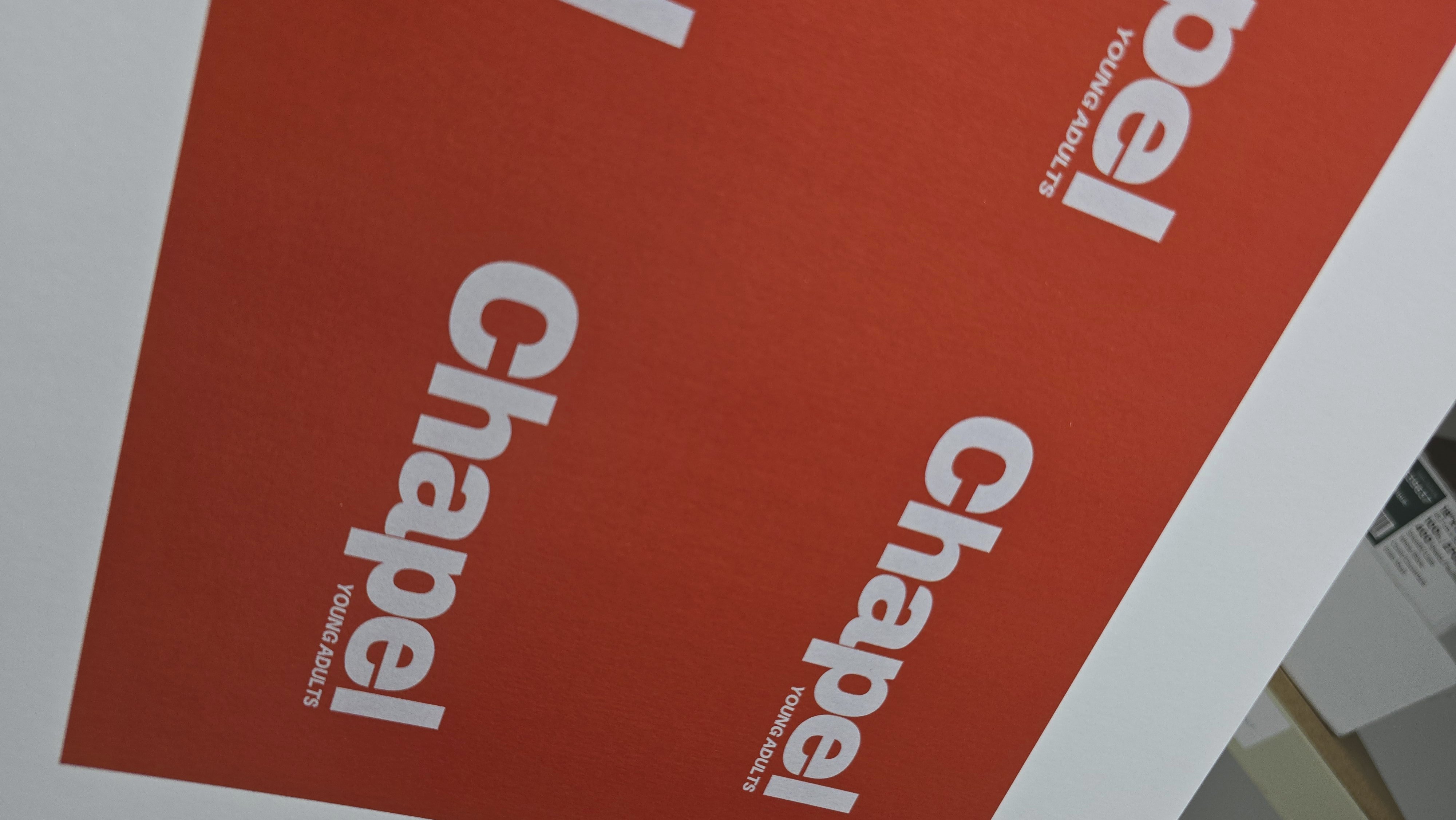

• Mottling and occasional banding in large solids.

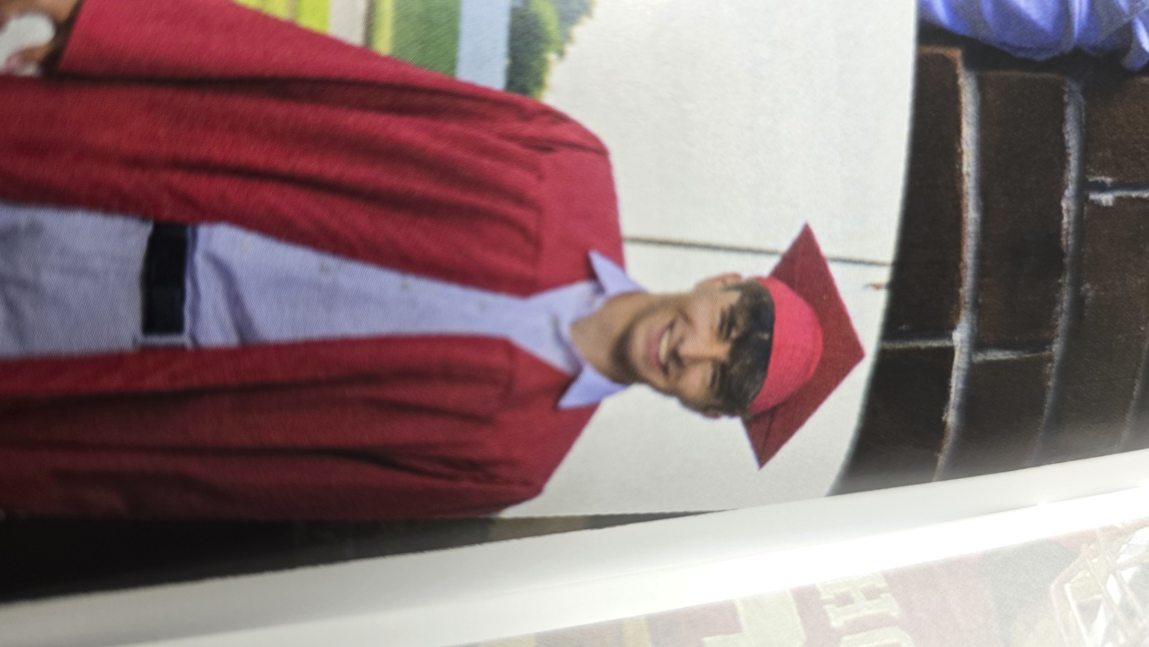

• Detail looks soft and grainy. Faces are not sharp whatsoever. Detail is not crisp.
• Color lacks saturation and punch. Dull
More plainly, the colors incorrect. The prints are not sharp. Everything is washed out.
Actions taken
• Paper Catalog mapping verified per stock. Tested heavier coated mappings.
• Auto Gradation Full CMYK per stock and tray.
• Shading Correction per stock.

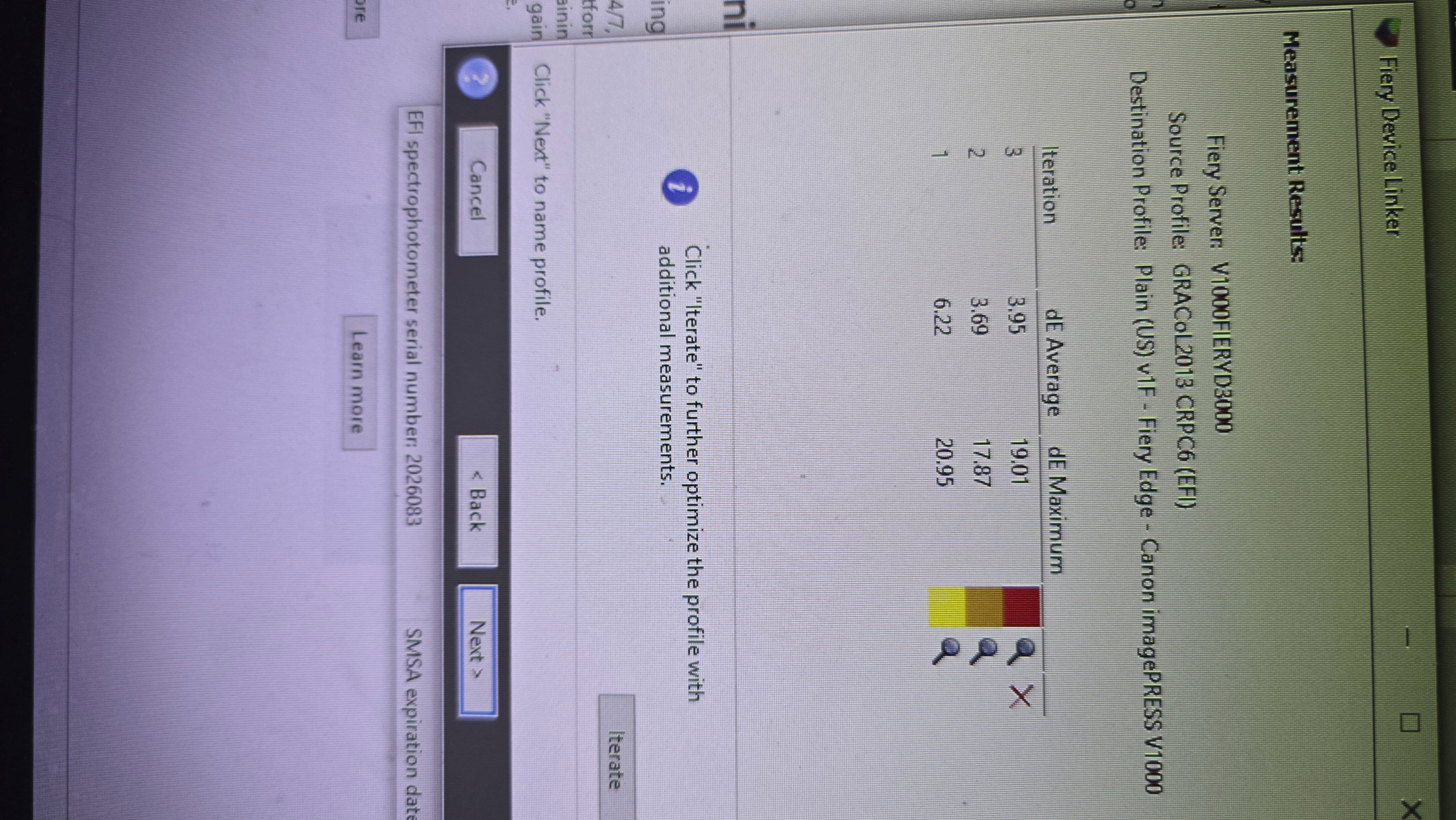

• Fiery calibration sets created on the exact stocks with spectro and applied.
• Job Properties for isolate tests: CMYK source Bypass conversion, Use CMYK embedded profiles off, Output profile = stock profile, Screening = Default/Text-Graphics.
• Also tested SWOP2013 CRPC5 and GRACoL2013 CRPC6 simulations.
  • I have had printers in my area print the same files, even a Konica Minolta 3070 i had before this machine, all pop and do not have the issues. A printer right down the road from me has a canon c800, printed the test prints i had and included this in the data i supplied the canon tech to which he ignored stating different machine. I get that, but the print quality is noticeable.
  • i have prints to compare from the beginning of us receiving the machine proving degradation.
Per our lease/service agreement, our dealer flew in a Canon tech. He inspected on site, acknowledged an issue, and took print samples back to his office. He said he would confer with Canon and report back. After repeated follow-ups over the next two months, my dealer contact relayed that “Canon says it is within spec.”I asked what reference and tolerances they used and what “within spec” meant. No answer since. The defects persist
I get gaslit and dismissed. I don't have enough knowledge to prove an issue that is actionable.
I can attach the isolate sheets, engine charts, and verification reports. If there’s a specific test or report format the community wants to see, I’ll supply it. I am willing to do whatever to get resolution.

You samples are horrendous. The first thing I'd say is your line screens don't seem to be set up correctly, but beyond that, your prints are washed out and you have a ton of banding. I wouldn't consider any of those prints sellable where I work.
I've demoed a V1350, and the prints were sharp and vibrant, so there's 100% something wrong with your machine. Do you have any of the samples from when you initially demoed the printer before purchase?
One last thing, I've only run PrismaSync versions of Canon, but on my controller I have a way to reset everything to factory defaults, and then create new profiles. That might be an option worth trying?
That is Canon's standard operating procedures. Everything is in spec even when it's blatantly not. Usually when they fly someone in, they then tell the tech that $3k in parts need to be replaced. Which of course does nothing to fix the problem. They are not an honorable company. I've replaced my dozen+ 800s and 910s with Ricoh's. They aren't perfect either but at least they will acknowledge a mistake and correct it-at least that has been my first hand experience. The only good solution is to buy a KM or Ricoh.

  • Even with the v900s we cannot use the inline spectrometer for color at all. I was able to successfully prove the exact same results across three v900s where the colors all skew pink if we use the inline spectrometer. That's what will cause your blues to turn purple.

    • If you use the canon's inline spectrometer, this grayscale sheet will be pink every single time (at least in our shop).

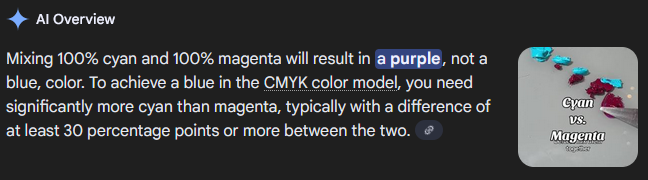

These values do make a dark purple...

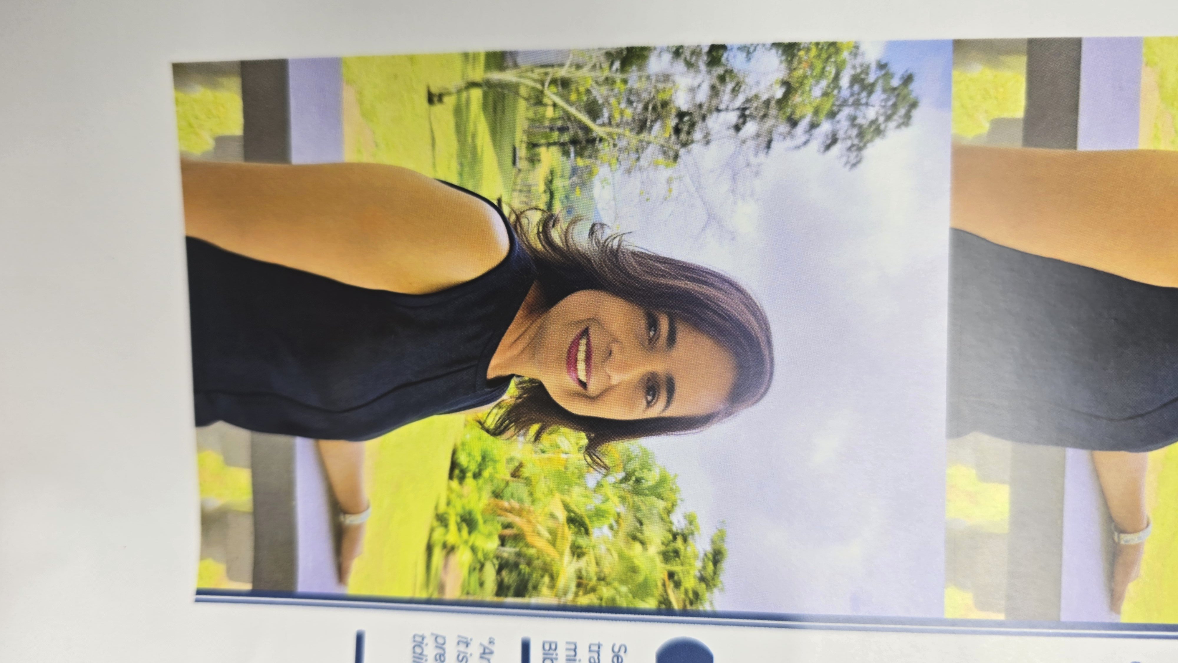

The photo of the woman looks sharp. The photo of the graduate does not. It would be helpful to see the original file to check if it has the proper resolution, and to see if it's a sharp photo to begin with.
I would be interested in viewing the original file of the woman that looks yellow to see if it does have too much yellow and the printer is correct. You can't trust your monitor...only the numbers. You can view the CMYK makeup in Acrobat Pro by going to Print Production>Output Preview, then hover over that area.
I'm not siding with Canon on this at all, but I used to sell production KM presses and customers would often complain about color issues like these. Once we actually reviewed their files, we found out the printer was printing it accurately. I'd even hear them say their old Xerox/Canon/Ricoh printed the color of a certain file just fine...which actually meant their old machine was not printing it accurately, or they just had it profiled to force it to work the way they wanted. I would show them this by changing the color profiles during a demo and they'd see the press could be manipulated to get whatever color they wanted.

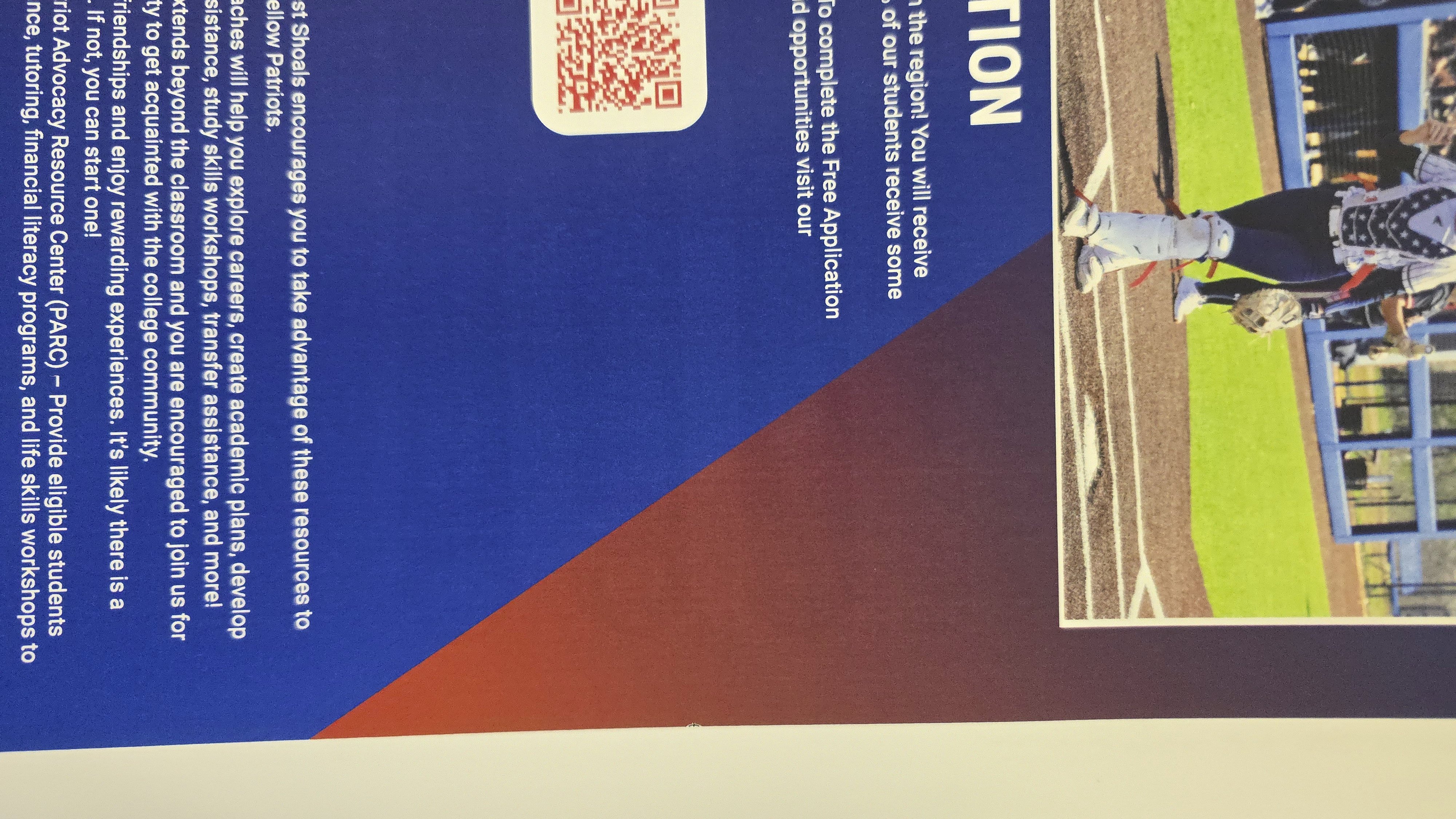

As for mottling of the large solids, have you tried different types of paper with the exact same file and still get the same results? For instance, if you're using an uncoated, or clay-coated stock, have you tried a high-quality digital gloss sheet instead? I always hate when techs say, "It's your paper" but sometimes it is.
Lastly, for the photos showing text...do the prints actually have that blur/shadow around some of the text, or is that just a result of taking a photograph of it? That would be unacceptable to us. Our KM C7090 was having trouble (and still does occasionally) with small reverse text or colored text, especially in the corners of the pages looking blurry because the colors were out of register.

Based on the photos, your Fiery appears to be set to use FM screening, which can produce a slightly fuzzy, muted appearance. In my experience, FM screening - and most dry-toner devices -are not ideal. Even minor wear in the consumables tends to show up very clearly with such fine screening. In addition, the black drum or developer unit likely needs to be replaced due to the visible banding

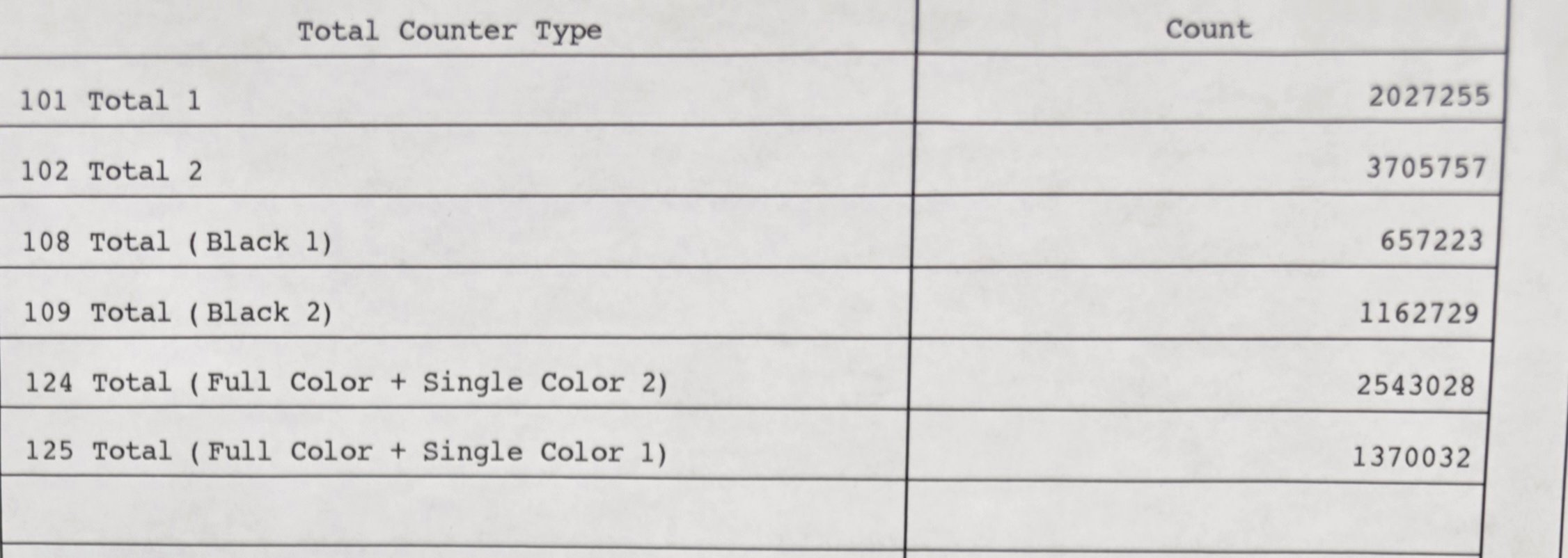

What is the copy count on this V1000 ? 101 or 102 meter please.

The print samples are terrible.
You have light prints, mottling, banding and uneven density. I also believe you have some fiery issues as well.
Canon test prints will show even the least slightest defects. Just keep that in mind.
First thing I would do is Turn on the environment switch. This turns on drum heaters to prevent early morning condensation.
All the quality issues would take me about 10 hours to trouble shoot. So many things are in play. I do think you have developer issues and/or drum issues. The auto gradation and color adjustments are way WAY off. And could be some fiery issues as well.
