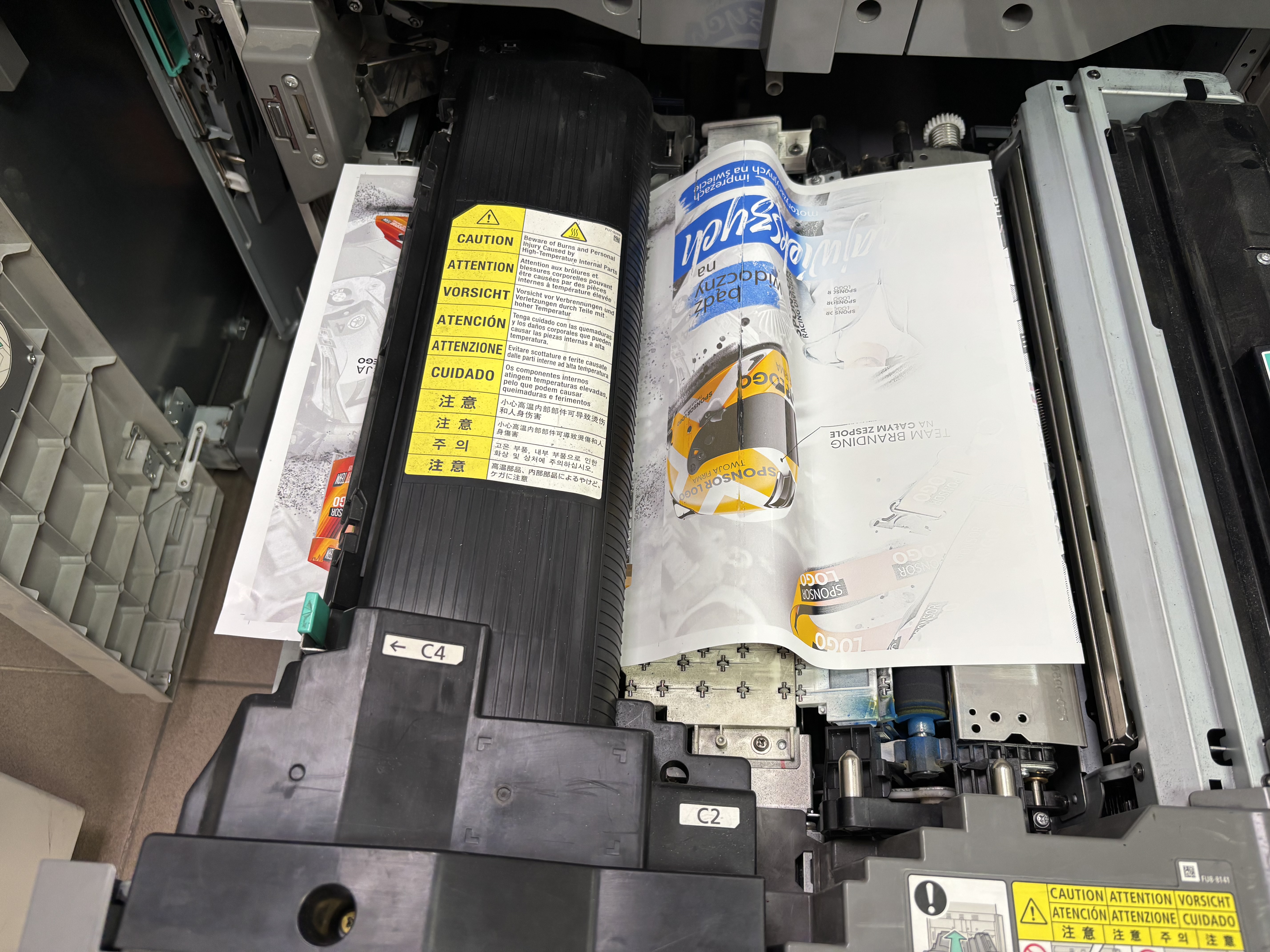

Hello,
for several months I have been struggling with the problem of jams in the imagePRESS C650 machine. When printing from the C1 lite deck, the sheet stops during fusing (I have attached a photo). The machine works without a jam from the other drawers and feeders. When the machine is "rested", it makes the first 20-25 sheets without a problem even from the C1 lite deck, but during longer work it jams every few or every one sheet. It looks like the rollers pick up the paper, but do not start at the moment when they should feed it into the printer.
In the main machine I replaced both fusing belts and thermistors, the registration unit was recently replaced. In the POD Deck Lite C1: rollers, clutches, pick-up motor, and also the main board.
I have no more ideas and I feel completely helpless, please help me solve the problem.
