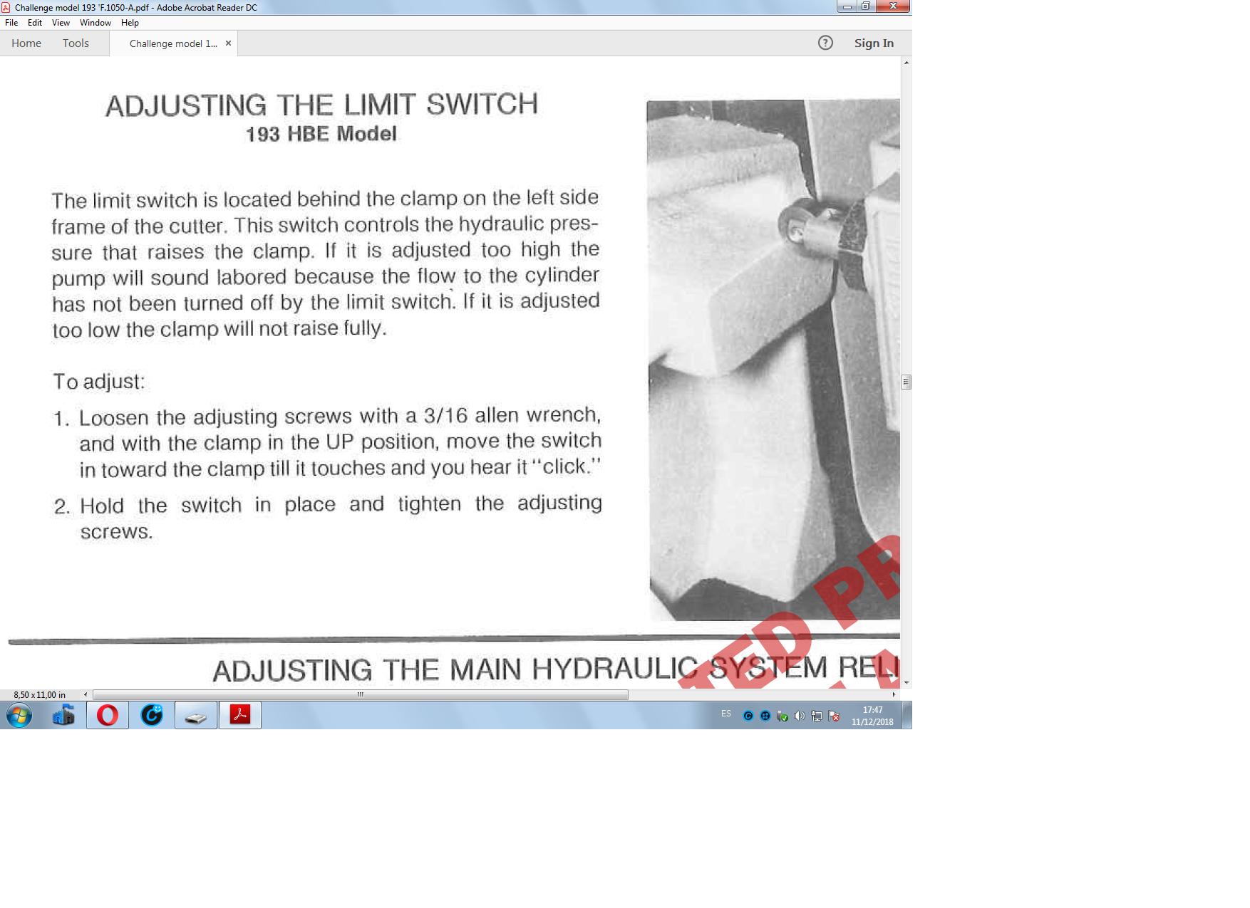

Hi sir:
Attached is there the screen shot for adjusting the limit swtich for clamp.
Of course please refill the hydraulic recipient, and bleed the air in the system, any air can cause
problem, and use the o.k hydraulic oil, according to user manual.
Let me know.
Blessing
[email protected]
