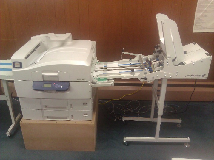

If you can find a used straight shooter your life will be a lot simpler, ours just keeps feeding our 7400 with no issues.

I did some further research and for anyone looking to do the same, it seems that only the Astro 2000-11 has the electronic sensor that you would want. Otherwise you just have to set a speed and try to time it well. The straight shooter and VIP feeders would also work, but they are hard to come by at the same price as a used astro.
Non window envelopes are fine, haven't found a window envelope that works yet. Print quality is good.
Check Western States Envelope... they manufacture a window specifically for laser printers.
Will do, every "laser compatible" window envelope I have tried so far in the 7400 melts. Fortunately most of our small run envelopes are non-window #10 anyway.
I have an Oki C9650 using the Straight Shooter Feed System. I was using the Western States Digital Envelopes but they changed the flap design to be straight instead of the point and then they would not work in my Neopost Inserting equipment, printed great but useless if you have to hand stuff. I now do a custom order through WCP Solutions, and I think they get them from National. Jams up a little more with the flap catching on the window, but I need them to work for inserting, cost was similar to Western States.
