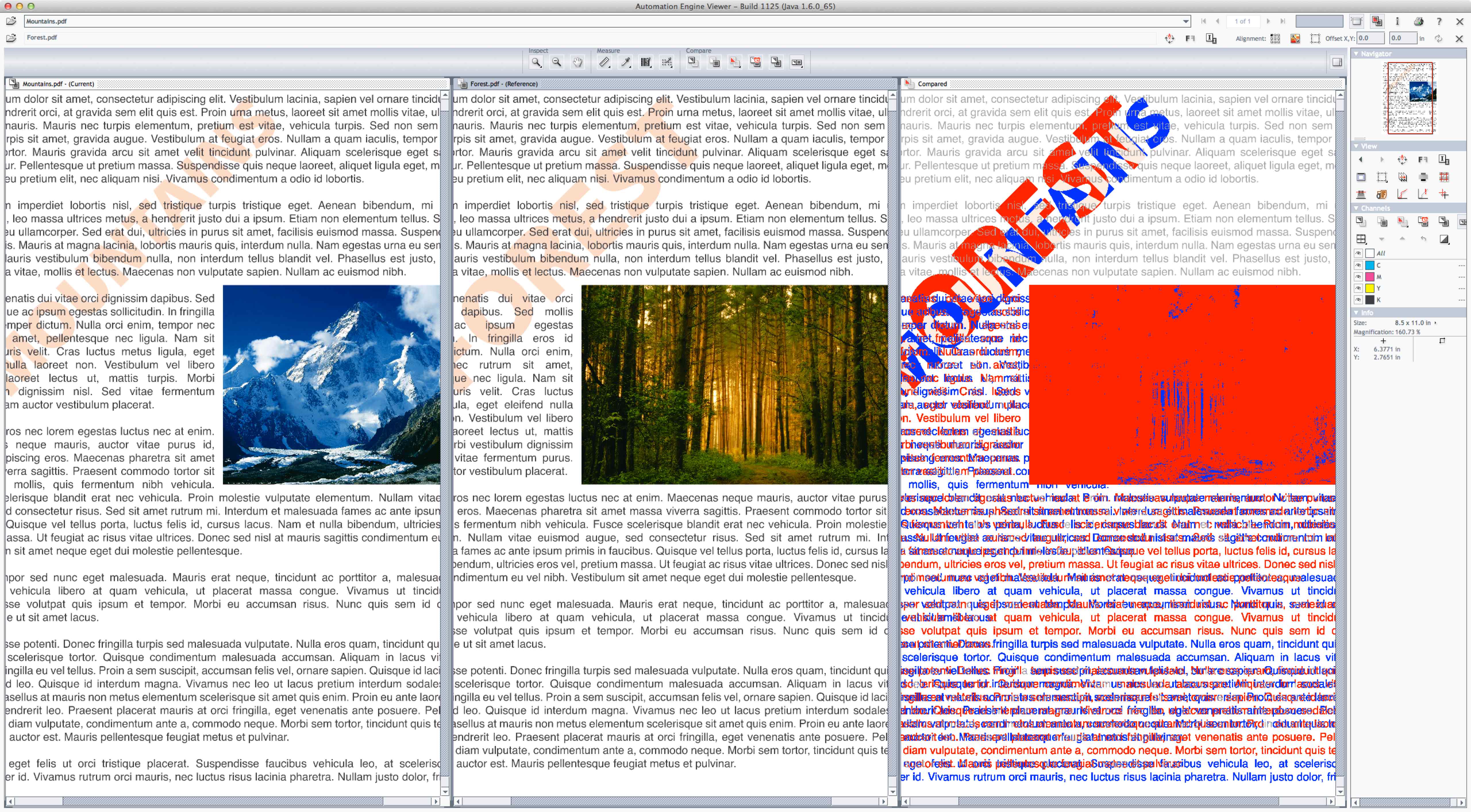

The automationengine viewer has a function that covers this: blink mode, difference mode and side by side modes. EXTREMELY useful. There doesn't appear to be a ticket to do this for you automatically and generate a report but perhaps that is in a module I don't have.
Hi Chevalier,
That sounds exactly like what I am looking for. Could you be more specific as to where I could find this feature? Is it because I'm using BackStage Pilot 7.6 and not Automation Engine?
Probably. See the attached screenshot.
