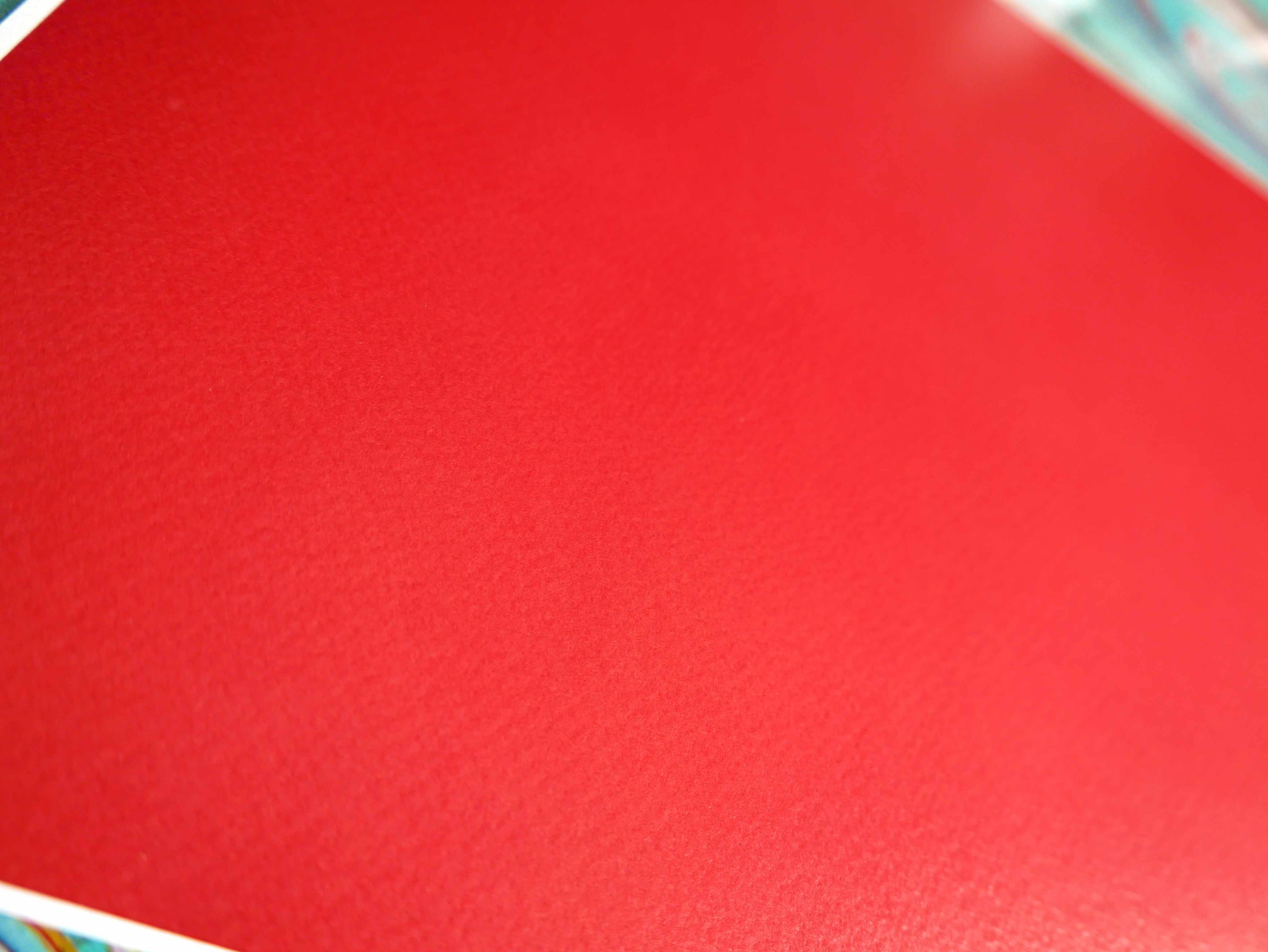

It would be interesting to see samples, especially of solid colours like you said with no banding

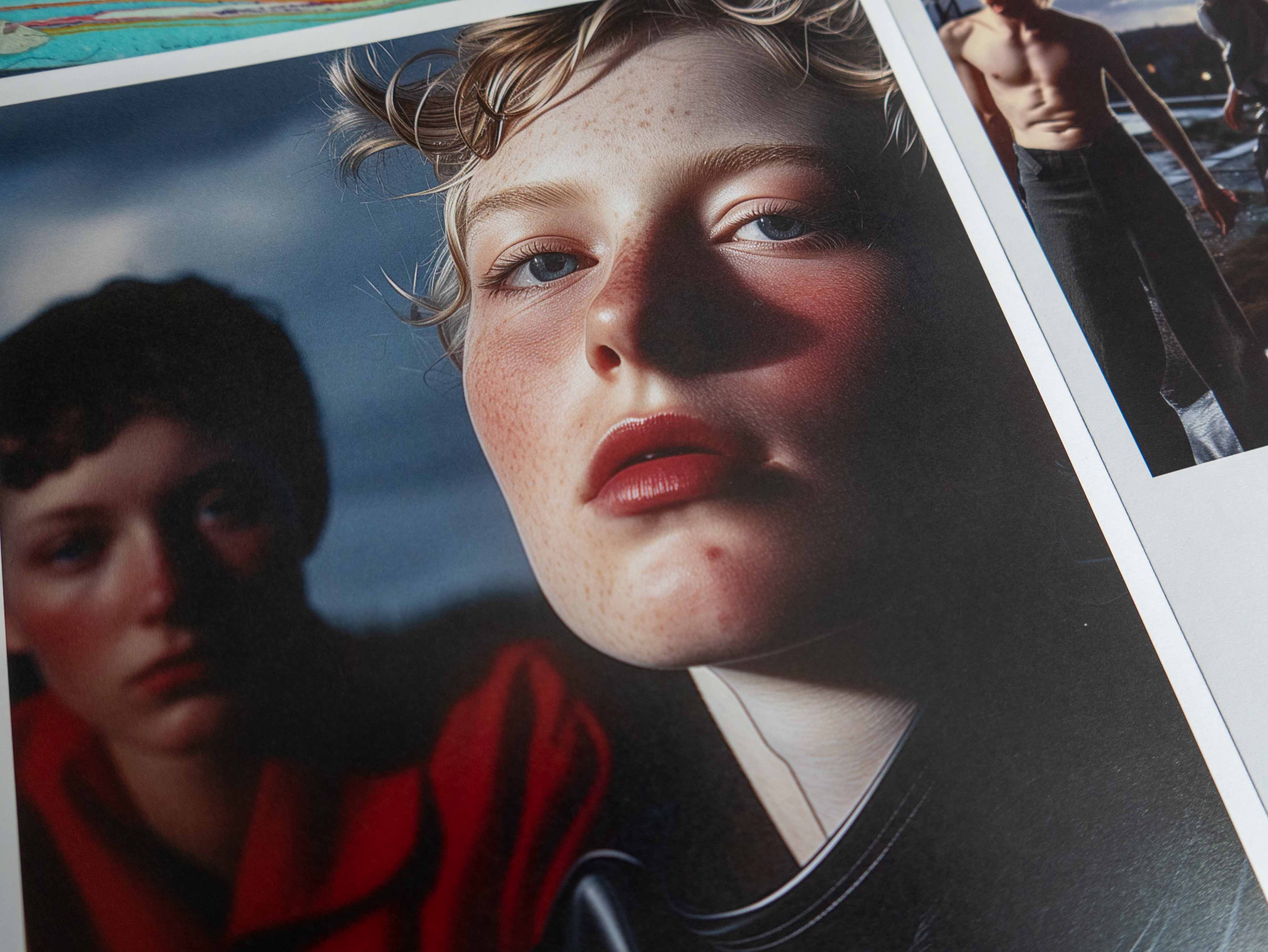

One other impressive thing is that the 7500 can print some media completely full page with full bleed. This only works on weights between 160 and 240gr with formats between postcard and A4+ but it's quite surprising.
I will post some picture later today to let you see how good it is :)

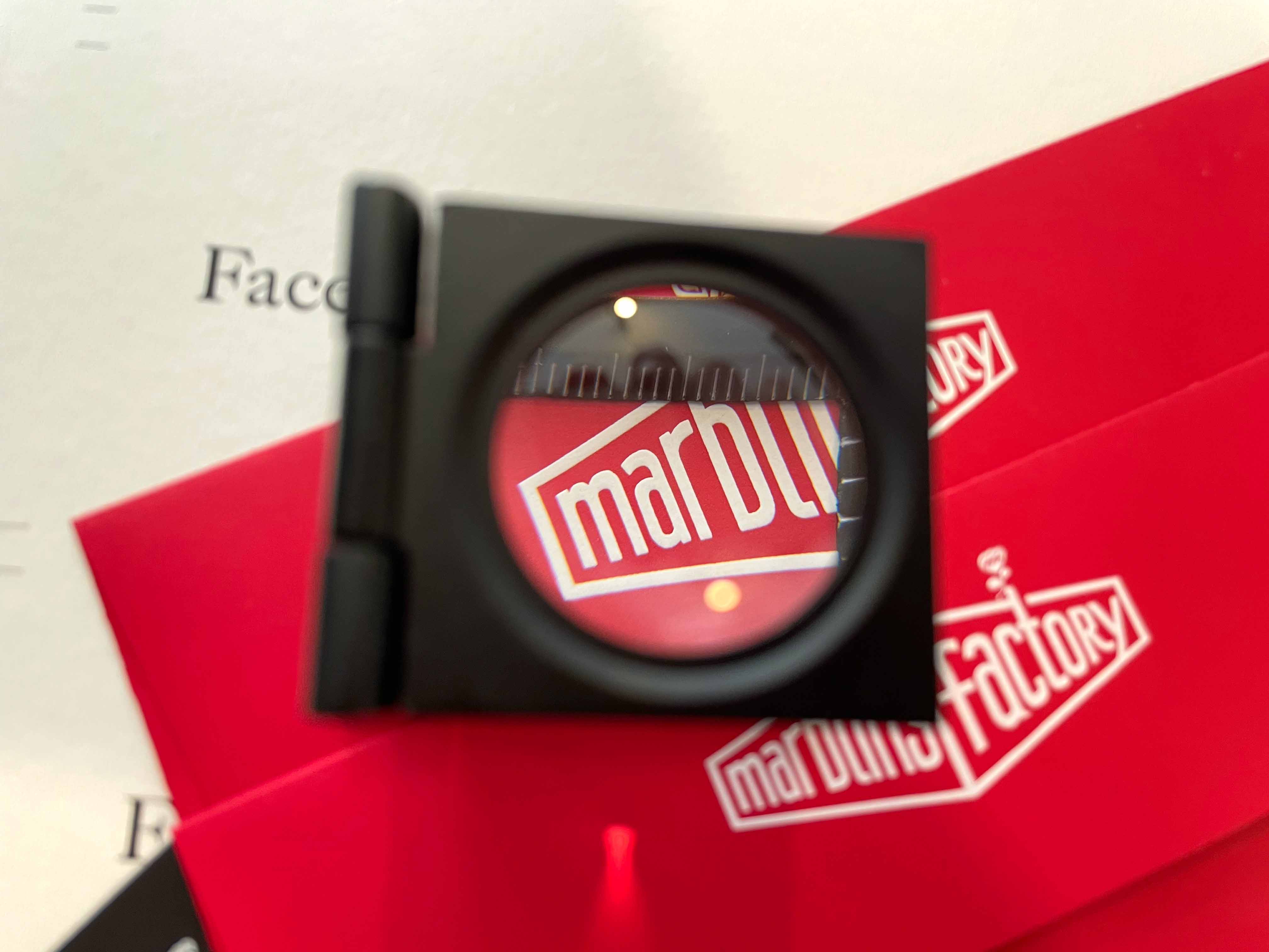

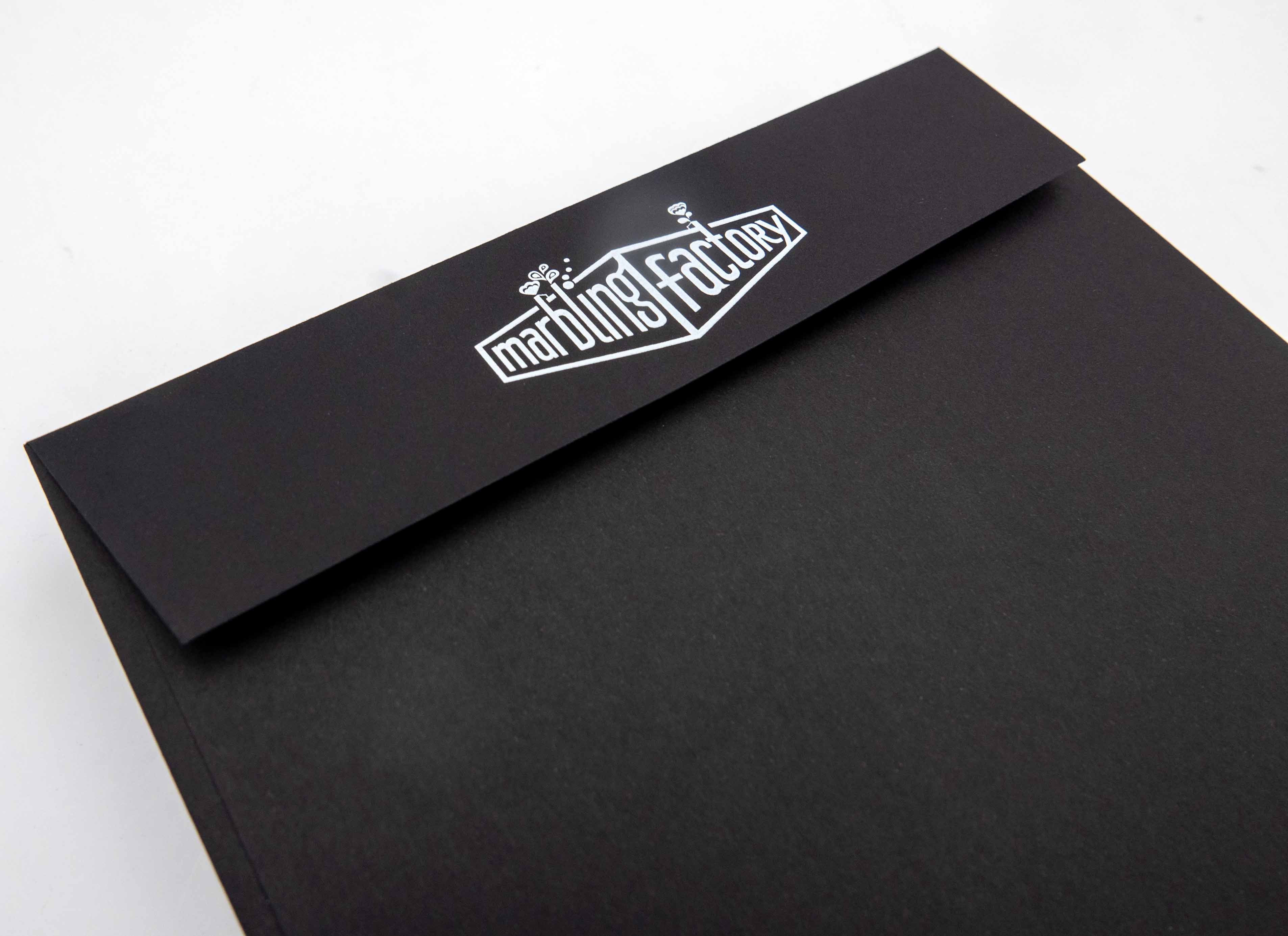

Here is some picture with two passes white toner for enveloppes.

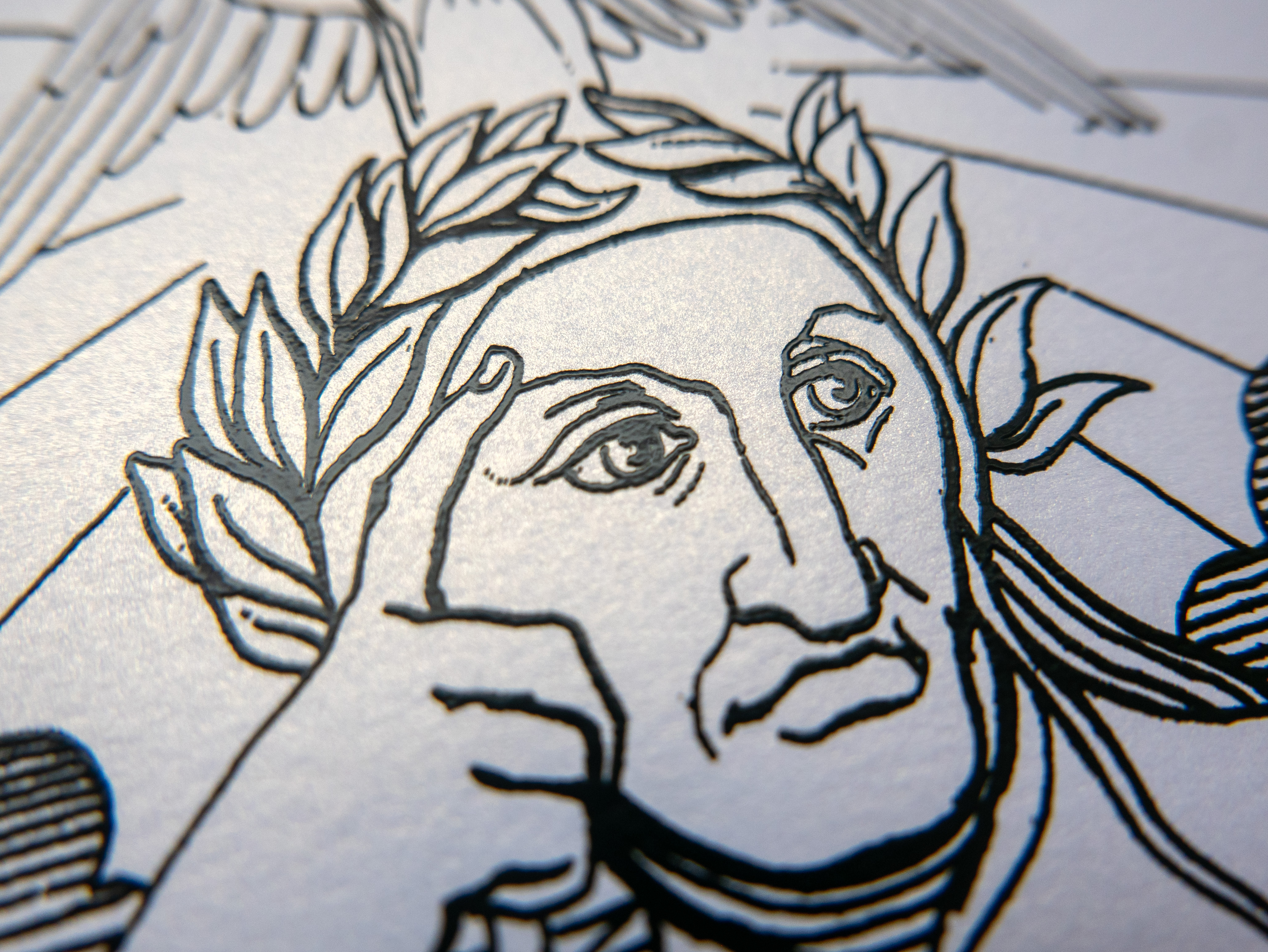

An example with silver toner on Fedrigoni materica Colbalt paper. It's a little harder to take a photo of due to the shine but the result is quite subtle.

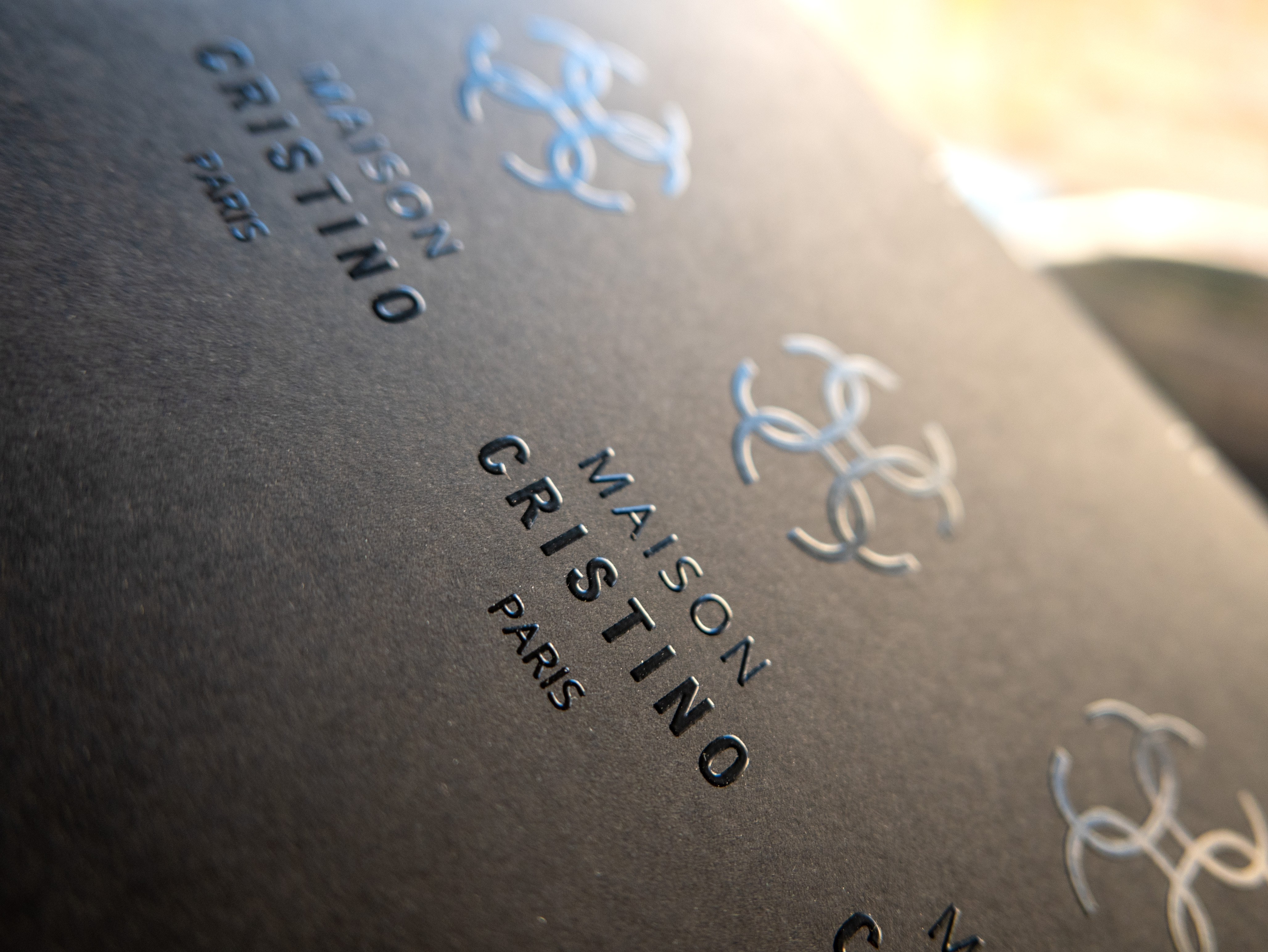

also an interesting application that I discovered with this press and that it is precise enough to be able to make several passes of the same impression and that this creates an interesting relief. I am providing you with two photos of prints that I had reprinted in black toner between 10 and 20 passes and the result is quite surprising

that is impressive, but what is the cost of 20 passes compared to a spot varnish?
