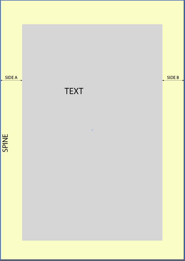

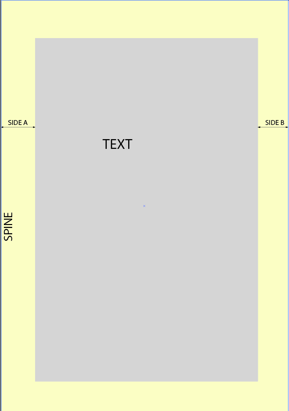

I’ve never used the creep option on any of the books I’ve printed. Mainly because I don’t know what it does exactly. When you add creep, does it squeeze the pages closer to the center? Is it done trough the fiery? Sorry for the lack of knowledge
Hi Robohoper,
This is why we need Creep in a saddle stitched book. With CREEP side A and side B are equal, without CREEP side B is less than side A.

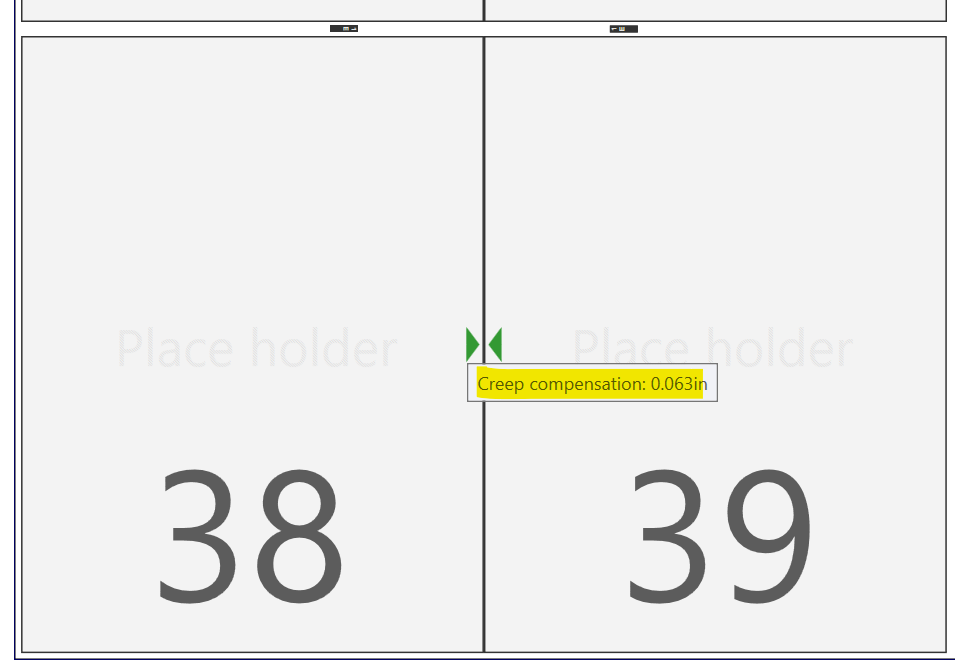

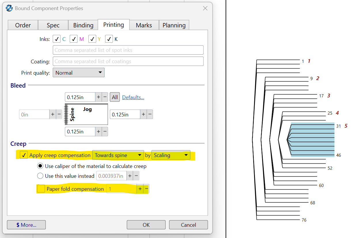

Hi, creep will be max. on the center pages and it will reduce to 0 on page 1,2 and second last, last page. To calculate creep minus 4 pages (first 2 and last 2) from total page count, then divide by 4,, multiply by paper thickness. In your job, 76-4=72/4=18*0.0035 = .063in should be the creep compensation in the innermost pages - 38 and 39.

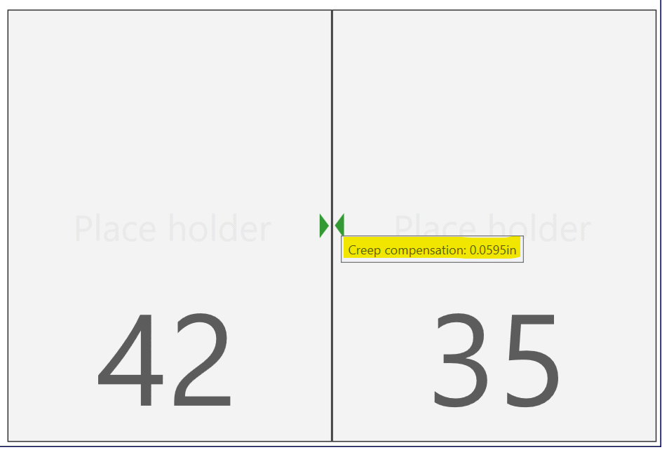

The creep will go on reducing as you move back to starting and end pages. In below image page 35 has 0.0595in creep.
The creep can change if your folding machine has wear and tear, with folds not sharp. In that case you need to add compensantion factor.
We use InSoft Automation's Imp software with controls to define creep as per design and by moving or scaling content. It also offers settings to enter compensation factor.
Hope this helps.
