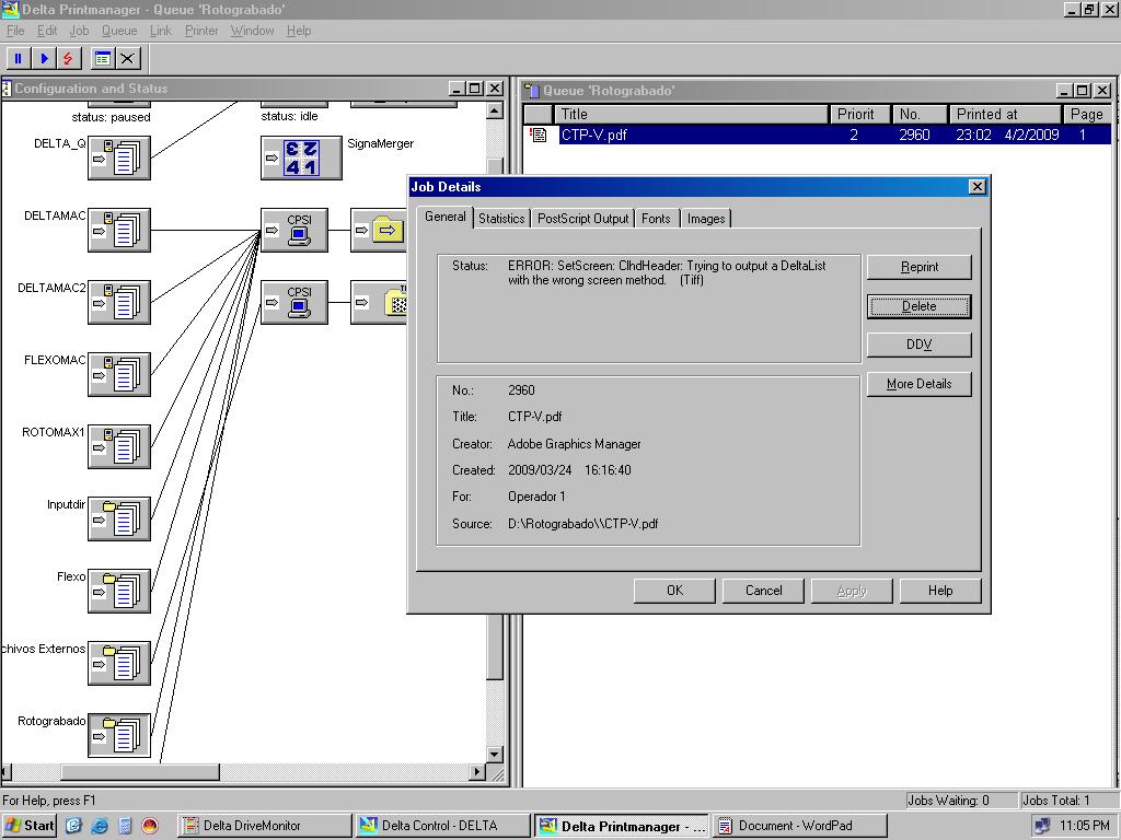

1. It seems that files that are process with the gravure dot option can´t be sent to tiff catcher ( I get an error message, See pic), is there a way that I can fix this?

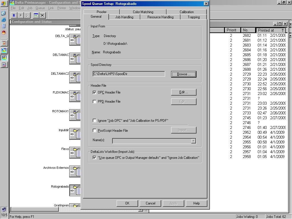

These are the steps, I am doing at the moment with Delta rip when I setup a Queue.
1. First I go to the Setup of my queue, in my case I would setup the one that is called
"Rotograbado" (See pic 1)
2. In the setup as you can see in pic 2, y have checked the options of OPC Header File, and the other one "Use queue OPC or output manager deafaults" and Ignore Job Calibration".

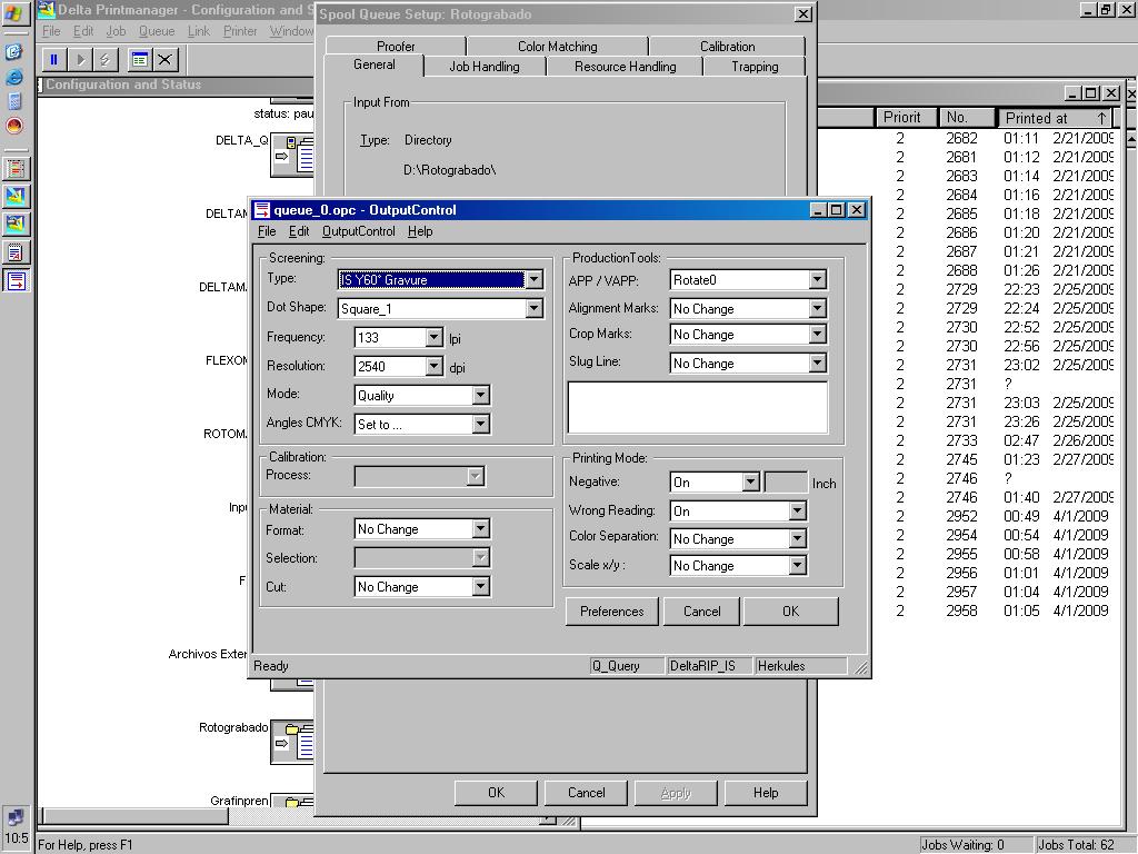

3. Now I go to edit the OPC Header files, where I choose the Type of screening in this case I want it with Gravure Screen (See Pic 3)

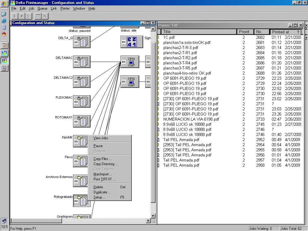

5. And now I will send it to Tiff Export (See Pic 5)

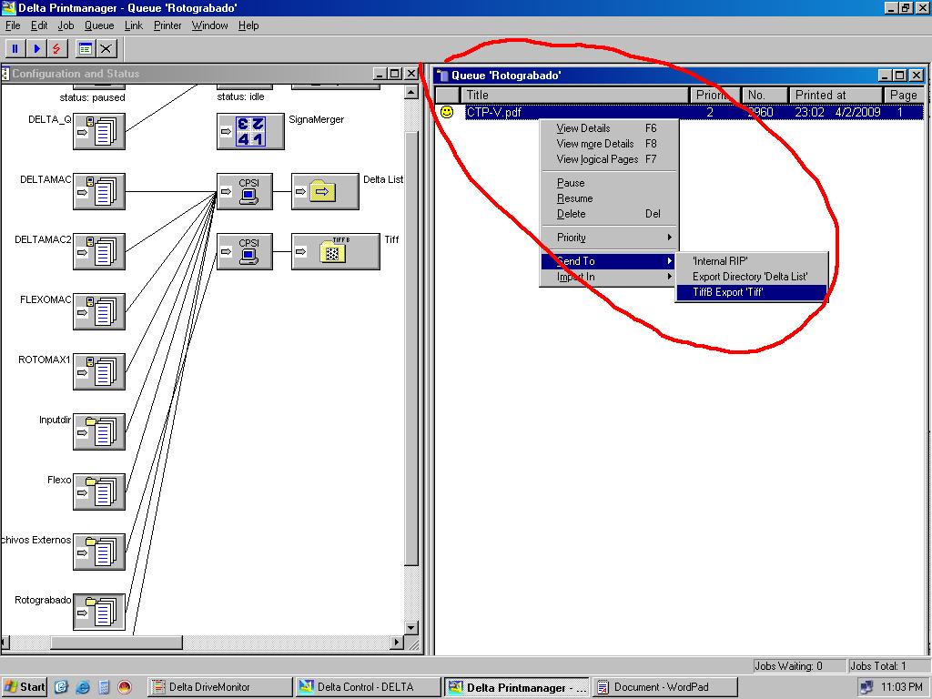

6. And I get this error, which is the same as before. ( See pic 6)
