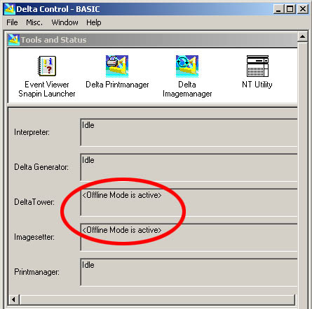

Dear all,
I have a problem on the "basic hercules".
Basic Control on Delta, Delta Tower and Image setter written OFFLINE MODE IS ACTIVE.
please help, thank you
Best regard
hello
first check SCSI cable behind the tower than SCSI board in the PC.If those are ok.During startup Pc check 1 and 4 address on the screen.If all are ok probably the tower boards are defect.
