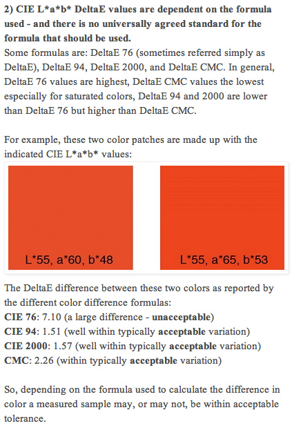

For those who didn't "get" that part of the strip - see the attached clip from my blog. There's a reason why vendors and printers might use different formulas to calculate color difference (and not let you know).
