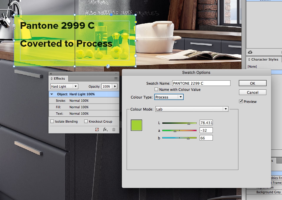

Ah... that's a bit reckless! Looks like Hard Light just doesn't work with spots. Will this spot colour be printed as spot? I've had a quick play around and it looks like converting it to process yields the same appearance as the misleading one you get without Overprint Preview.
Ignore the text in the box, one of them is still spot...
