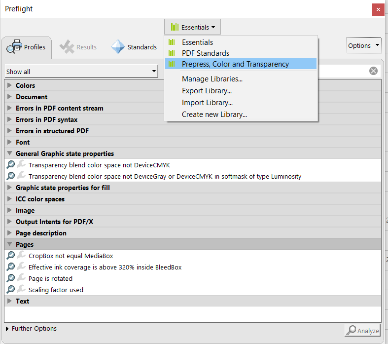

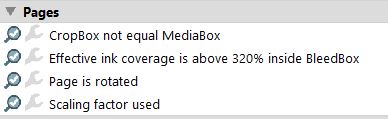

Ynot_UK
Open the pdf in acrobat -
- Print Production - Preflight
- Magnifying Glass (top centre)
- Pages
- Page uses other colorants than Black
Run this and it will give you a page count for colour and black.
I've not got that test in my "Pages" menu :(
