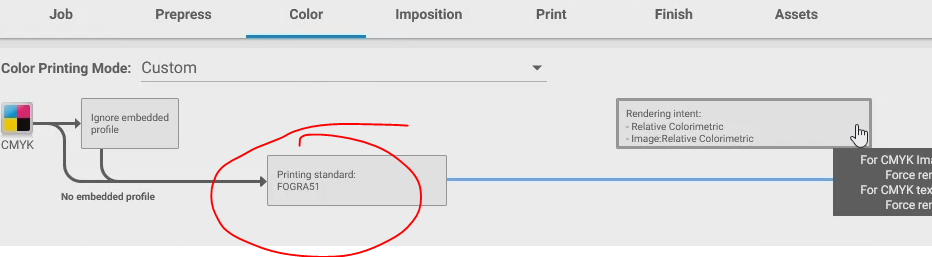

is there an internal color management preset i can do to ensure i can produce identical output from an indigo and an offset press. if i print icc chart and read using i1, can i input this to photoshop and have digital to offset conversion of the images?

Is your offset press printing to a standard (eg FOGRA) If so, you should be able to match the same standard on the Indigo.

yes the offset print qualifies to the fogra values. just would like to take away the guess work in creating indigo proof that will serve as basis for offset masspro. thanks

On the Indigo, select the appropriate FOGRA standard as the printing standard
