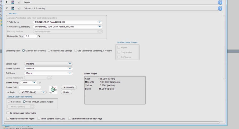

Gordo,
I have also suspected it's something going on with the plate(s). But I wanted to confirm that my Prinergy settings do have Magenta @ 105 degrees (see attached).
We do not see specs or artifacts in the non-printed that I am aware of. I have a microscope but not a USB camera (going to be buying one of those tomorrow).

Gordo,

Magenta at 105° is very, very, odd. Typically Cyan occupies the 115° angle and Magenta the 75°. These are sometimes swapped. But 105° - weird. I would try and find out why Magenta was set there. In any case that would have no effect on speckles - moiré yes, speckles no.
