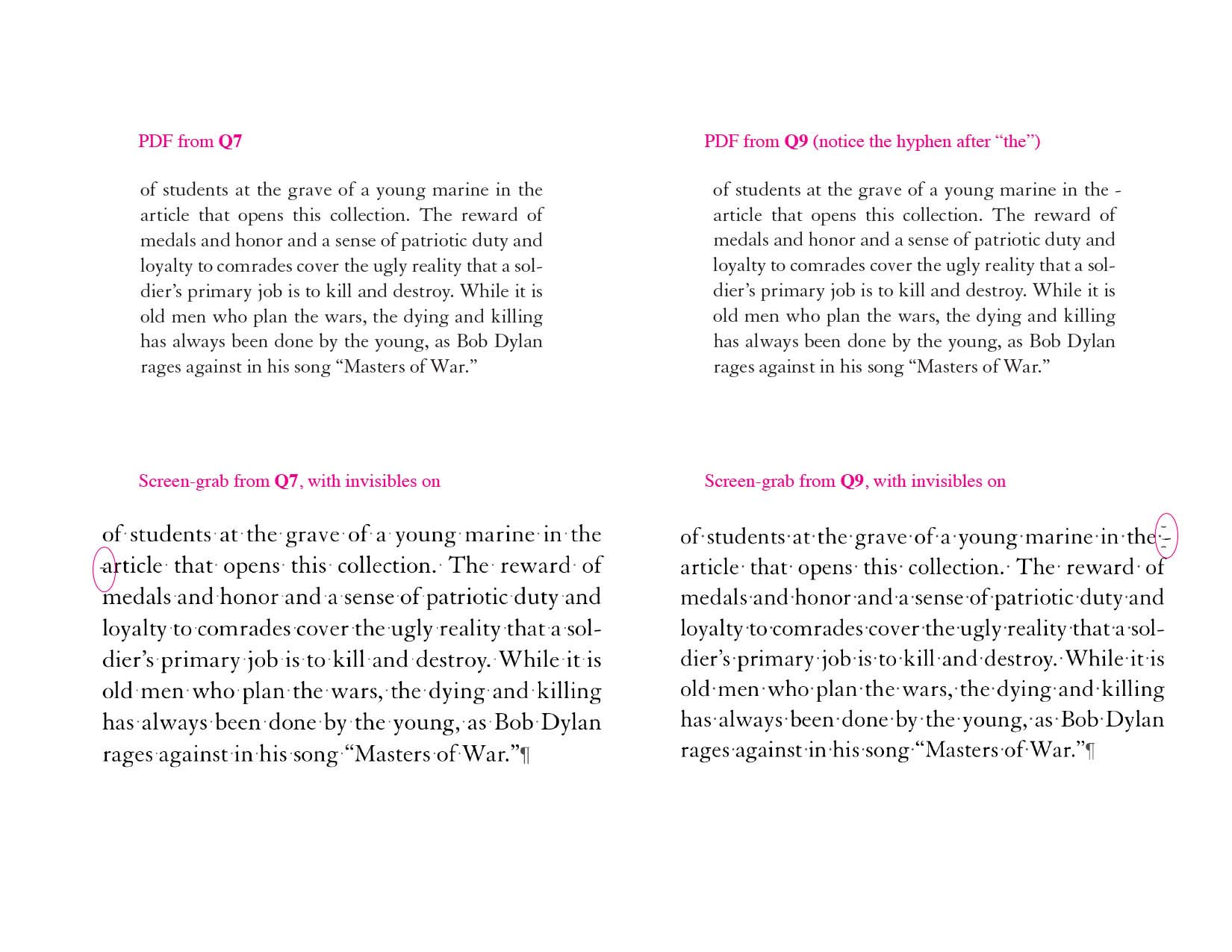

I've just encountered a major issue with discretionary hyphens in Quark 9.
A book interior, that was originally set in Q4, needed to be edited for an upcoming reprint. When opened in Q9, many of the discretionary hyphens that were added to the front of a word were changed into actual printed hyphens. This would occur with any word that was the first word in a line of text. The printed hyphen would appear at the end of the line of text directly above the word with the discretionary hyphen.

I played around some more with this and am still lost. I opened the file in Q7 and it behaved properly. I no longer have Q8 on any of my computers, so I can't test that version.
I have attached a screen-grab which should help better illustrate the problem I am having.
