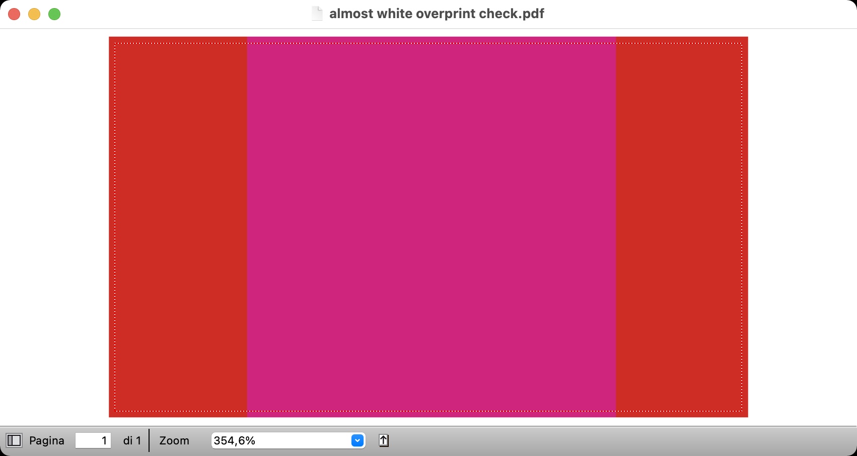

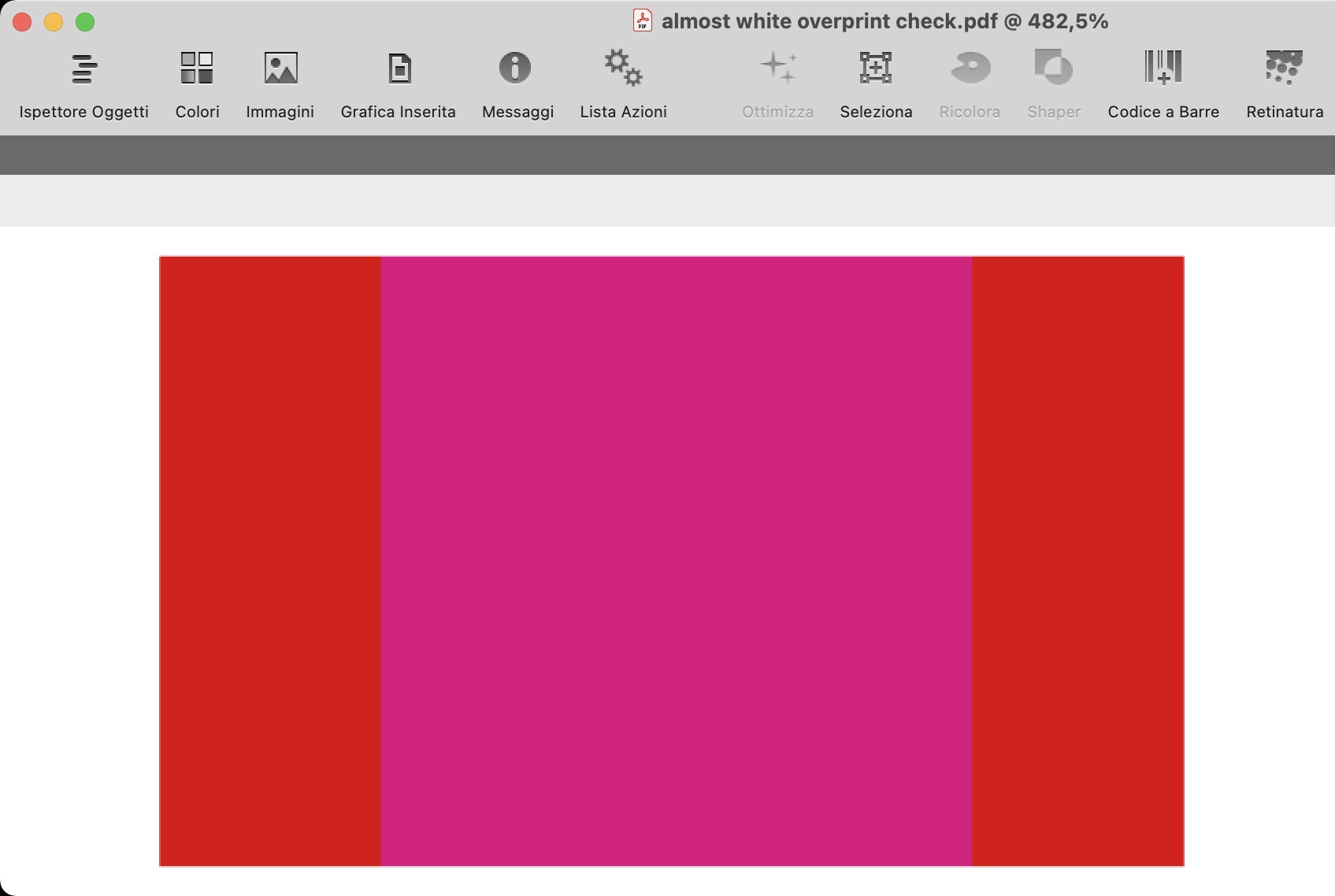

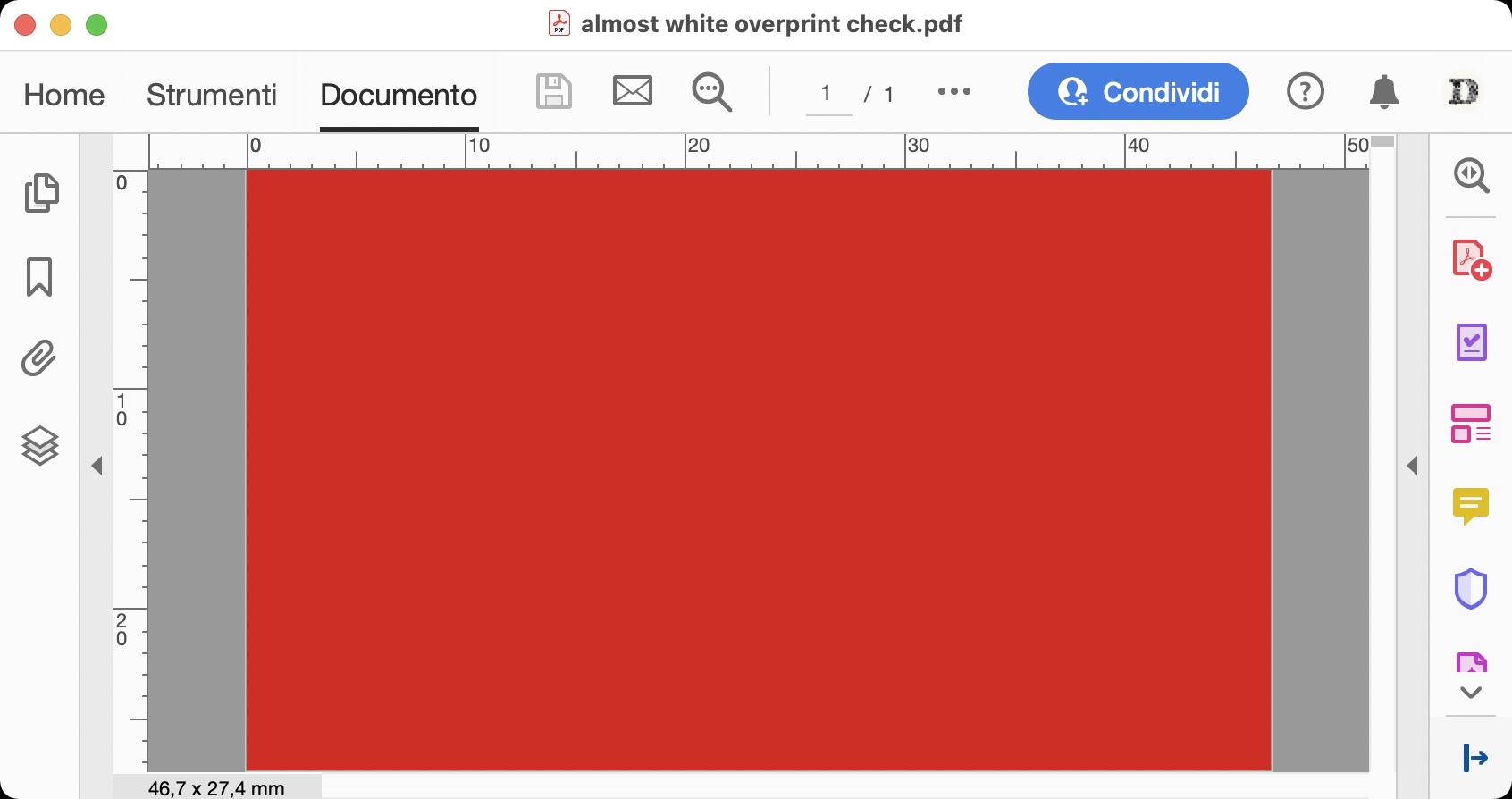

I have a pdf which is shown in 2 different ways: in Acrobat (and also Illustrator) I see it as I would like (full red) while ArtPro+ and PackZ show it differently (red & magenta).
It's simply an almost white object overprint over a colored one.
Does anyone want to help me understand what it depends on?

I would say that Acrobat views the file properly and the other two products do not. How does the file attached appear in ArtPro+ and PackZ?

I've already posted screenshots for all the three situations - Acrobat, PackZ and ArtProPlus - in my first post.

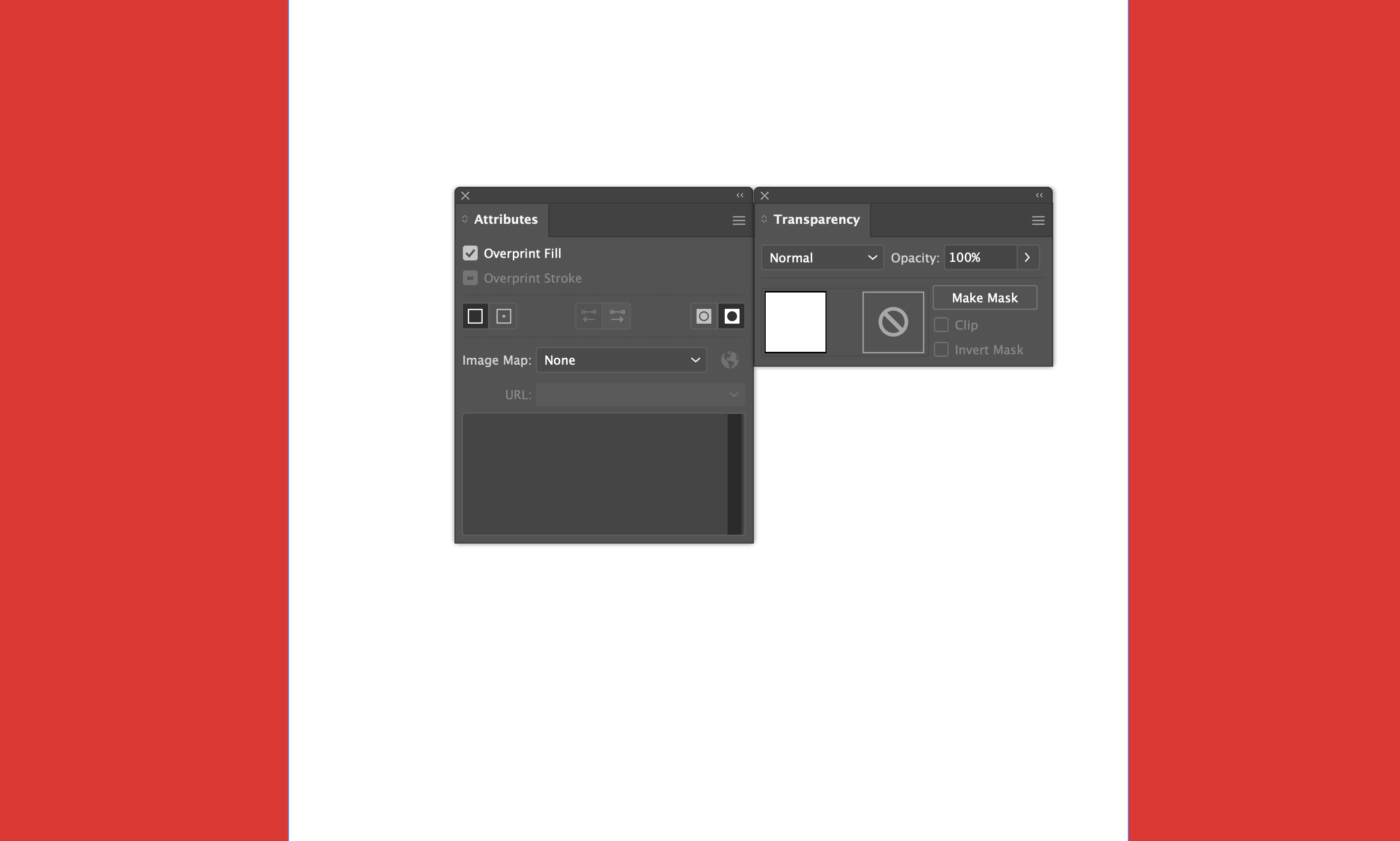

Instead of a .1% Yellow box set to overprint 100M 100Y,

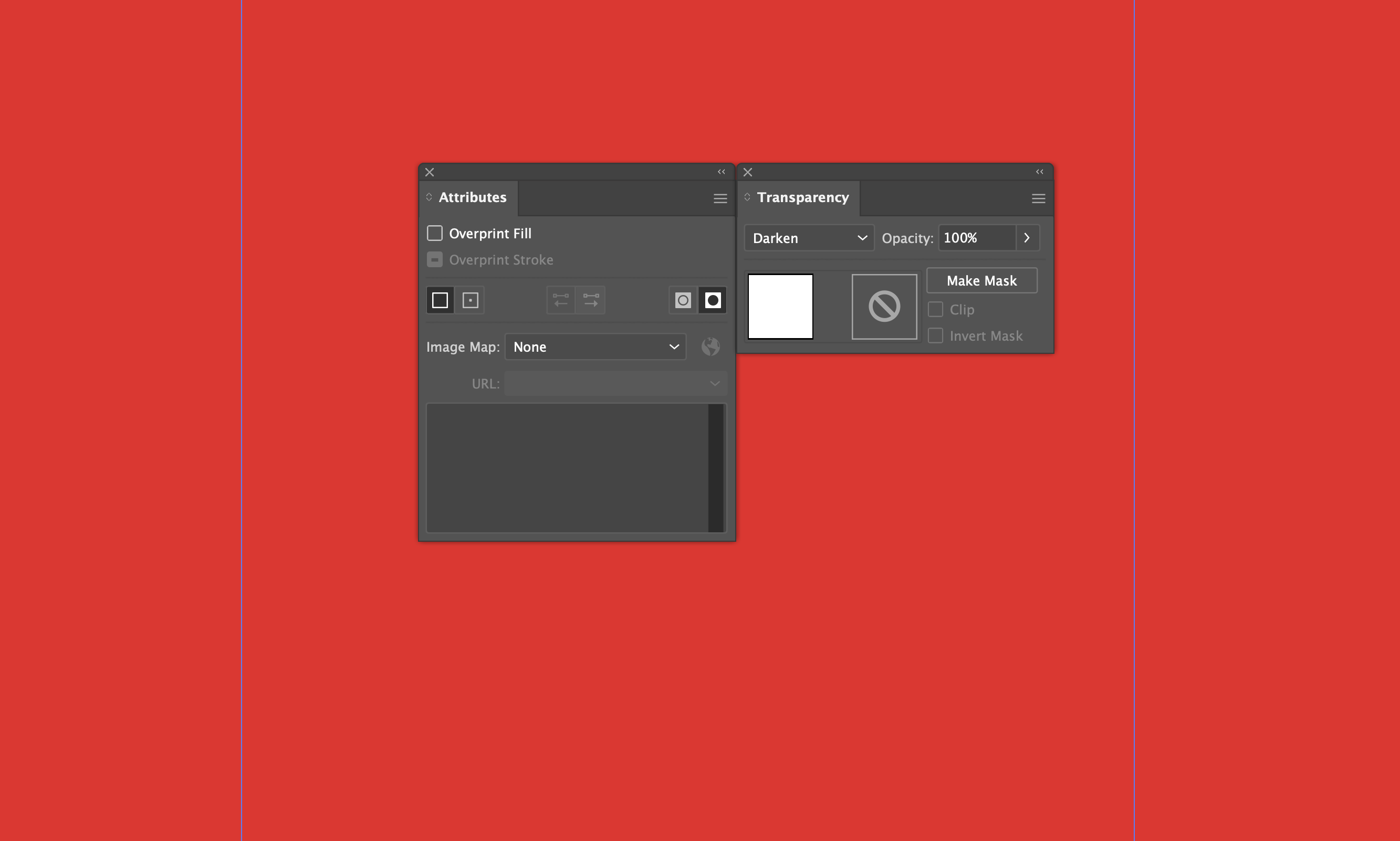

Maybe try a .1% Yellow box set to darken (or multiply).
Artpro+ seems to be using the yellow value from your .1%Y box and overriding the 100% yellow underneath when the illustrator file is set to overprint.
I get a more uniform preview of this file across different applications using darken.
I'm still not exactly sure why anyone would need an (almost) white box to overprint 100M 100Y ...
It seems like just deleting the .1%Y box would have the same effect.
