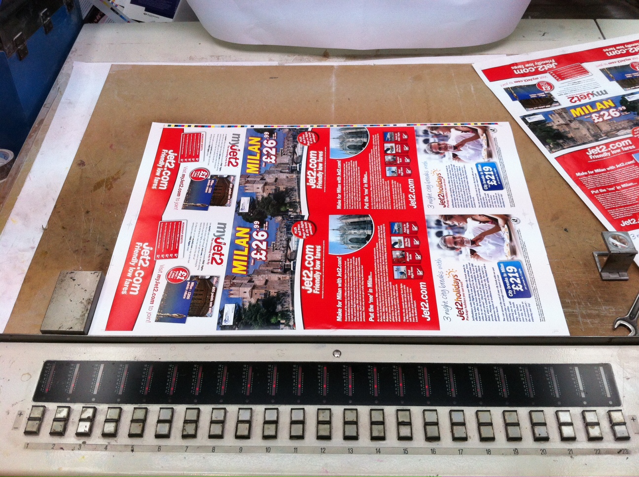

If I've uploaded it right, this should show it.
Thanks.

OK guys, Now I've brought your responses to my printer and questioning him more closely I reckon there are two unrelated issues here, and the problem is not as I described.
One is that when setting the keys some keys open up so far and no further. This sounds like those keys are gunged up with ink and a good strip down and clean will sort the problem, so I'm not concerned about that.
The other, distinct problem is that on unit 4 only there are 4 adjacent keys which shut down completely on the run. It is always the same keys and they don't open up at random, they only close down. This happens about once a week or fortnight. That unit has been cleaned out. Would this be relevant to what you have identified, Francois?

Leeds, If four consecutive zones are malfunctioning, the problem may be originating at one of the ribbon cables or their plugs or the boards they plug into, both at the CPC console and at the ink fountain itself. Try swapping ribbon cables at the affected distributor board in the fountain with the adjacent cable, etc... or, with any luck, a cable may have a poor connection and simply unplugging and plugging back in will remedy the issue. Good Luck
