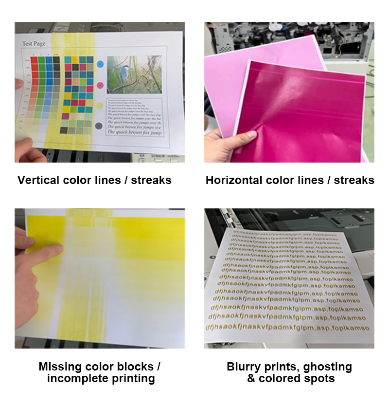

Different types of lines point to different faults. Check the table below to match your problem and jump to the corresponding solution directly.
Defect TypeTypical Appearance
Vertical color lines / streaksSolid colored vertical stripes running from top to bottom along the paper feed direction
Horizontal color lines / streaksColored horizontal stripes across the page, usually appearing at fixed intervals
Missing color blocks / incomplete printingCertain colored areas fail to print properly, either in fixed positions or randomly
Blurry prints, ghosting & colored spotsFuzzy color edges, double images, or random colored smudges and dots on the page`
