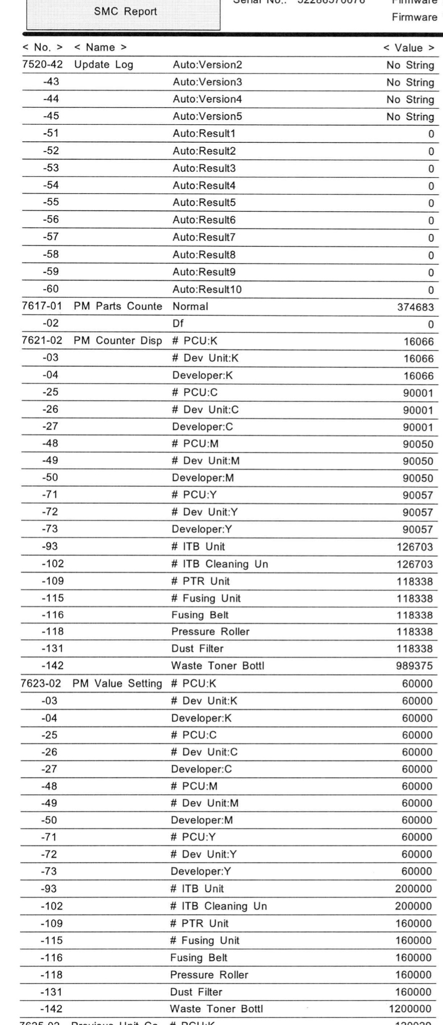

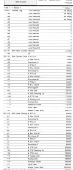

There is an internal report you can generate that will give you specific counters to know how much of your drums, transfer belt, used toner cartridge etc have been used.

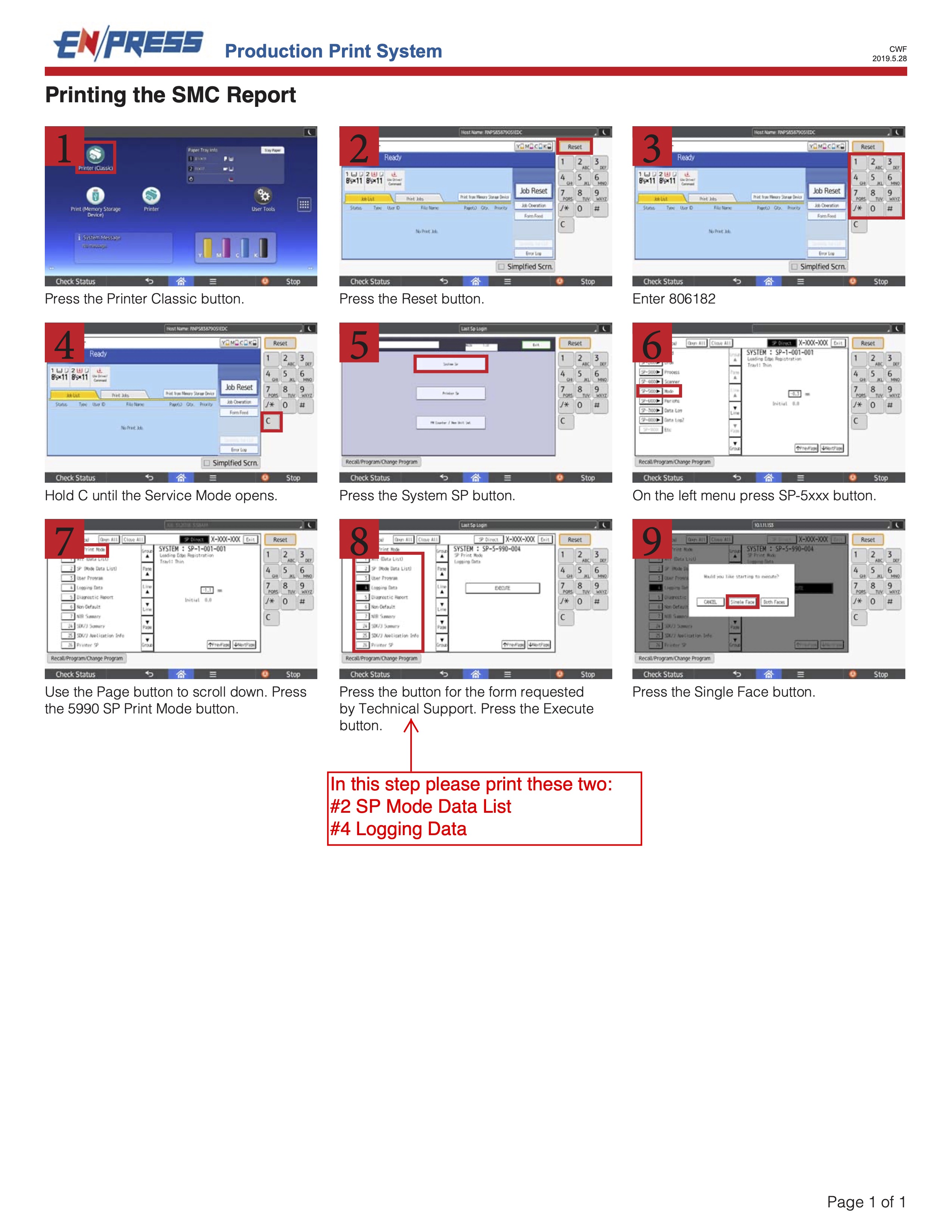

See the attached Pictures to generate a report on your own printer. Put 20# bond 8.5 x 11 in tray one as this will print out. If you don't want to waste paper or time, just put 5 sheets of paper in there,
because everything you want to know is on PAGE 4 of this report.
Under 7621-02 PM COUNTER DISP: it will show usage for drums. K=Black, C=Cyan, etc. Be sure when changing color drums all 3 are changed at the same time as that is how the internal counters work. They reset for Black when a new Drum in inserted, it blows a fuse inside the drum to reset the counter values.

-select classic printer view
-hit "reset"
- type in "806182" then hold down C
-select "PM counter/ New unit set
-select "Remaining days usage"
- press yes under "new unit set" to the parts you want to clear
- restart the machine
Alert might come up once it restarts but it will go away in a few minutes
