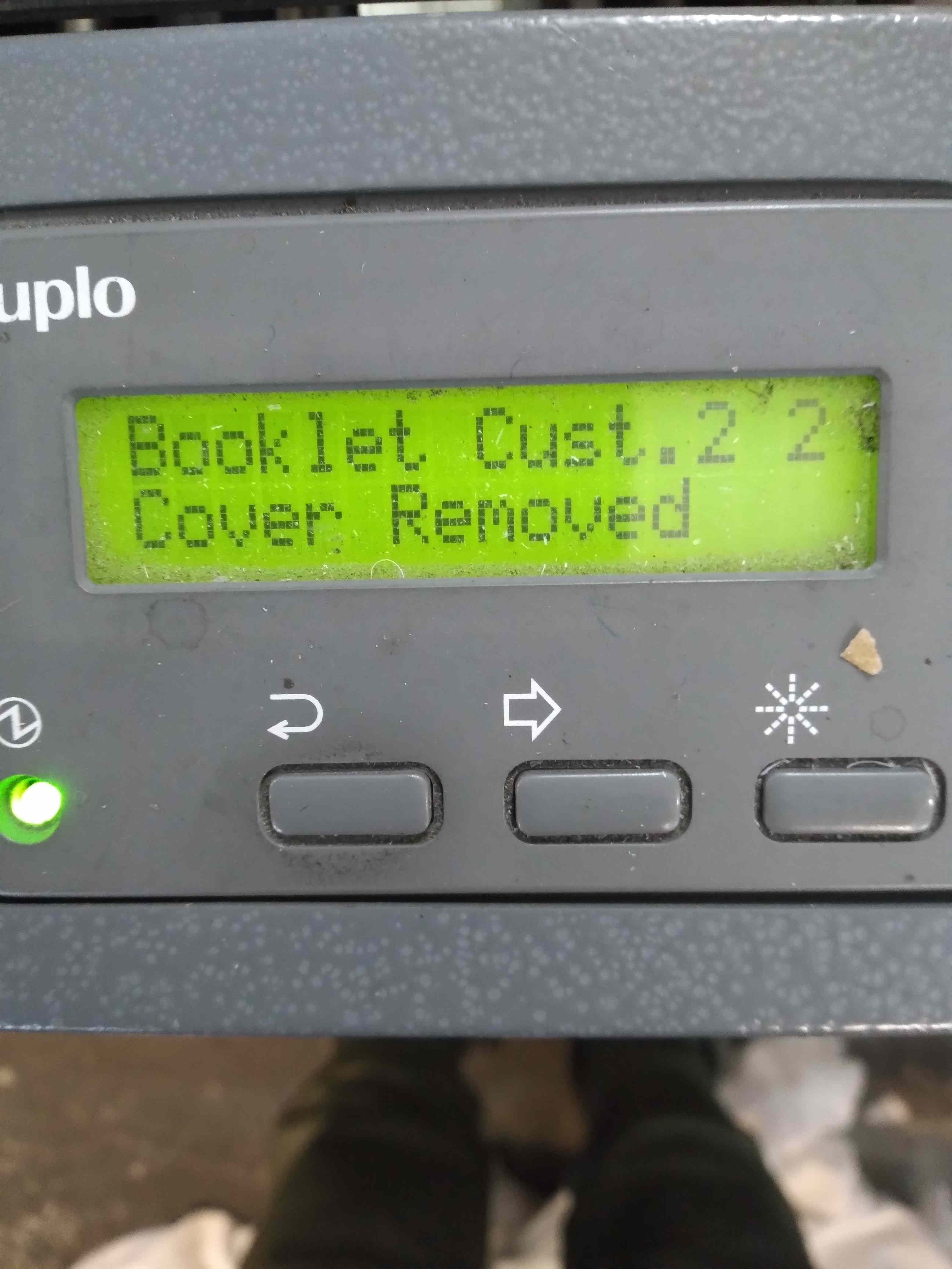

Hi there. Just a silly little problem. See attached. I had to pull both the side covers off my old DBM-120.
Obviously I have now put back. I have turned on and off. Pull power cord out. I'm guessing there is a mico sensor somewhere?
Any thoughts much appreciated. thanks Simon

I believe there is a microswitch at the bottom left inside of the front (operator's side) cover. Maybe it's not fully depressed? See the attached page from the parts manual.

thanks Stickman. I'll check it out. ta Simon
Also the big red emergency stop will cause a cover error. Also maybe you had 2 errors and 1 still is causing it to fail.
