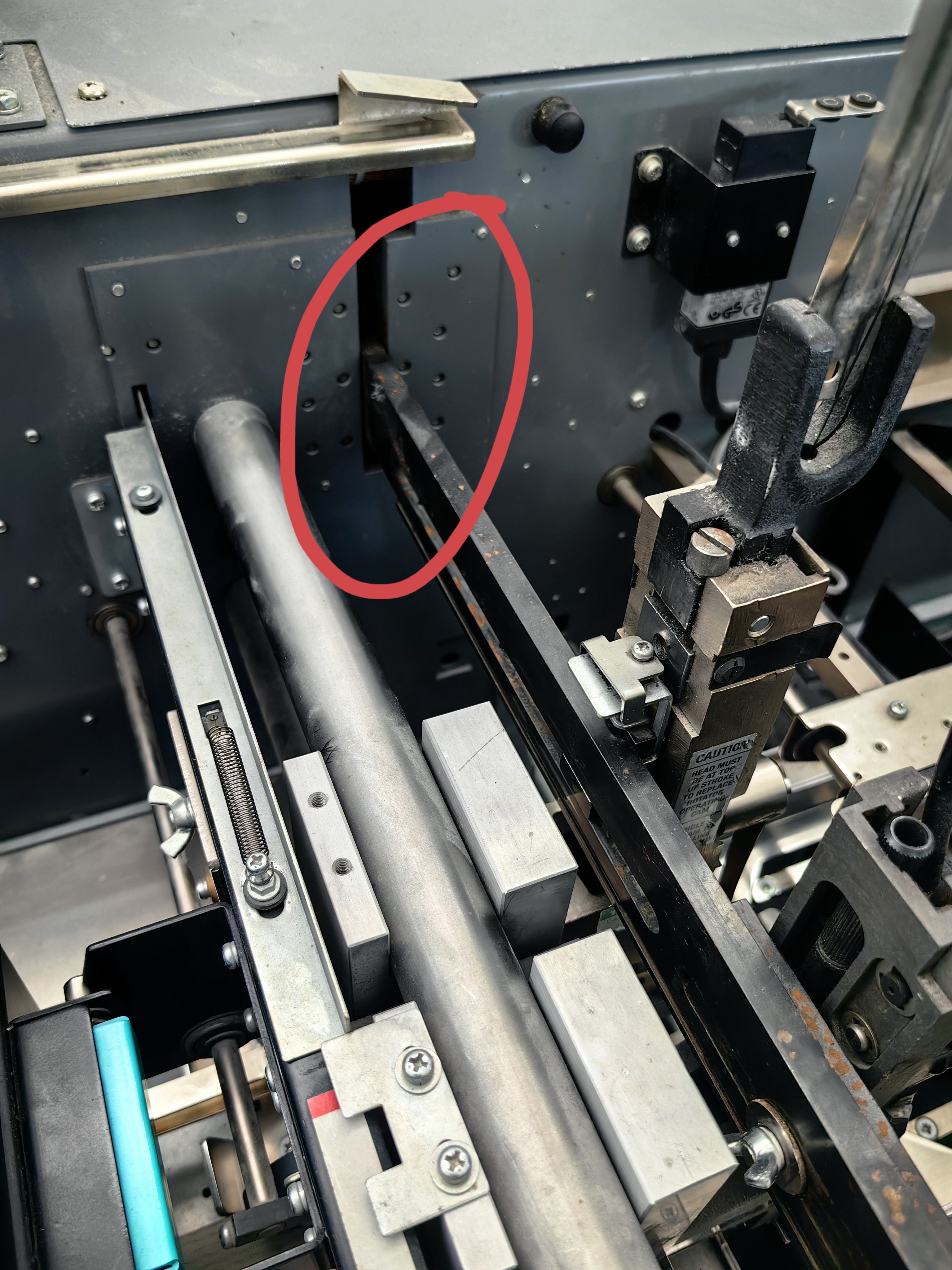

does anyone have experince woth error E72 on Duplo DBM-500 machine!?
As you can see on photo, our machine makes 2-3 pieces perfectly brochures but than machine simple stuck. When machine stucked you can see on photo in red circle, this is position where shaft stucked. So, this shaft do not returned back in home position until we shut down machine and make new adjustment of DBM-500 unit...
When machine stucked our brochure is still stitched perfectly, but shaft do not move back in-time and whole machine turned into error E72.

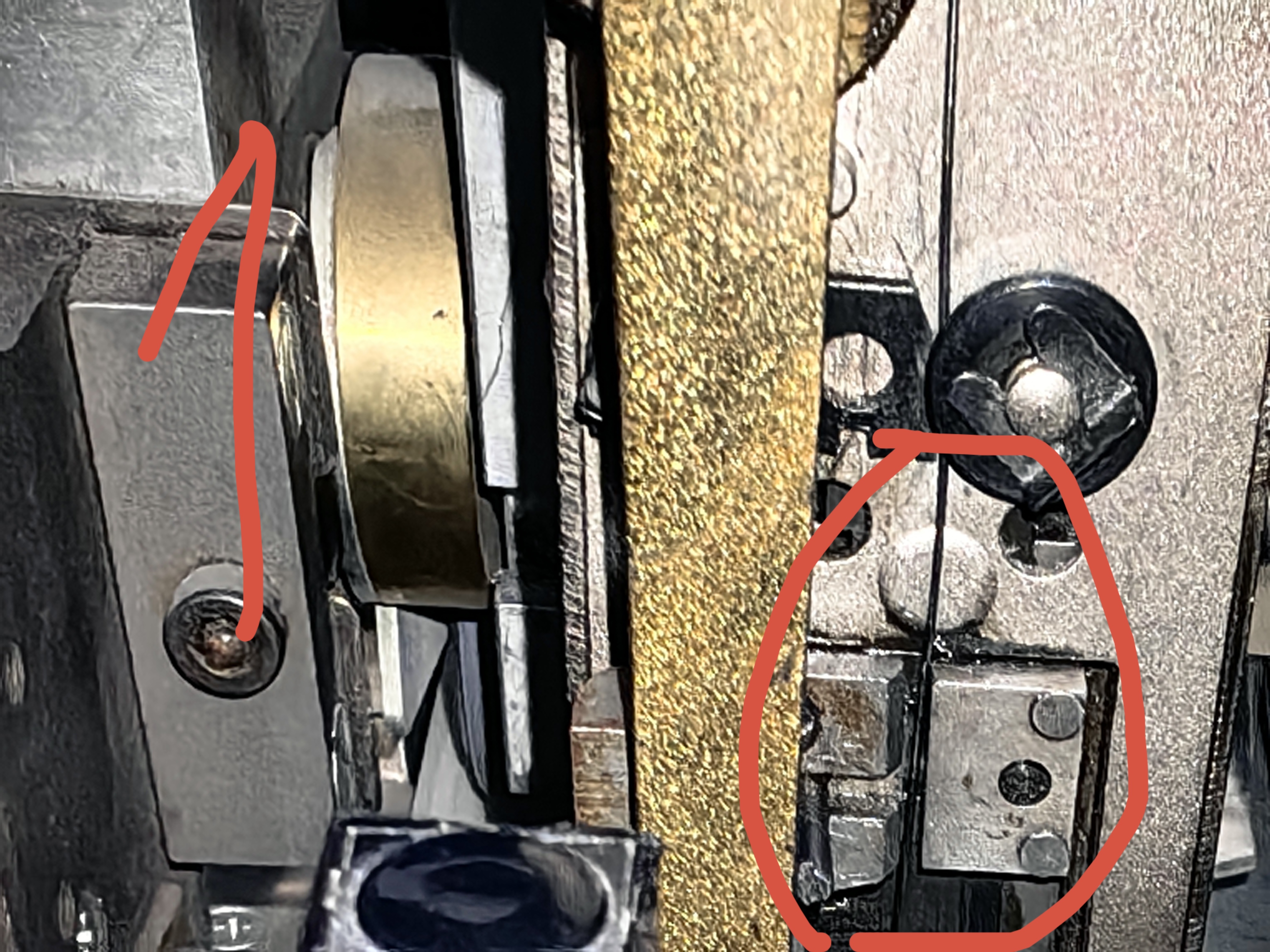

But when you tell to remove stitching heads everything works perfect. My machine have Hohner and Magnatek heads, it is 2 different heads in machine right now. I removed only Magnatek head and with only 1 pcs. Hohner head everything works nice. So I decided to see what is happening with Magnatek head because in past I have had a similar heads in old Horizon machine.
So, in final I found what is happening when machine works regular. After last good stitched brochure, stitching head looks like attached photo 1. You can see on photo 1 that wire is not squeezed fine. If I just put new brochure in machine than it will fail and turn machine into error.

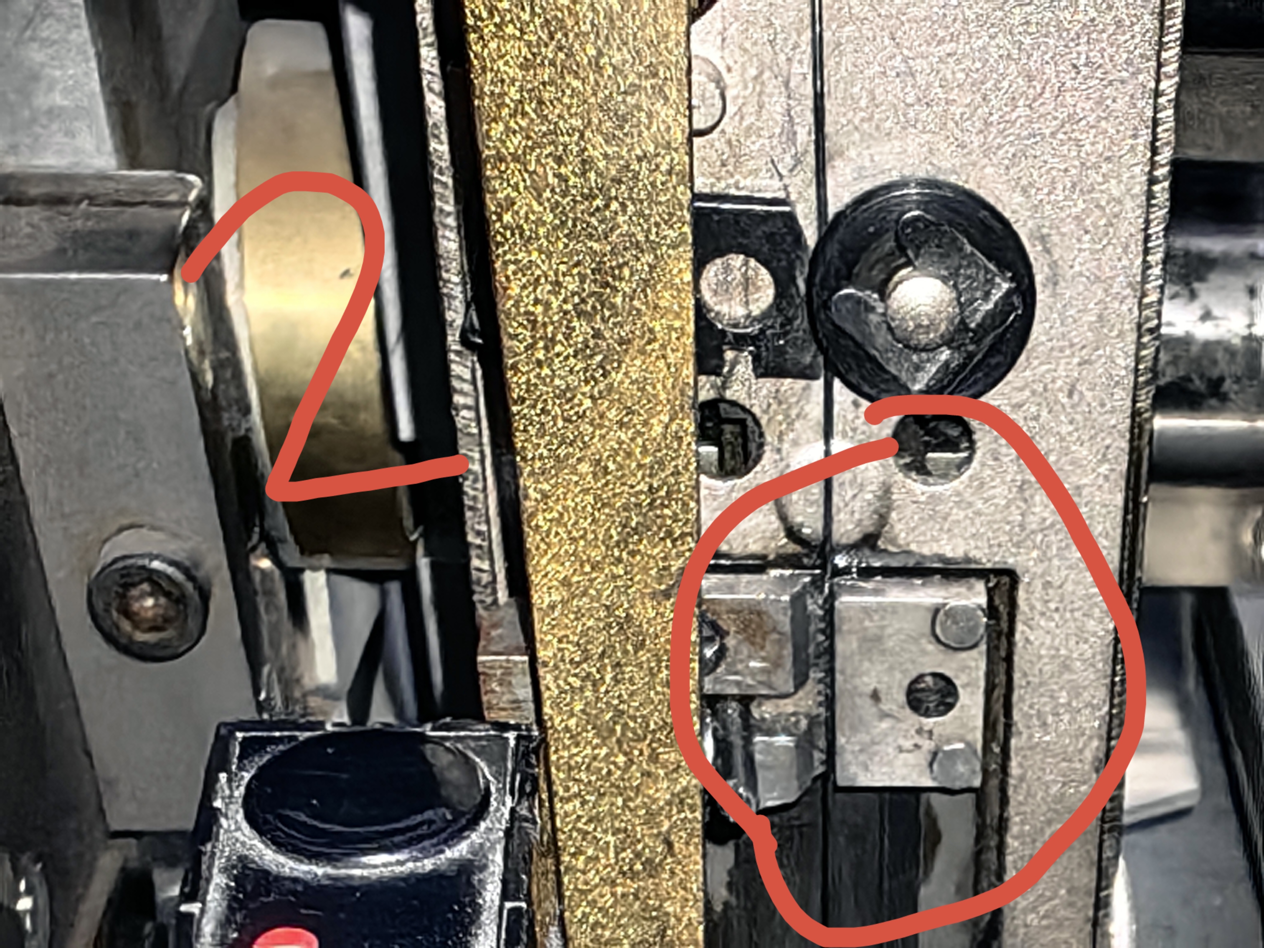

BUT if I just move shaft by hand only 1-2 milimeters upward than stitching head looks like on photo 2 and wire is fine squeezed. After wire is ok like photo 2 than new brochure will be fine and machine works perfect...
I have attached video of moving shaft by hand and also video in which we can see wire before moving shaft and after moving shaft.
What to do now, what do you think is a problem!?? My shaft is going up-down few milimeters Obviously like seen in video. Do I need to service shaft mechanism or better to turn and see what is happening with stitching head... I have not so much experience with this.

Never had a machine with 2 different heads. 500 always had hohner.. That area is the wire grip unit. When the internal guts of the head get pulled upwards during the cycle return that grip should close in most cases. If not above that area there is a Allen bolt head in the face plate. Crack it loose and tap the upper corner of the face plate down a bit. The face plate should be even or a bit above the actual frame of the stitcher head. Tighten Allen bolt and try. If the head didn't complete a cycle 100% on the next one it would raise up that little bit then go down for the normal cycle.
