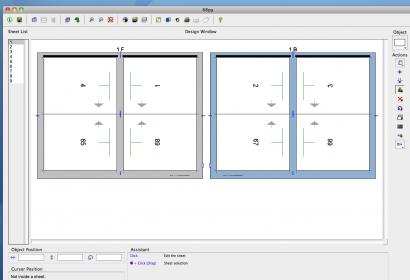

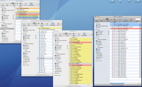

That's a pretty intense question to ask. With our imposition software called DynaStrip we have been able to compile hundreds of templates over the years for many different sheet sizes and configurations and folds. Each folder has sub folders with book folders or flat sheet with W&T or S/W forms or Tumble sheets. In the (8.5x11 8pg on 19x25" sheet) folder layouts from 2up w&t up to 104pg layouts. We do this so each layout will be the same each time 1 of 5 prepress operators pick up a template. The preflight department will set up the links and pages in Nexus manager and then bring the links into the DynaStrip layout. With in 5 minutes the proofs are running out for the customer. So as long as the customer has sent in the files ready and right the turn around time on that type of book 104pg Spinjet and color proofs 2.5 to 3 hours.
Whenever a new layout is needed we will get the sheet size and come up with a fold and have the bindery supervisor look it over and go from there. And I agree with (giant1958) I started in 1970 with film and us old timers can put a layout together in our sleep.
I have posted photos of our work templates.
