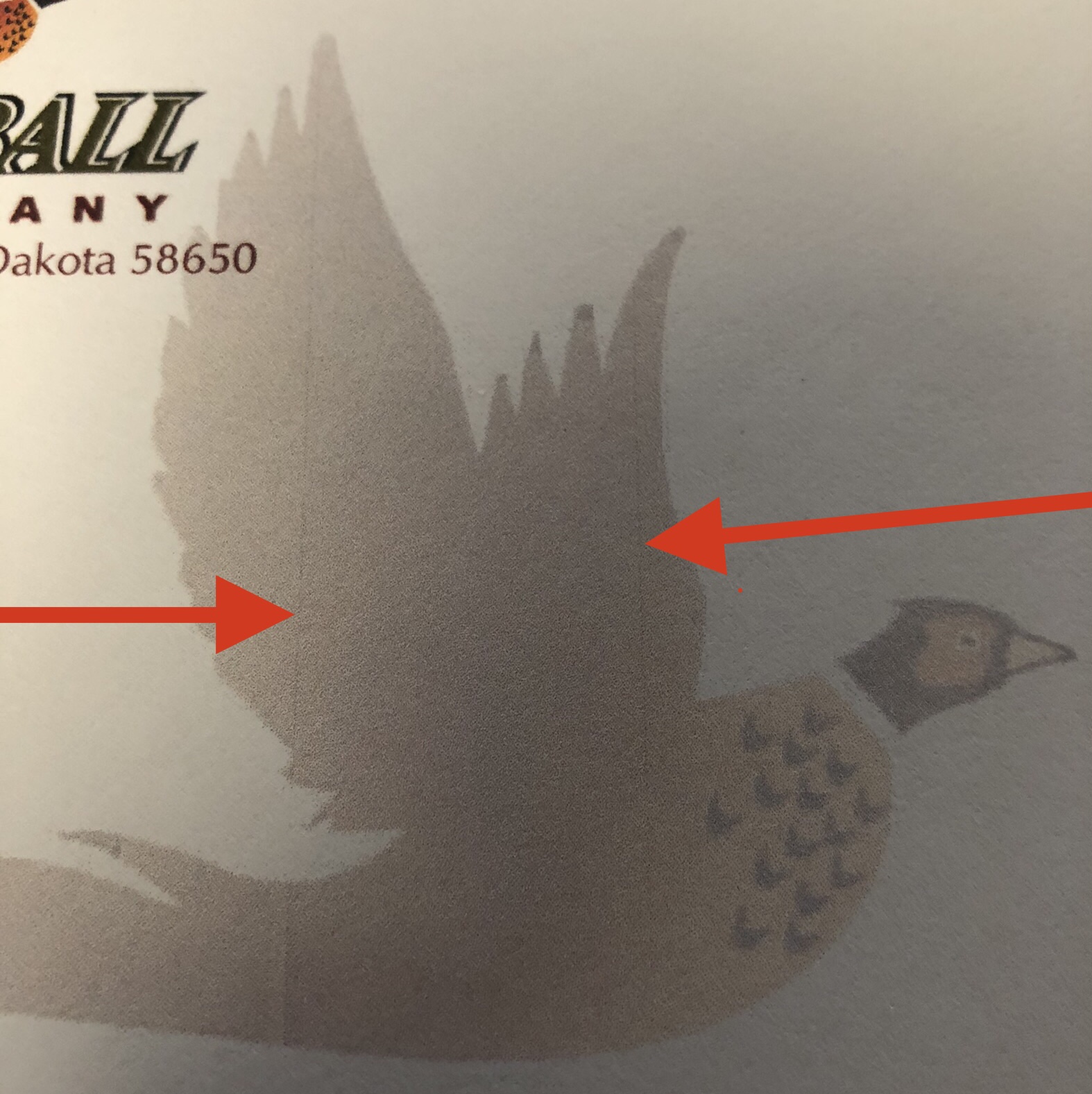

Thank you to everyone who gave input on this! We are actually looking to bite the bullet and go with the iJet 1175P. We printed using two Xante Impressia systems for years and really liked the output color, but it was slow and we now have a hard time sourcing digital window envelopes. They can take 6-8 months to arrive. This was our main reason for going inkjet.
So far I like everything about the 1175, but when looking at samples my only concern is seeing some lines in the print. Is this easy enough to resolve?
With our Riso, lines in the print meant one of two things. Either a spec of dust was on a printhead and it needed cleaned, or it was scratched and needed replaced.
Is the iJet 1175 line similar in that folks have dealt with printhead scratching causing lines in the print?

Simple adjustment. On your rip there is a little gear icon on the right side. Click that and a screen will pop up. I believe the tab is HP Advanced (second tab). On that screen at the bottom right there is an adjustment for Die Gap. Increase it if you have dark lines and decrease it for light lines. A little goes a long way so I usually do 1 at a time. Once to adjust click set to the left. You'll get a command screen that will pop up and go away. Once it is gone X out and print to see if it worked.
