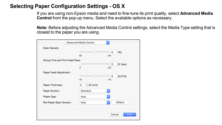

You may need to alter the paper feed adjustment

I know in Onyx you can add a compensation factor to allow for this kind of problem.
You print a line then enter the measured length then it adjusts every print afterwards.
schenkadere
Like Bly said...if you're using a RIP to bybass the Epson driver, there will be a paper adjustment control in there somewhere.
