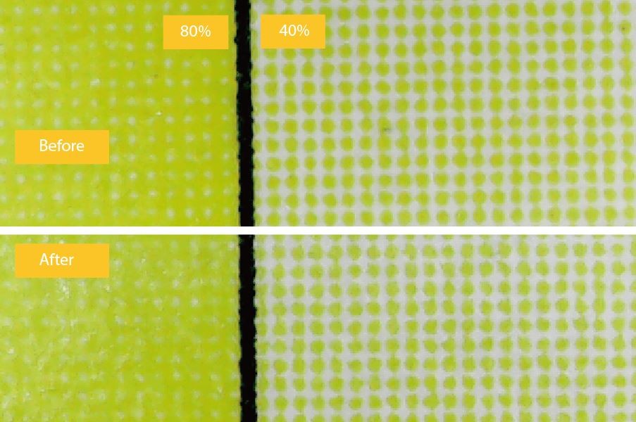

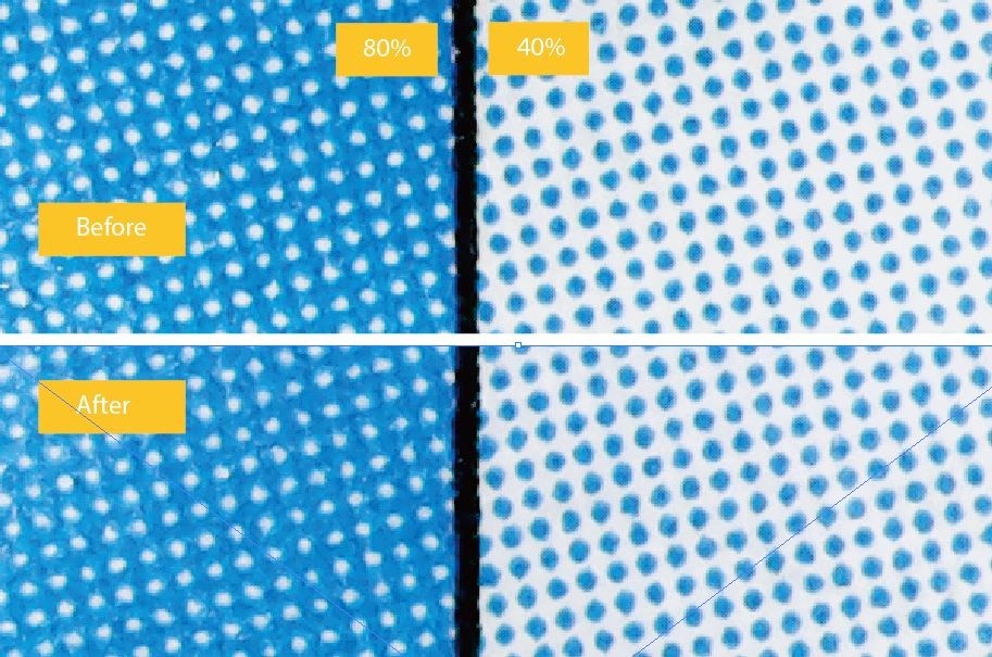

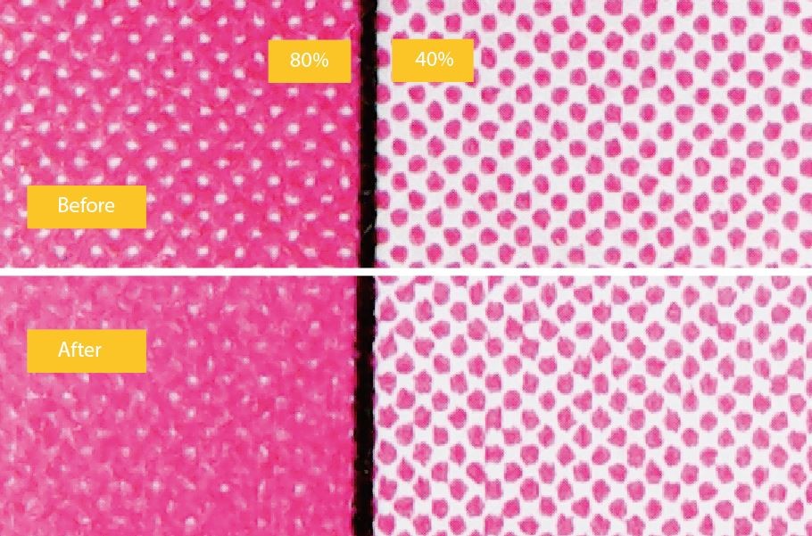

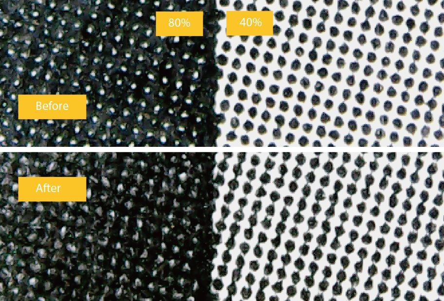

Dear Experts,
Please find in the attached pictures which I took the 40% and 80% dot area in the printed sheet.
The above picture is the reference that we had printed last month. The below picture is the printout today.
You can see the difference in the black and magenta color. The dotgain of black and magenta in the printout are higher than in the reference.
The cyan and yellow looks good.
Therefore the printing image looks very dark and more magenta than the reference.
We always control the printing plate, and the dot area of the printing plate is in our tolerance (1%).
I had checked blankets, thickness of blanket packing sheets, pH and % alcohol of dampening solution, used as little amount of dampening solution as possible.
This job is printed on the same machine, same ink, same dampening solution, same paper, same color sequence; I had checked and confirmed that no slurring or doubling in this machine.
I had washed the ink rollers carefully, used the original ink from the package and pre-inking again.
But I still can not fixed this!
Anyone has idea please give a advice! I am very appreciated!
Thanks in advanced!

to me it looks like your black and magenta inks are over emulsified in the second run

Looks to me like you've got some distortion of the magenta dot. Also looks as if the densities of the magenta vary from the first printing to the current printing. As mentioned you need to compare SIDs from the first printing to the current printing. When doing this allow for app. 5 densitometer points difference to account for dry back. You also mention the same ink in your checklist. When you say the same ink, can we assume that on both printings the ink was loaded into the fountain from a fresh sealed can? I know its painful to dump the seemingly fine ink, left in the fountain at the end of a day, but if your goal is truly repeatable press results you need to eliminate this variable.

A first fundamental MUST DO -- GO and LOOK ............ A good indication of Ink/Water Balance is a "thin scum line" unbroken 1- 2 mm wide that forms
on the bend at the grip edge of the plate and extends the width of the plate.
Now, questions: a) the same plates were used for both print runs? b) were the plates "Gummed Up" between printings?
IMHO -- The Black 40% H/tone, show a sign of "low dampening level" -- look between the dots and theyshow "Ink Whiskers/Grains Forming" joining up the dots.
Magenta looks emulsified, 40% dots "Snow - flaky"
