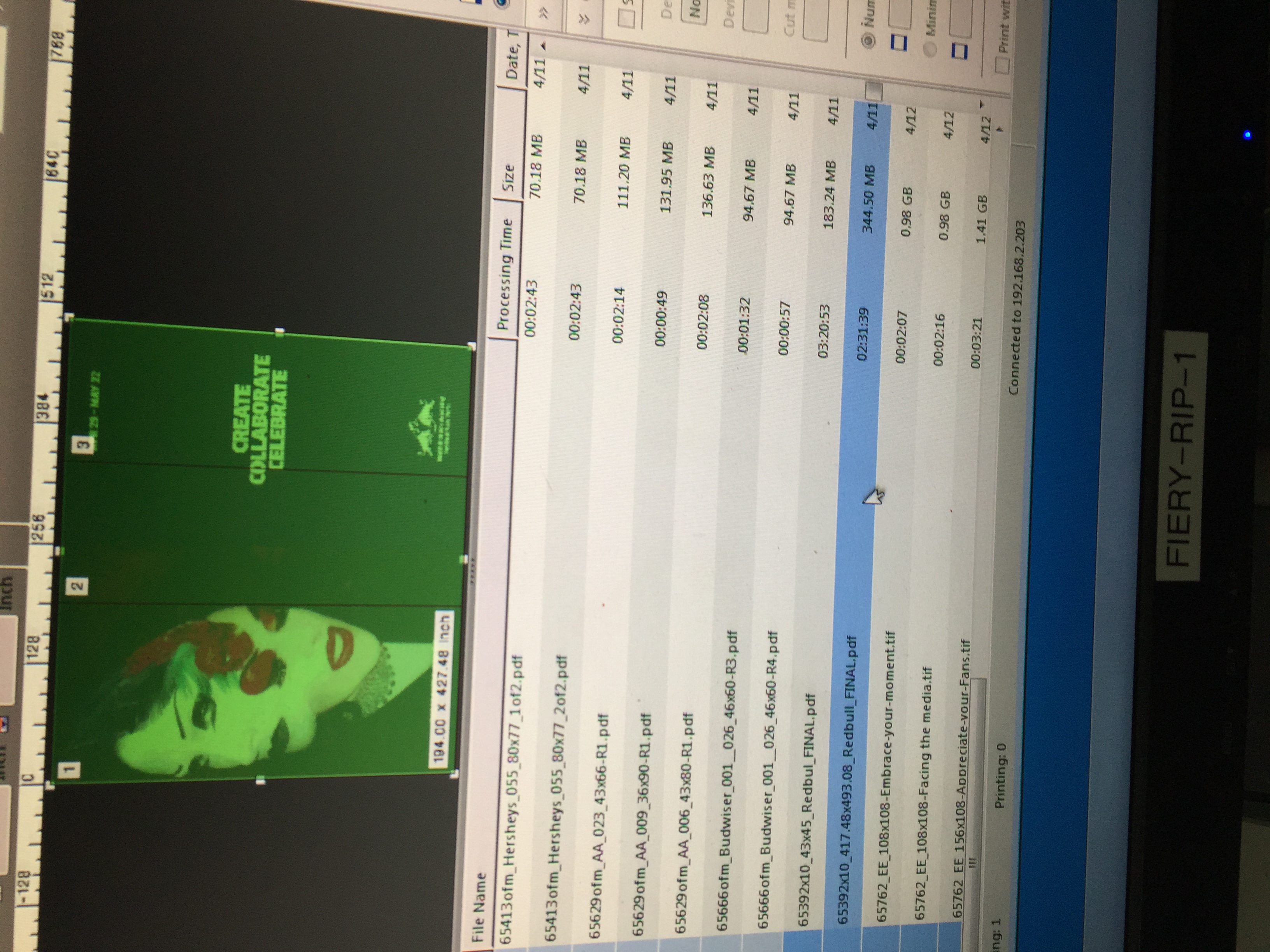

Yes , i Mean flattened pdfs saved as acrobat 1.5 files from INDD. (just a step to prevent issues) I need to find out if its running APPE or a PSL3 workflow? really we have 20x60foot boards that take 3 hours to rRIP
Since i am not actually running the rip.. where in the settings to i find that preference. We do have a "ghost" station in prepress..
