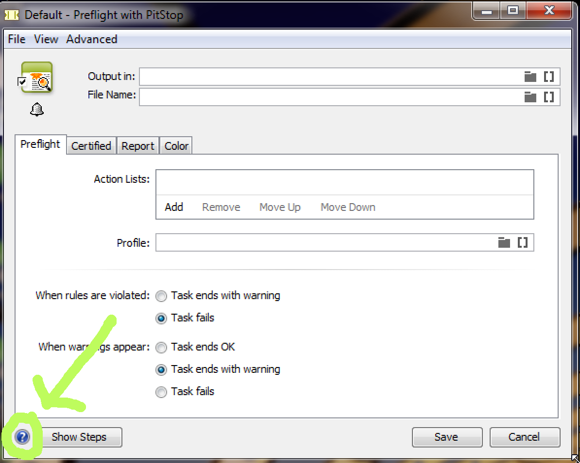

Finding information on how to setup Esko Automation Engine workflow Tickets
PDL
To find out how to use and setup Esko Automation workflow tickets one way is to click on the blue question mark icon in the lower left of each ticket. That will take you to the online AE manual and the information about that specific ticket. See the screenshot attached.
